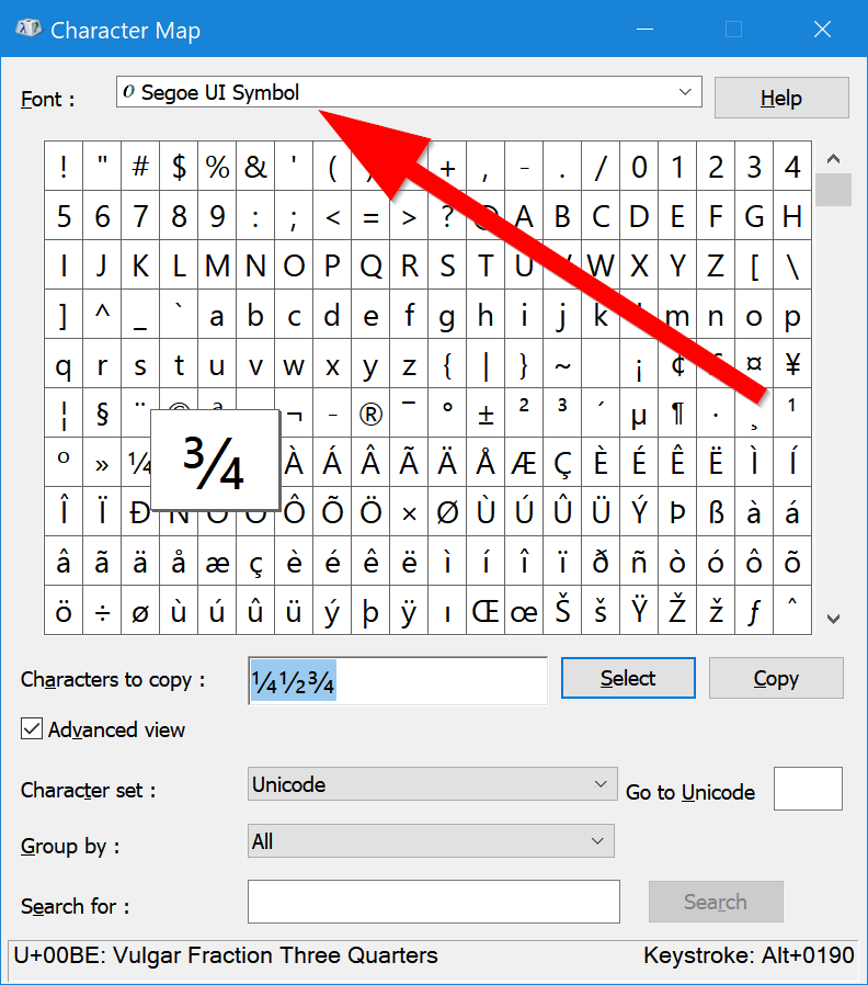

The straight answer; no, there is no simple keystroke method to insert subscript and superscript characters in the slicer.

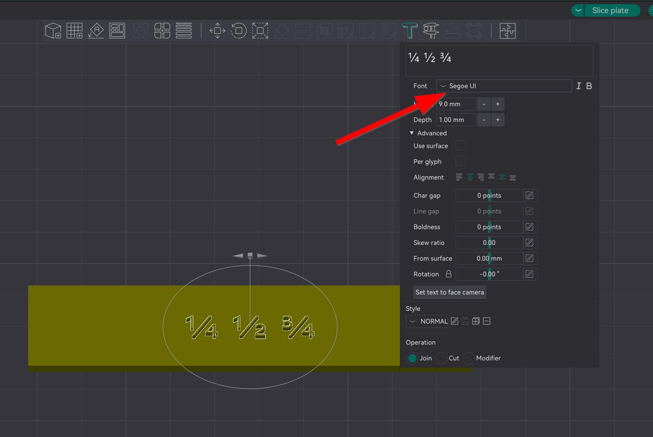

However, depending on the symbol set/font family you are using, 1/4, 1/2 and 3/4 are part of many symbol sets. You access them via the charmap app in Windows.
Make sure you are selecting the same font before you do.

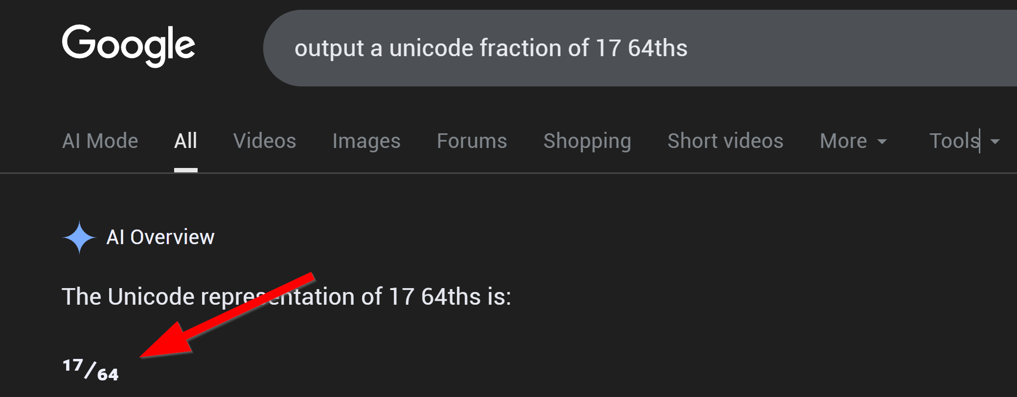

Of course Google will probably do that for you and you can copy and paste from there.
Here is an example of a Google search that illustrates how to do that. It of course also will find sites that will format it for you too.
The first solution worked for me - thank you so much for the quick reply!
Extra tip: on Windows one can hit WIN + . (period) in any app/program to bring up an inline popup where emojis, ASCII art, and lots of special characters can be selected directly (including the fraction glyphs).
Also the Windows Store “Character Map UWP” is a nice upgrade from the old version.
