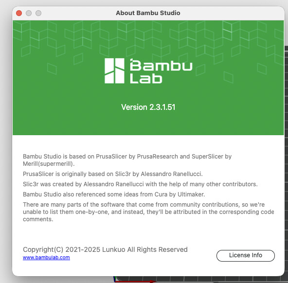

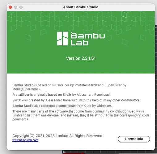

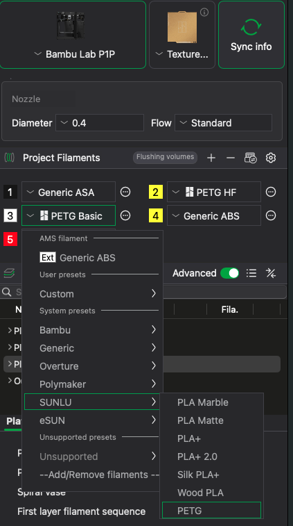

I have a problem with BambuLabs Studio (running on Mac), version 2.3.1.51
I can see on the GitHub that this build contains additional vendors in the filament profiles folder. I can see those when I open the package - the actual JSON files for the filament profiles are present within the app itself.

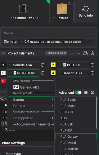

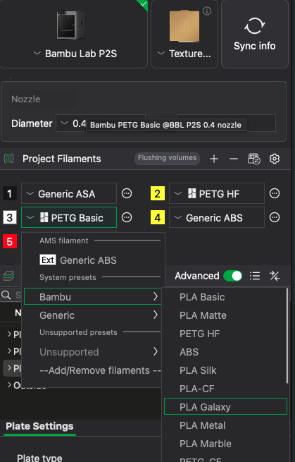

However, when I try to add new filament to my app, I can only select Bambu or Generic as vendor. Other manufacturers are simply not listed:

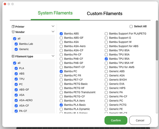

Vendor list is missing Sunlu profiles, which I confirm as existing inside the app package - there are 62 filament profile files inside the app:
I’ve searched the forum, but I cannot see any recent posts regarding this - the latest post I found is from November last year, so not really applicable to my problem.
Anyone knows why is that? Is this expected behaviour? Is this a bug in the app? Or is this a random setting I modified and broke it?
Any advice will be greatly appreciated, this is doing my head in… I’m using filaments from Sunly nearly exclusively… I’d much rather find a way to load the profiles from the repository already in place, then to recreate them myself by hand :smiley:

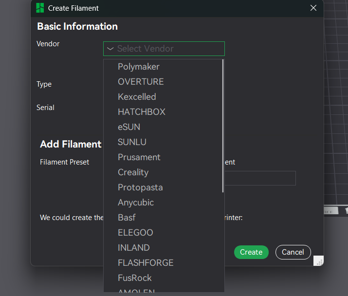

This has been answered once by @lkraus they are in custom filaments
Creating custom filaments in Bambu Studio | Bambu Lab Wiki
Thank you kindly!
Somehow I managed to miss that post… :sweat_smile:
I can see them now, thank you again for your help!
So you need to go through and create custom filaments for each vendor now. I had all the filaments available before with my P1S.
So i’ve checked by adding my old P1S back into Bambu Studio. More filaments are available for the P1S than for the H2 and P2. Wondering if they just aren’t certified or tested yet. If you switch back and forth the settings are available for the older printers, just not the newer ones.
It’s not the same. There are just names for those vendors, no actual profiles.
New to 3D printing but have come across this issue of Sunlu missing as a System Filament and only being available by adding it as a Custom Filament. I have no idea what settings to choose if I were to add it as a Custom Filament, so I’d like to wait until they load a profile as a System Filament. I hope to get notification from a post here when that happens. Glad someone made a post about this. I also was having trouble figuring this out.
This is not solved. All the filaments have their files within the Bambu Studio install folder, and yet they don’t come up as System Filament vendors.
I shouldn’t have to go through and create a custom filament for a profile that already exists.
To anyone else who finds this post and is using a newer printer - the issue isn’t resolved and isn’t going to be. I have communicated with their support team about it.
”Dear Bambu Lab 3D printer user,
Thank you for contacting Bambu Lab support.
As a new model, the filament parameters for the P2S are highly dependent on the machine’s specific characteristics, which means parameters from previous models cannot be directly reused. Therefore, by default, there are no built-in third-party filament profiles; only Bambu official and Generic filament profiles are provided. You can create custom filament profiles to meet your needs.
