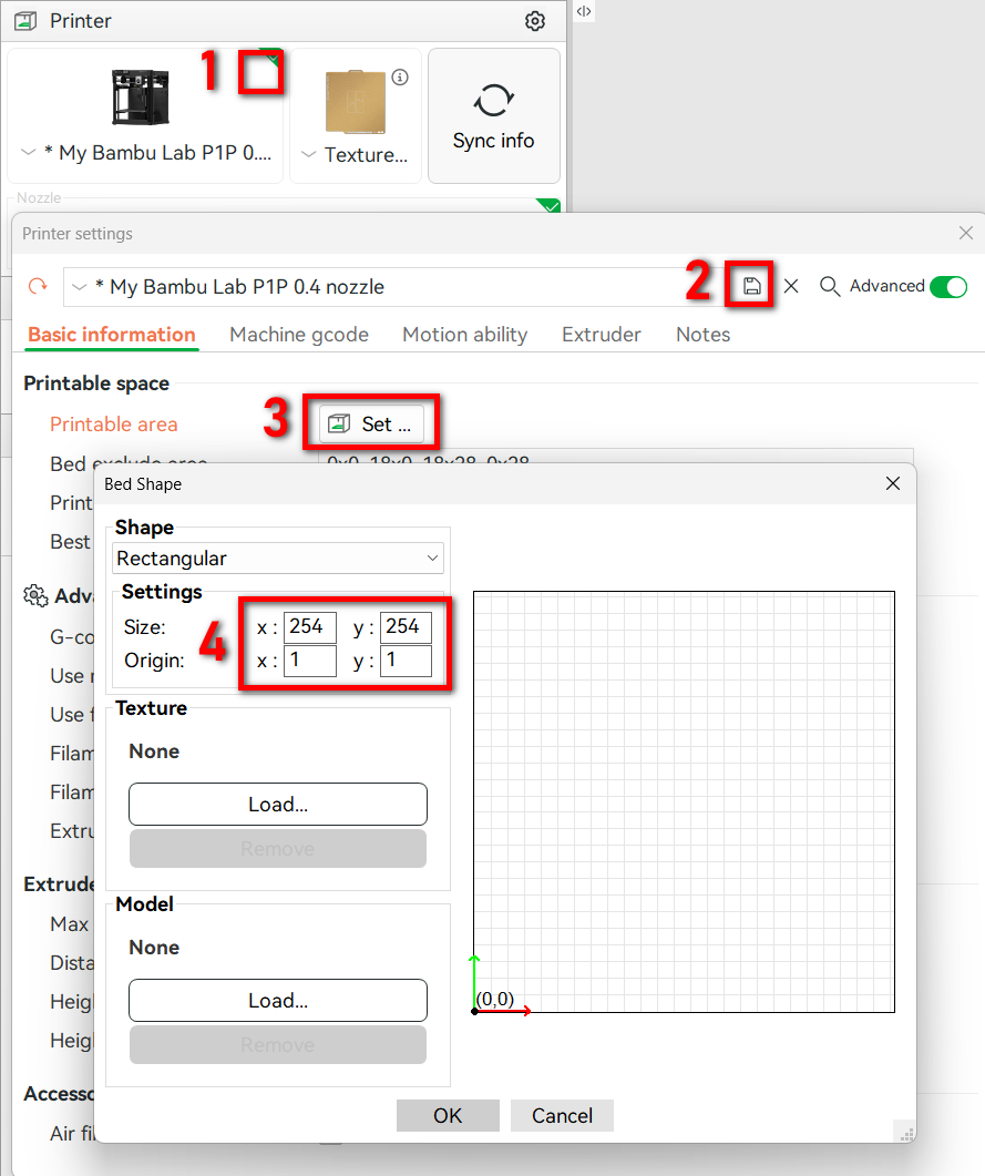

I have not tested this out but the settings are buried in a little-used area.
  1. Click on the printer settings Icon
  2. Then in Printer Settings click on printable area
Then from there you’ll have access to the bed shape and size.
Good Luck
That is where I looked before but mine does not show the “Printable area” selection for any printer I change to.
Ender 3 profile

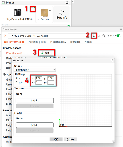

Here is the P1P to compare to your image also.
Even if I search the settings, these are the only results.
Hopefully it isnt something simple I am over looking, that would be embarrassing. Also I seen from your picture that there is a dark mode so thank you for that :slight_smile:
