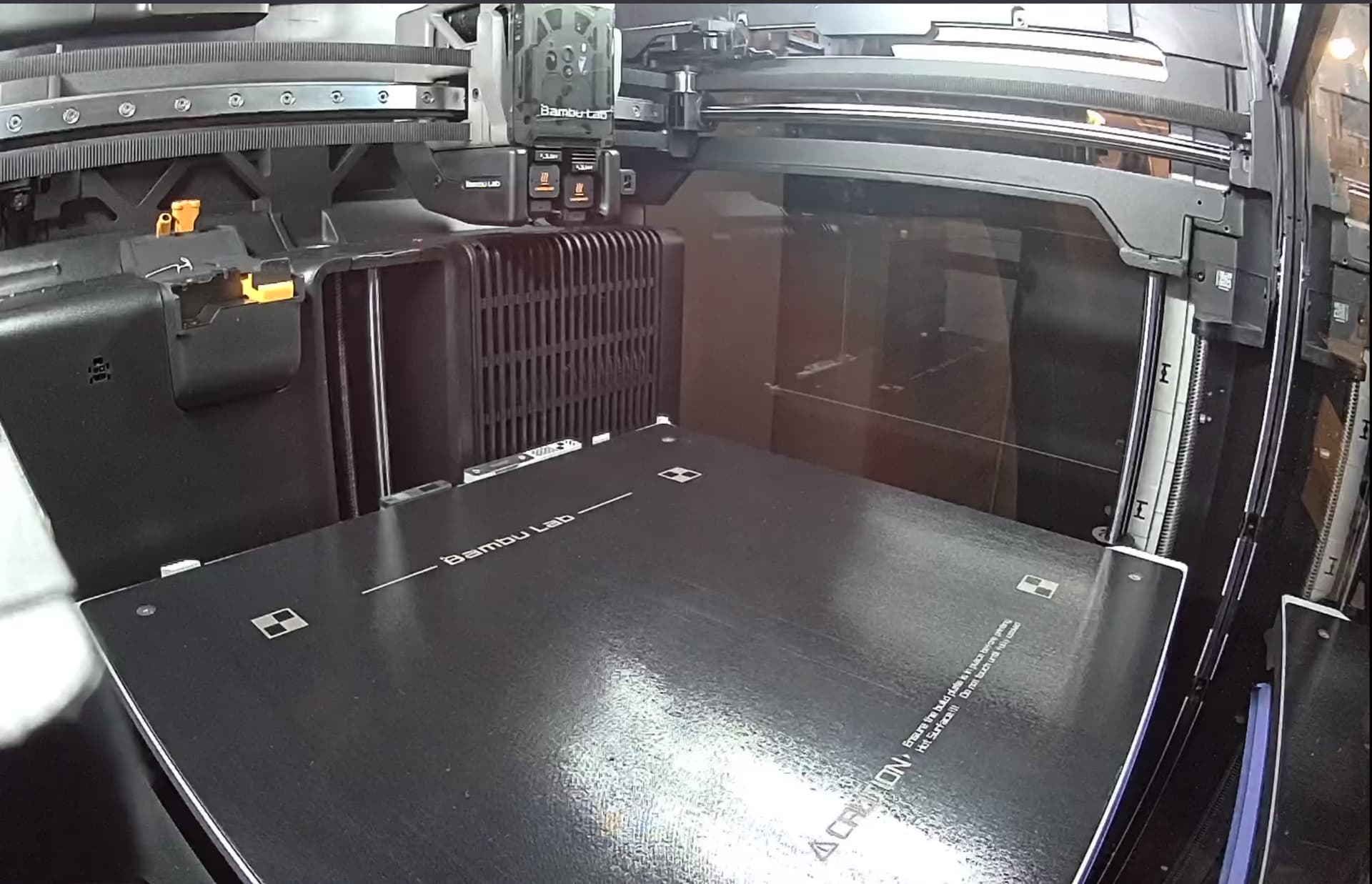

Is it possible to adjust the camera focus on the Bambu Lab H2D? In my case, the focus is set so that only the front-left corner of the print bed is sharp, while the center remains out of focus.

I’m sorry this isn’t an answer to your question, but your bed placement looks odd to me. I see a growing gap from the back to the front. Do you have it on correctly or is it just a trick of the camera angle?

Mine is not nearly as bad but it is definitely more focused towards the foreground than the middle.
The print bed surface is indeed slightly crooked, but I can’t fix it because it rests against the guides at the back of the bed and is locked in that position.
As you can see, roughly the first 5cm of the surface are in focus, and then it becomes noticeably blurry.
Generally on those cameras, you turn the lens in or out to focus and it’s generally then glued in place. I think your camera was not set properly from production. Ask support for a replacement and when you get it you can try to readjust the old one to have a good spare. I don’t think support will instruct you to remove the camera and re-adjust the lens by yourself.

Here is mine, yours is definitely out of focus
I tried running the camera calibration several times, but it didn’t affect the focus at all. I’ve had to contact customer support—let’s see what they say.
@Gnevko Please do update us because I am interested to know how it goes with support and whether it is actually possible to adjust… mine isn’t nearly as out of focus as yours but it is definitely not as clear as @philch on his the front right QR code is nearly legible while mine is just a blurred square.

The H2D Live View Camera has a fixed focal point, and cannot be adjusted manually or automatically.
If there are concerns about the focus, please open a ticket and our team will look into it and provide a solution if a problem is found.

Support told me they will send a new camera module. They responded politely and fairly quickly.
The new camera is installed.
Wow! That focus is better than mine. I want a new camera.
