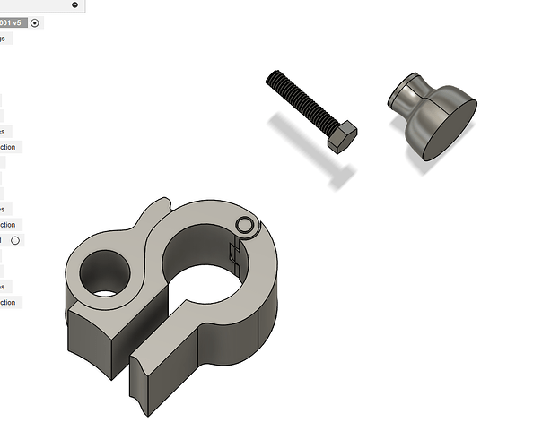

Hi,
I am printing a collar clamp (pics below). The collar clamps onto a 1" metal pole - a microphone stand. I am using a (supposed) print in place hinge because I cannot slide the collar clamp onto the pole (there is stuff welded onto the top/bottom of the mic stand).
A few questions:

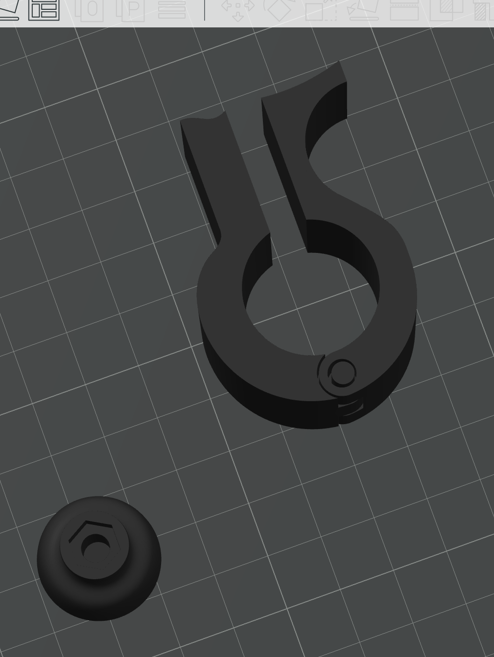

  1. I’m using Fusion 360 for the design tool; is there anything in the design layer to help or make it so that as I export the 3MF file… the left and right parts of the collar clamp, the hinge parts are aligned?
  2. The clamp is supporting a light weight, say less than 2 pounds… I was wondering what’s the best filament to grip the metal pole? What about having a TPU insert into or on the inside of the collar? or is that way overkill?
Any other collar clamp advice?
Thanks
AJ

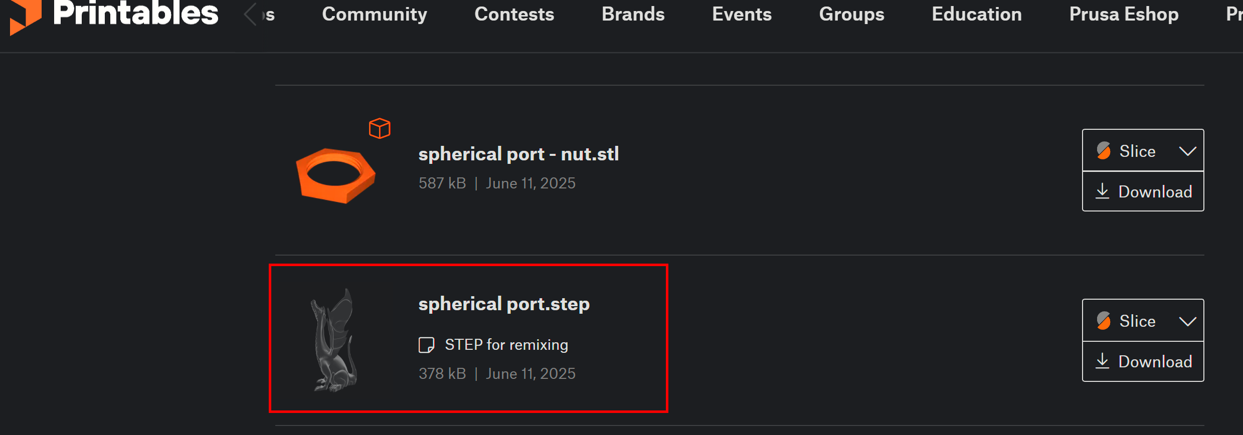

Here’s an example of what I mean using a model made by YouTuber Teaching Tech. The model is for spherical port for a dry box. It’s a brilliant design that you can find here.
Navigate to his video linked on that page for a full tutorial on 3D CAD to 3D printing. He has others but what is nice about this is that it shows you how to use tolerances and assemblies and then export them to an assembly as separate objects. Although he uses OnShape, the principle is the same for all parametric CAD programs such as Fusion360, CATIA, FreeCAD, SolidWorks etc.
So if you import this STEP file as an example, you get full precision.
It looks like this in the slicer(Note, the colors are fake, I don’t own an AMS, it’s just there for illustration purposes):

Thank you so much for the links and advice. It turns out, that in Fusion 360 if you combine both parts of the collar clamp into one component, you can export it as a single 3MF…then Bambu labs brings it in perfectly aligned, so that there’s nothing extra to do.
I did this, printed it and the hinge WORKED!!!
