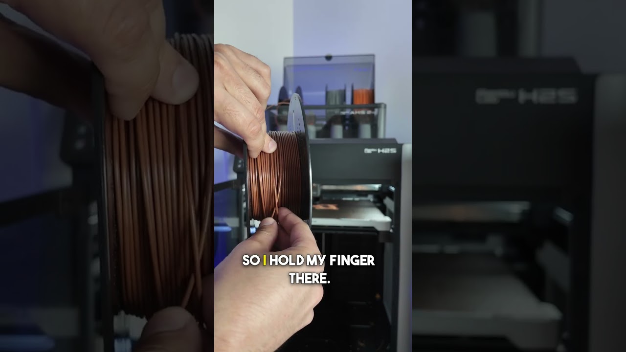

While a print is paused, let me unload/retract the active filament from the extruder via the printer screen, Handy, or Studio, then reload and resume.
Why: several spool tangles on my X2D. When AMS detects the tangle it cuts, retracts, and Retry works. When it classifies the stop as runout or “busy”, filament stays clamped in the extruder and Unload is unavailable. Only options: shake the spool until slack appears, or cancel and waste hours plus material.
Proposal: every pause state exposes Unload for the loaded slot; then Load + “Resume (problem solved)” continues, same as the existing tangle-recovery flow.

You can also refill the filament when it runs out or gets tangled. But you don’t need to unload the filament when it runs out. The nozzle will empty itself. Then load the new filament, and you can continue printing. Here’s how it works:
If your filament gets tangled, just cut it, click “Continue Printing”, let the nozzle run empty automatically, and load the filament again. It wouldn’t make sense if the filament ran out and you couldn’t refill it.
I would start by trying to work out why your spools are getting tangled. That’s not normal. There are many possible reasons for it.
