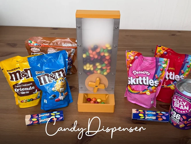

And yet, every single model I have in design for CyberBrick, vehicles, remotes and more all use a 2.5mm hole.
I have done the same thing all the way up to M5 screws/bolts.
While you are guessing, I am showing real world examples each of which utilise the advice based on actual real world testing and design.
The same goes for my other models that use normal screws, just a couple of examples:
  • Squirrel Feeder Adirondack Wooden Chair M3
  • Candy Dispenser (Sweets^) M#
