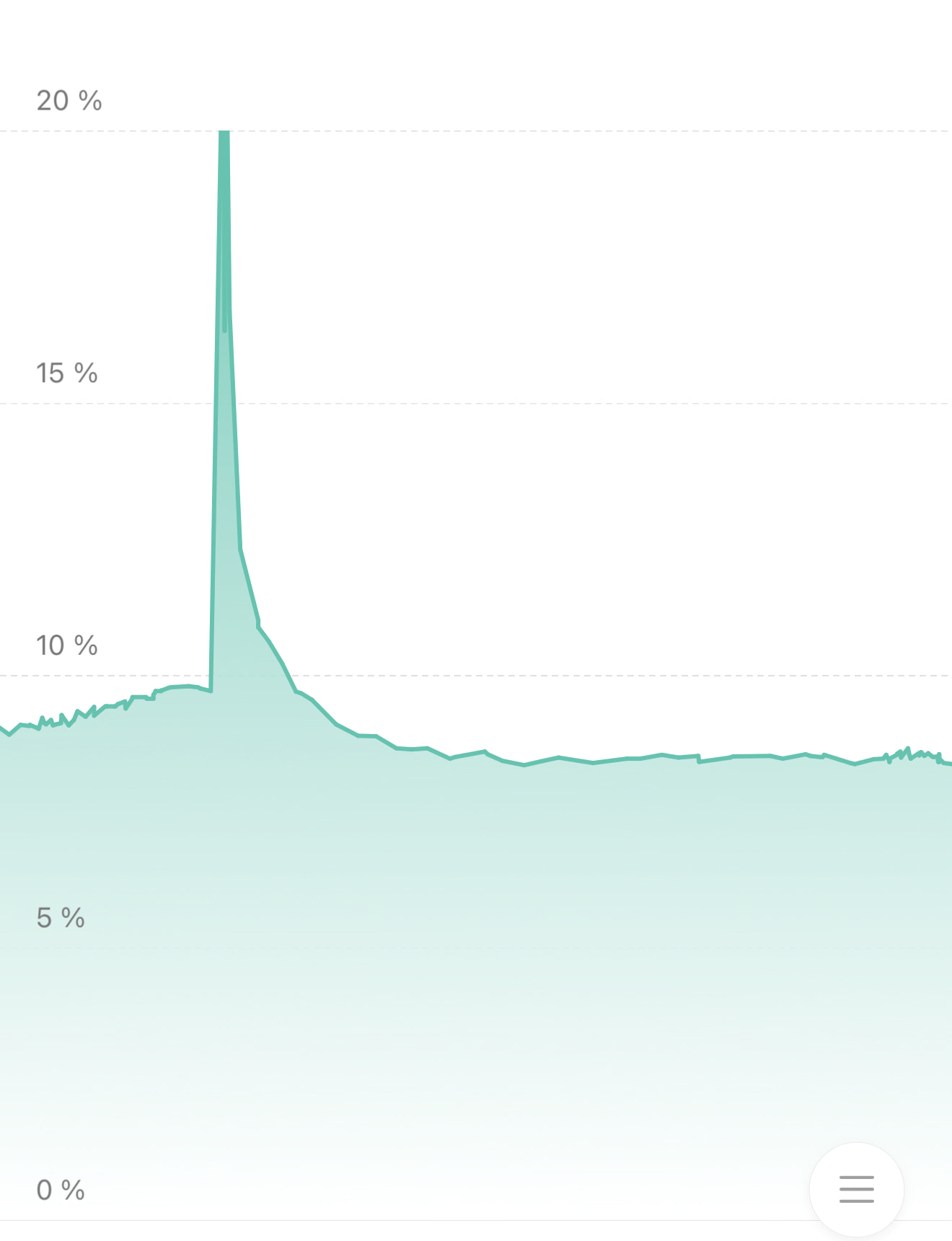

That said, it’s possible to keep the humidity down around 10-15% if you want to babysit the desiccant on a very frequent basis. My AMS is presently at 13% and 44C. Assuming no additional moisture is added and my poor napkin math is right, as it cools down this should equate to 45% RH at 22C. I assume because it’s pulled more moisture out of the rolls and it’s just still in the AMS.
Indicates to me that this desiccant is at or near saturation and isn’t doing squat, which is what I want right now for testing purposes.

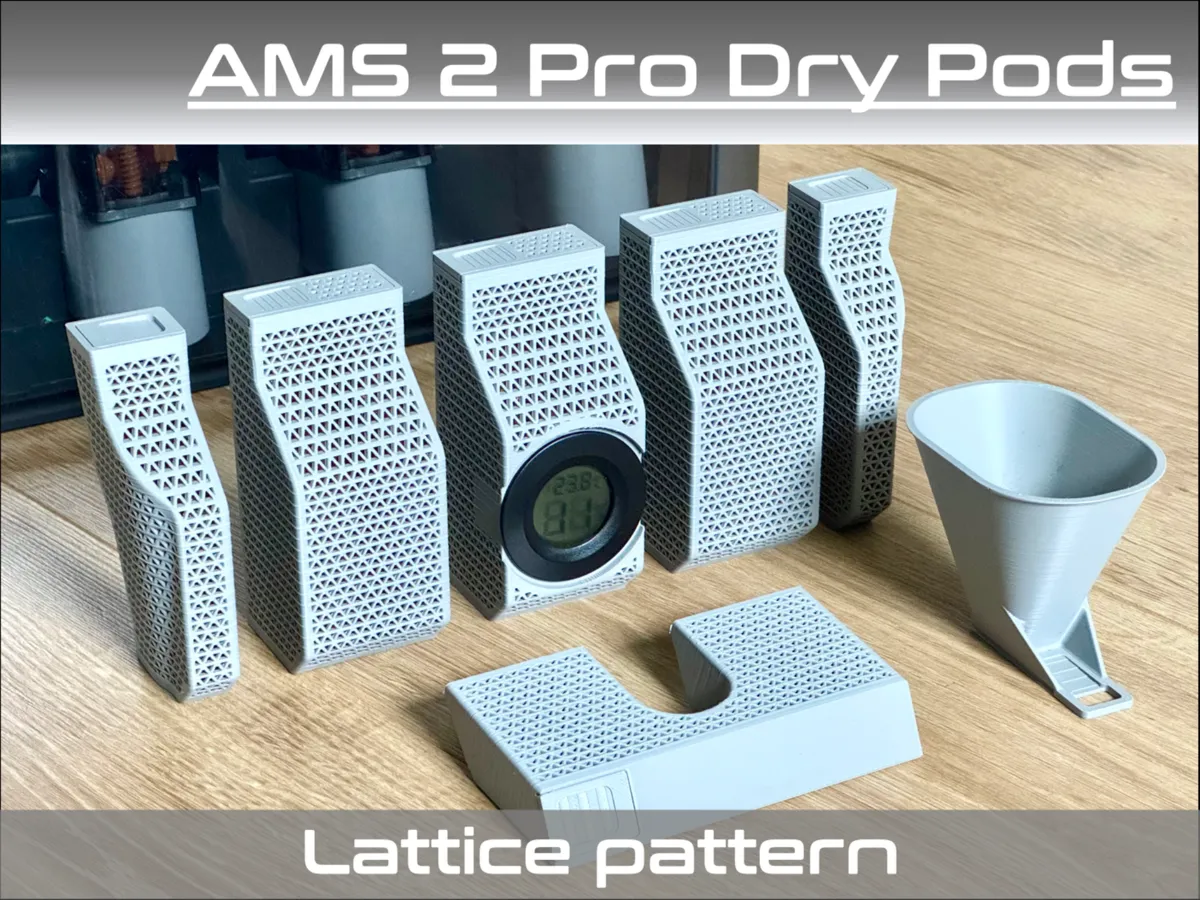

My 2 Pros usually sit around 5 to 10 percent RH.
The best way to keep it down is to use an absolute s*** ton of desiccant.
These have been my favorite dry pods…
They hold about 500 grams of desiccant, compared to your bags that is probably 200 or so grams total.
Chasing zero will drive you crazy, but it is possible.
I will change desiccant when I start seeing around 25 percent RH. Best to just get a big tub from amazon.
Your RH environment is not too high, but a small dehumidifier will really help so your AMS is not fighting too hard.
