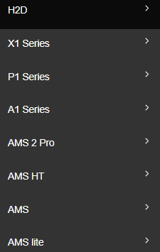

On my store (US) I’m seeing them all grouped properly:
