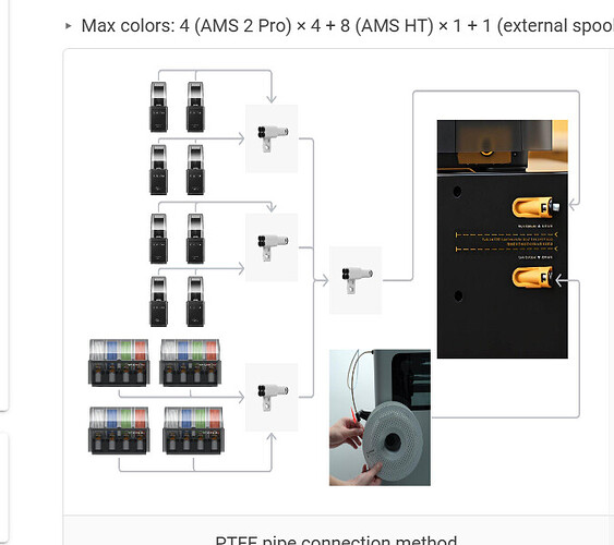

You’re supposed to be able to hook up 25 colors including the external full. I assume tha t the only way to do this is just by using 4 - 1 adapters. Otherwise that would be a heck of a lot of hubs.
So are you still you can put three AMS units to one nozzle without a hub?

That is incorrect. The filament buffers that are usually in the hub are built directly into the H2D, so you can use as many AMS units as you like (up to 4, and 8 AMS HTs) with just a splitter. I dont think the hub would even work if plugged into the H2D as it was not designed to operate with it, and there is no place to mount it either.
Here is a direct quote from Bambu wiki:
This is how you connect them, with 4 into 1 splitters or you can even print one. I used a printed splitter on my P1 and X1 with 8000 hours of problem free operation.
Thank you for the info! I stand corrected. This is great
Yes - I have done exactly that.
