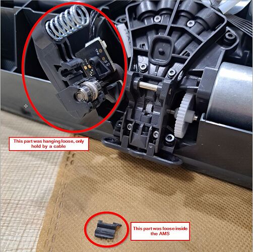

Last Sunday the AMS was suddenly not able to push filament to the print head anymore from any of the 4 slots.
Filament got stuck at random positions, sometimes before the external buffer, sometimes before it reached the P1S, sometimes before it reached the print head. Printing from external spool worked without problems.
Checking the PTFE tubes, the external buffer and the print head, I found no left over broken filament or other blocking damages.
Disassembling the AMS I found that the internal filament hub was broken. Literally broken, as the plastic part of the internal filament hub was broken. A part that hold the extruder wheel hung loose around, just hold by its cable and a small plastic part was on the bottom of the AMS enclosure:
I got a replacement from the local BambuLab certified dealer I bought the combo. They were super fast with their support and I got the replacement within 2 days.

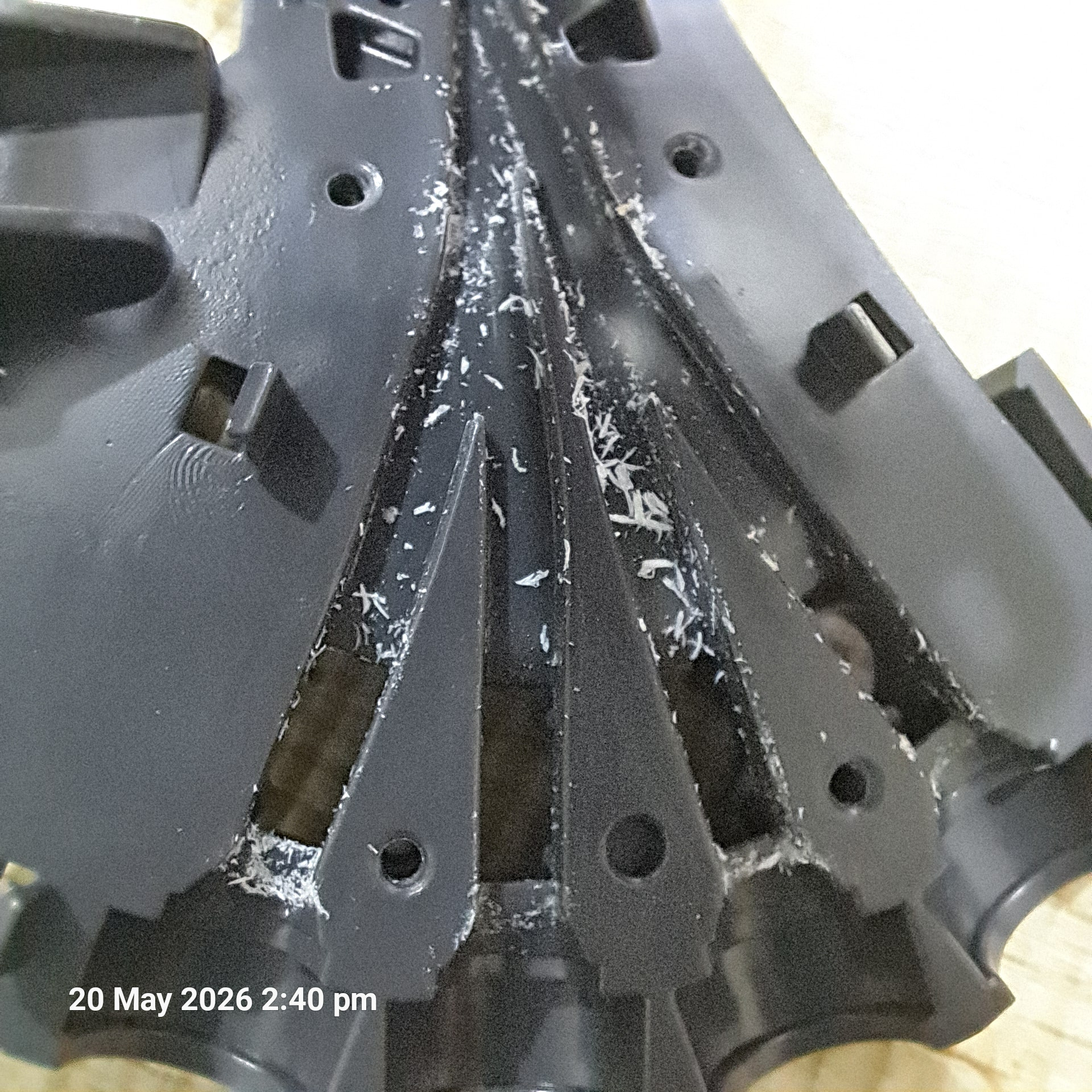

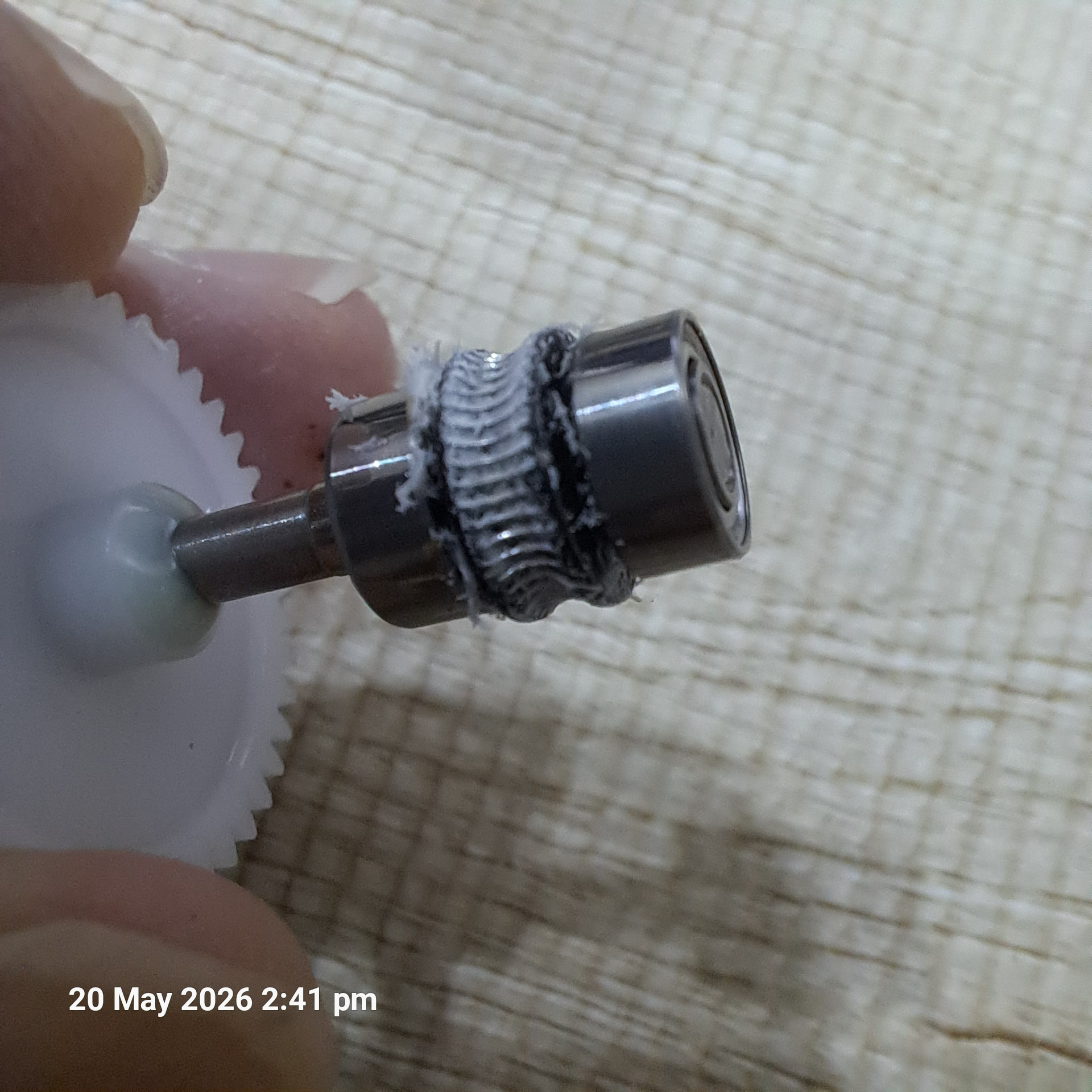

After replacing the internal filament hub and testing (all works again), I disassembled the broken filament hub and was surprised of what I found inside. There is a lot of filament dust inside, including covering the extruder wheels.
I guess all of this created so much friction that the plastic part couldn’t stand the stress anymore.
Anyone has an idea how to keep this internal filament hub clean? Disassembly of the filament hub for cleaning is not possible, it seems to be impossible to re-assemble the plastic parts.
The solution ==> AMS Internal Hub Unit Tension Lever
Not installed yet, but I was able to repair my AMS internal hub. Only manually tested yet, but it seems to work. Will keep it as spare part until the hub breaks again.
im not sure how different the fillament hubs are in the ams and ams 2 pro, but you can take it apart for the ams 2 pro, i did that cause i had feeding issues and decided to check and also found a lot of fillament dust, it was a bit annoying to get to it but i think it would also be possible on the first ams series
I took it apart and had flying around springs and magnets :rofl:
Took me three hands to put back the magnets and springs when I re-assembled the hub.
They seem to trigger the sensors that show from which slot the filament is coming.
well i never said it was easy :rofl:
