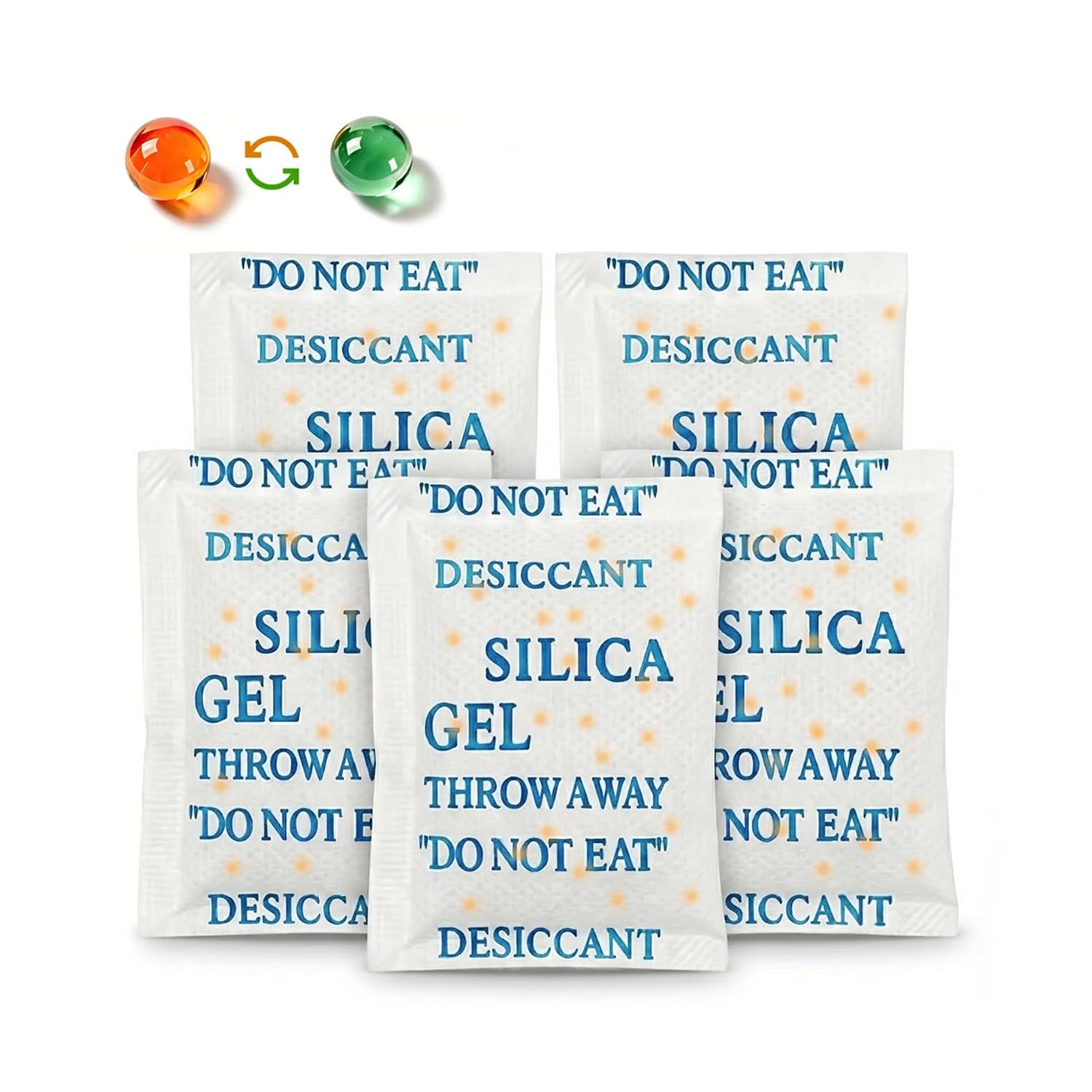

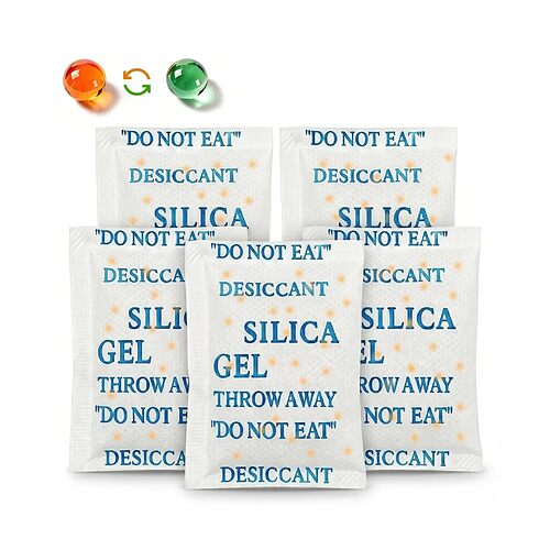

May have missed it up top, during the summer I’ve kept it around 50%, in the winter is was swinging around 20.
I bought this, and i’m using 12x per load in the AMS:
You can regenerate Silica Gel Beads by drying them out in a microwave oven. Use a MW-safe bowl and hit it for 60 seconds at a time. Check the color of the indicator beads, repeat as necessary. Water molecules are boiled away by MW radiation. Be careful, the bowl and beads will be extremely hot. Allow to cool then store or use.
