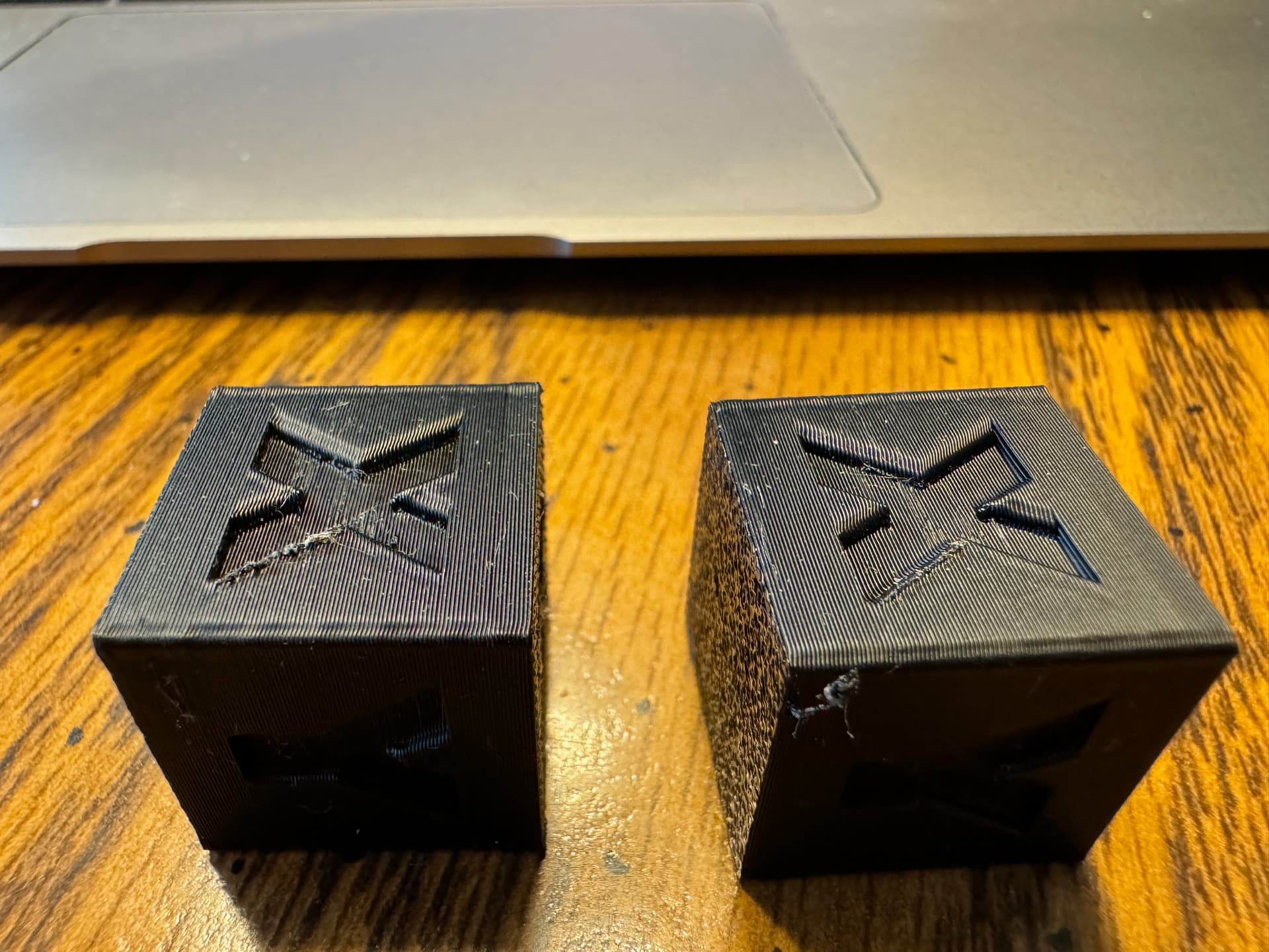

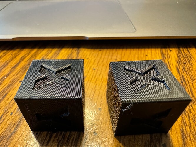

I am using an A1 and AMS light. It looks like Bambu Studio stores the K factor in the AMS, not in the filament profile. It also looks like the AMS light does not see my personalized filaments, only the factory ones.
Bambu Studio now has two built-in filament calibration tools. The Flow Rate fixed many of my printing issues with the Inland PLA I have. The Flow Dynamics is more subtle??
Here are the X side of two CHEP cubes. The left one is before “k” and the right one is after:
I have to look at Orca
