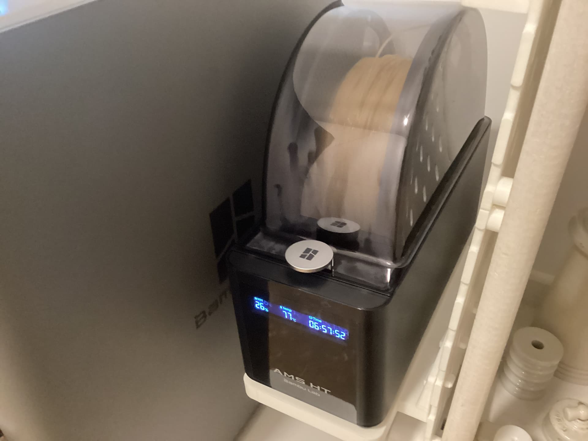

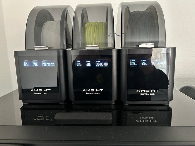

These are 3 of my 4 AMS HT units.
The left and middle units haven’t been opened for some time, but the right one has recently dried Gembird PVA to bone dry.
2-3 hours seems too short for a filament that absorbs water as readily as PVA does. Why did you only dry it for that duration?
Regarding your problem: remove your PVA and replace the desiccants with fresh ones. Run the AMS HT without a spool at maximum temperature for at least 24 hours to dry out the machine. After this, I would recommend checking your desiccants again just to be sure.
Then, place your PVA in the unit and run it as follows:
If your RH sensor is functioning correctly and providing accurate readings: set the temperature to 50-60°C for at least 12 hours (weigh the spool before and after the 12 hours). If it has lost weight, run it for 6 more hours and perform another weight measurement. Repeat this process until there is no further weight loss.
Normally, opened PVA should be dried according to the manufacturer’s recommendations. This is typically at 50-80°C, depending on the specific PVA formulation, for approximately 4-12 hours.
However, it seems unusual that you’re experiencing condensation on the inside of the unit, as PVA becomes sticky as ■■■■ when wet, which you can easily detect by touching the filament.

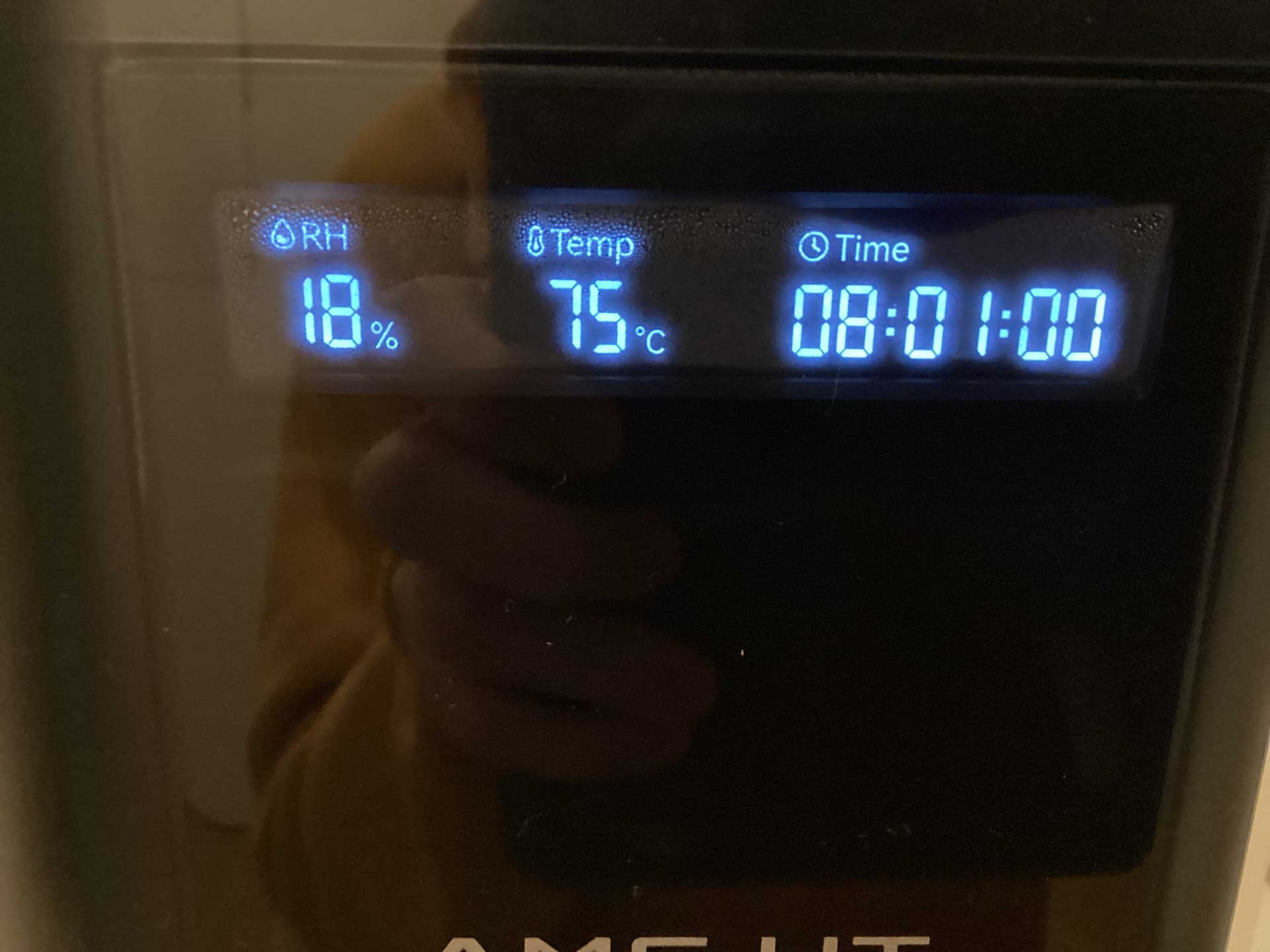

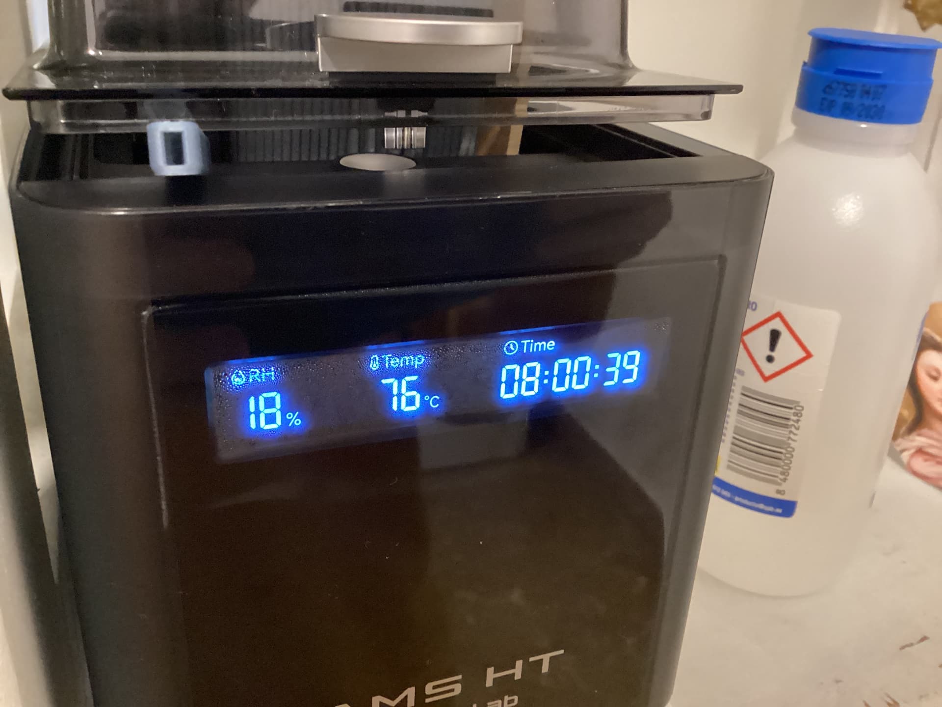

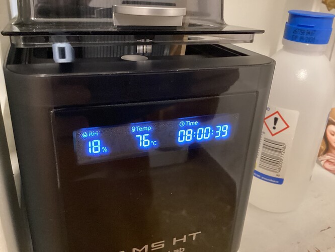

Update: It hasn’t gotten better, it has got worse. I am currently drying PA6Gf and the humidity was 20 and went up to 50. I needed to open it slightly so the air would move and it almost intantly dropped to 18%. Also, there are beads of condensation in the display screen. What to i do?
Did you file a support ticket? Seems clear that the venting isn’t working. Like I said they have a whole support category for broken vents, so I’m guessing it’s fairly common.
Though I guess no-one asked yet… are the round vent holes on the bottom and back free and clear of obstruction? Or packing tape (don’t remember them having any but maybe). There are also the grilles on the inside bottom at front and back which it is supposed to vent through… nothing covering those.
In another thread someone mentioned packing tape that was left on the humidity sensor inside the unit, presumably during assembly, which made the hygro readings be off. Wonder if someone left tape over the vents inside or something… might be worth taking a look. But I’d ask support first.

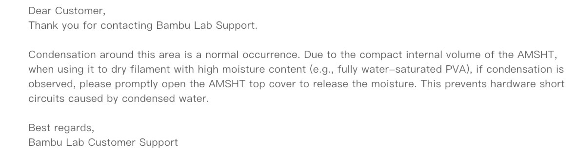

Yes, i asked bbl, but they say it’s normal
Even if after spending 130€ on it I expected it to be more autonomous since it is announced as if it had air intake and exit
I’m sorry to hear that. If you’re doing everything right with that unit then that sounds like some BL BS to me. Earlier here someone posted that BL replaced a vent on their unit. W/out knowing intricacies of both situation, seems like same issue with a stuck valve. And seems obvious this is a problematic part of the unit. :person_shrugging:
