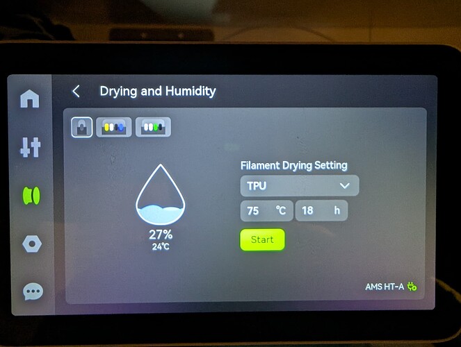

I only want to use the AMS HT to dry / temper the TPU-95a. So, no printing! Why is this not possible according to TDS? The filament spool is only inside the warm (85°C) HT housing.
Why not possible? Can you explain what isn’t working?
I have ordered the AMS HT but still waiting for it. But in the AMS HT Spec sheet below Drying there is no TPU 95 mentioned. Only the TPU for AMS.

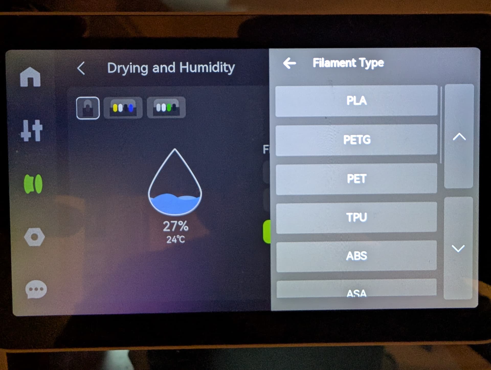

I see, seems like an oversight in the description to me. It certainly can dry all sorts of TPU. All you need is temperature and duration. You could always set them to the recommended values manually.
In the menu, it doesn’t make a difference between different subtypes, its just TPU. Same e.g. there is just one setting for PETG, no PETG basic/HF/CF/…

Note the Ams ht will not read the RF id tag unless it is inserted into the feed mechanism. And you can’t physically feed tpu into the mechanism.
So for drying where you want the spool to rotate, you have to manually input the material for the drying profile or simply enter the desired temp and time.
