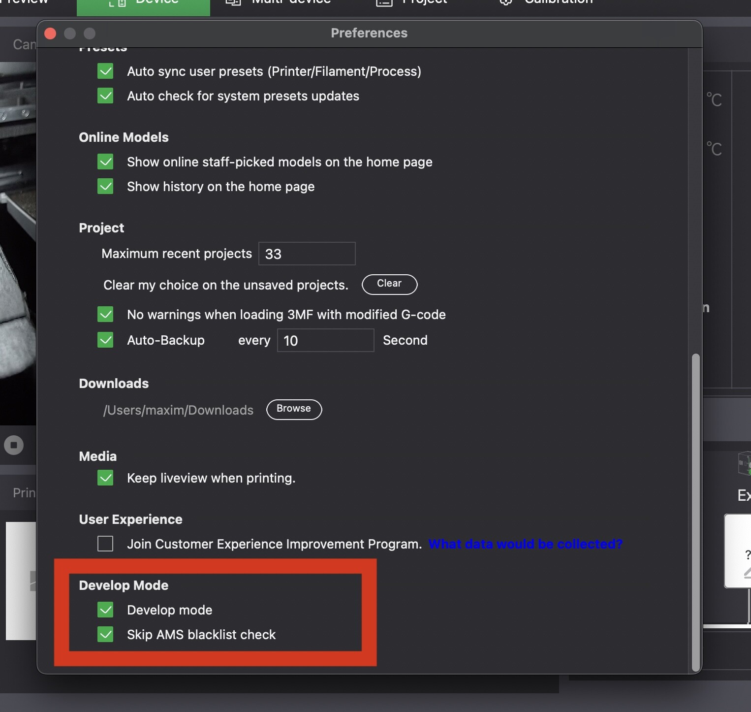

My AMS HT arrived today and I had a chance to test it with PPA and PPS. With a few workarounds I was able to feed both of them from AMS HT regular feed (not the bypass hole) leaving the external spool dedicated for TPU only use like I hoped. Main advantage vs the bypass hole is not having to mess around with PTFE tubes.
If you select Bambu PPA-CF or PPS-CF it will throw an error and say it is not compatible so you have to select Generic PPA/PPS. Also I made the filament path very smooth long arc but it still had a problem loading and got stuck in the PTFE tube on the last turn before the hot end as those filaments are too stiff. What I did is hit “load” before the print, and manually worked the buffer back and forth as it loaded to give it the tiny bit of help it needs.
You also need to checkmark “Skip AMS blacklist check” in Bambu Studio before initiating a print.

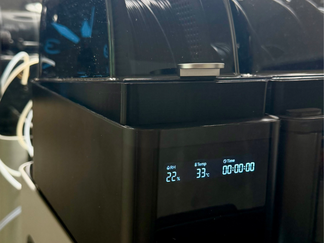

Also since we talking about AMS HT, I made a lid riser for it so you can dry and print with larger spools.
