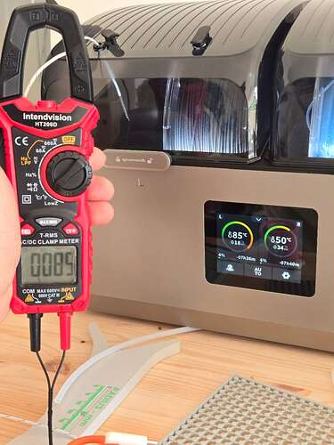

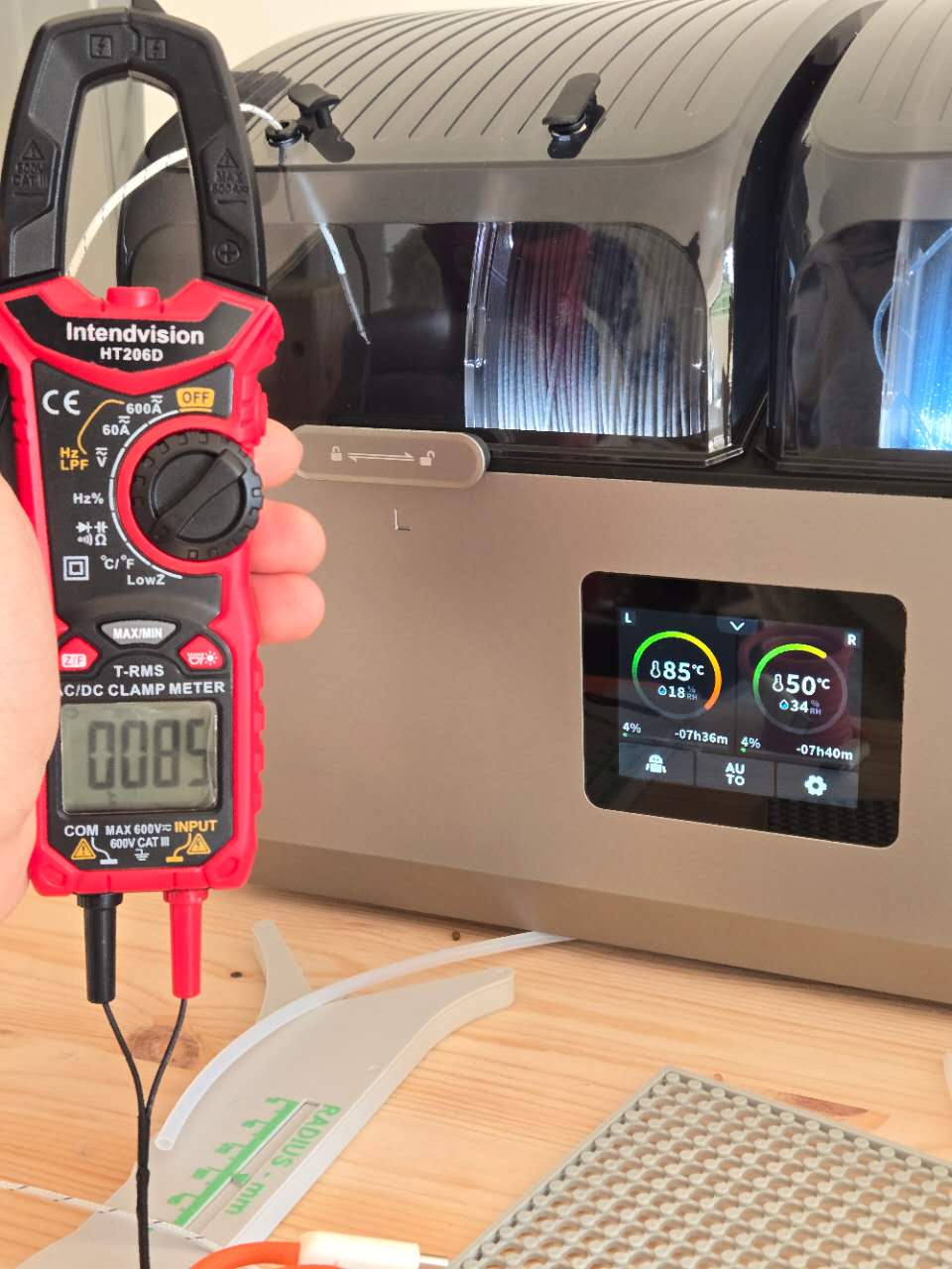

If you can’t measure temps even close to 85 at the heater outlet, have you contacted Bambu about it?
As far as 85 being a bit less than useful as a drying temp, at least that was advertised up front.

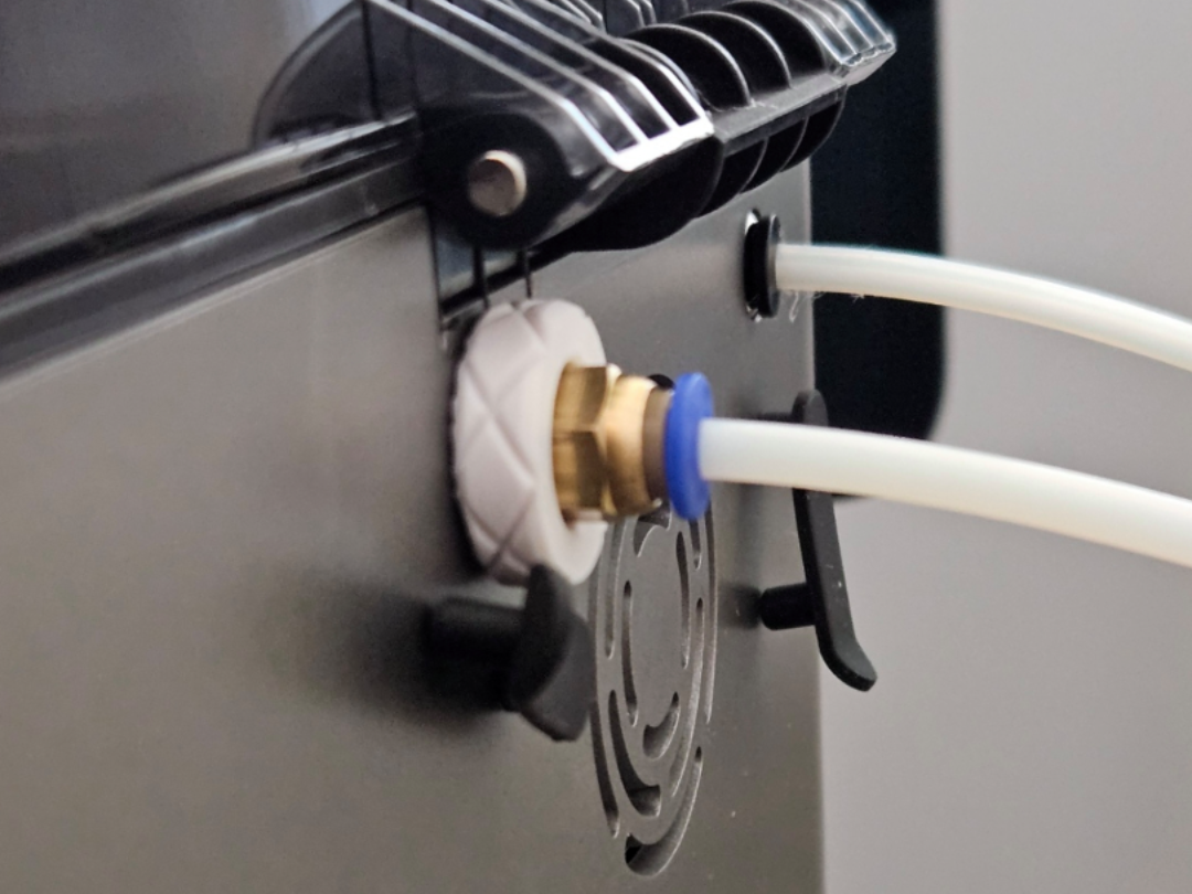

Only caveat: the build quality for the PTFE holders on the back suck… I made this model to improve it though – hope it helps :slight_smile:
YOU ARE AWESOME AND THANK YOU FOR MAKING THAT!
I think the acrylic they’re using are having slightly more friction than it should have, when a spool has been lifted due to low weight. I’ll see if I can make something for it.
Please ping me if you make something for it!

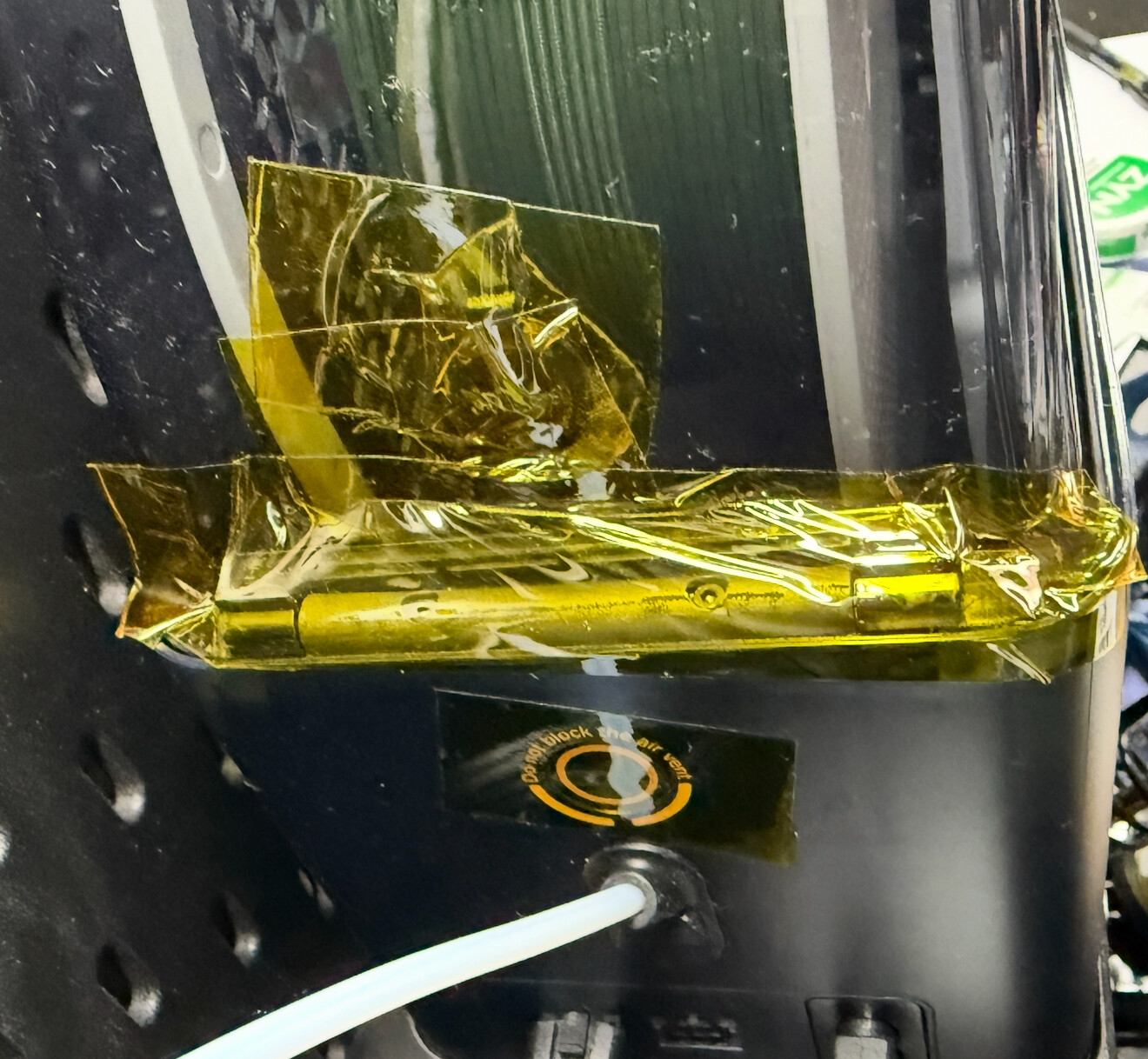

I think I’ve possibly located the source of the moisture intrusion. The hinge.
I used kapton tape to seal off the auto air vents first. That made no difference, the RH still climbed. So it’s not those.
Then I sealed off the lid hinge. What do ya know, the RH stopped climbing and after a while actually started going down.
I’m going to try and seal off the gap around the plugs too to see if that helps.

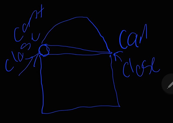

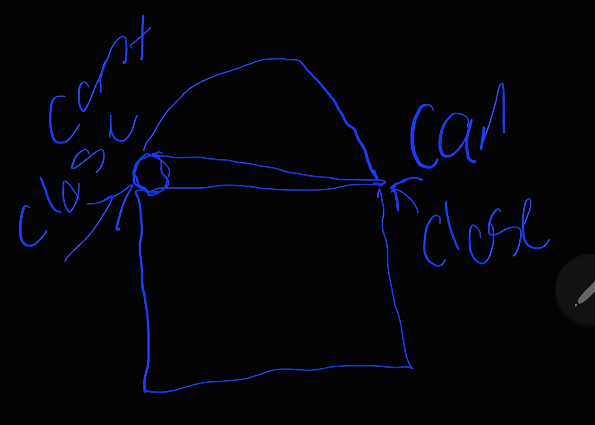

I wonder if a thicker seal would fix it. Being the hinge side, im guessing the sealing pressure isnt tight enough. Maybe the seal slightly shrinks after being heated
You would think that’s where the most pressure would be. Maybe it’s putting too much pressure on it. Enough to deform it slightly and cause a gap. I’ll have to look at one of mine a little closer next time they’re not in use.
It’s been a little while since I did this now and the RH would have climbed at least 4% or 5% by now. It’s holding steady!
This is what I was thinking. The hinge side is fixed but the other side closes pretty tight. If I get spare time, ill use some putty in the seal to see where the loose points are

It may not even be the seal, but what’s behind the interior lower plastic shell in that area. Snagged a pic from the Bambu store of the shell. I may have to take one apart to get a closer look and see if where the screw standoffs are is sealed or open to the lower interior.
