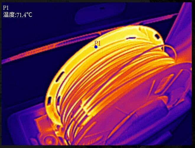

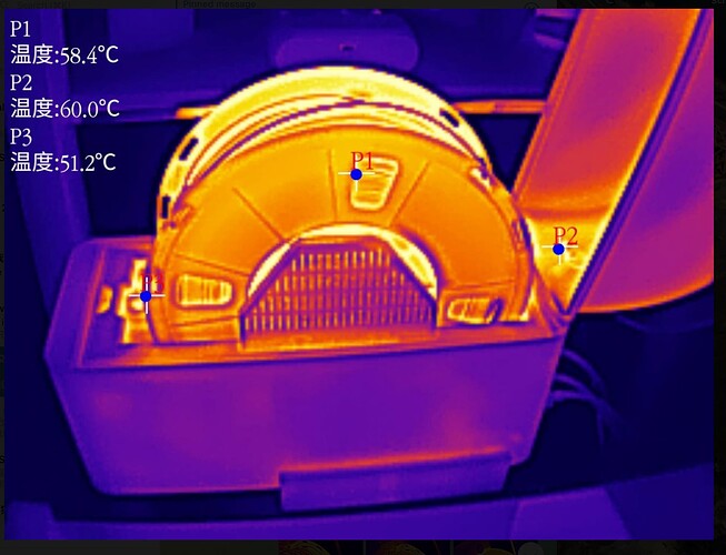

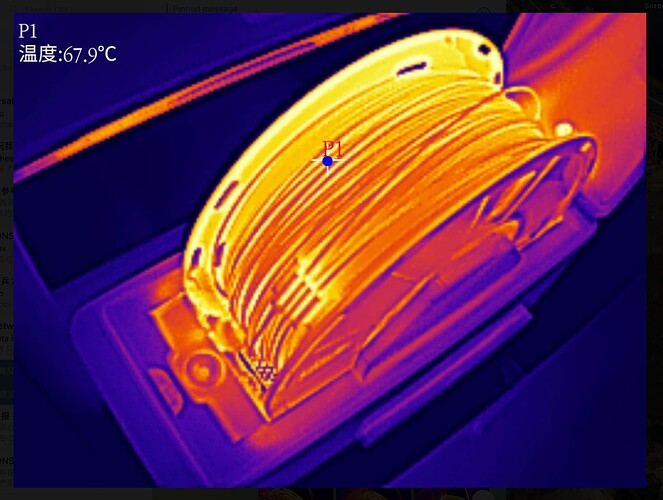

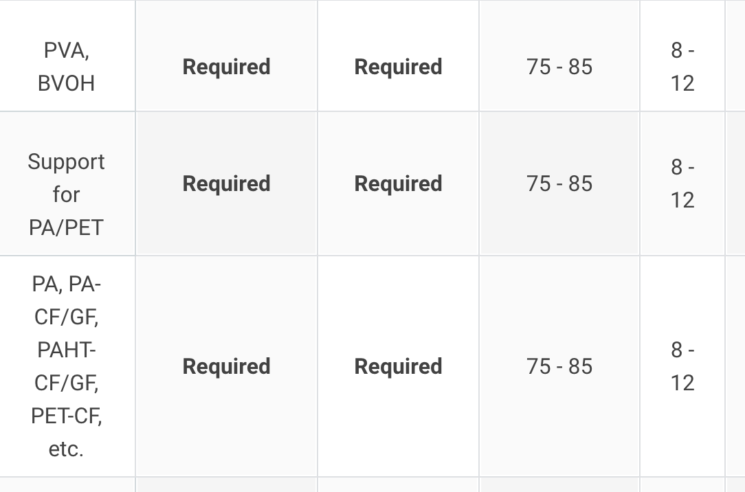

1. The filament can only reach 70C when the heating was set to 85C.
I don’t care what’s the excuse, but yes this is what you get from 16C room temperature in Sydney’s not so cold winters.
The branded “85C” was only achieved from the hot air vent. Not from the otherside of the chamber like most other filament dryers. Even the cheap cheap Creality Space Pi is doing it right. And the AMS HT is barely reaching a higher temp if not equal, when the Space Pi is set to 70C.

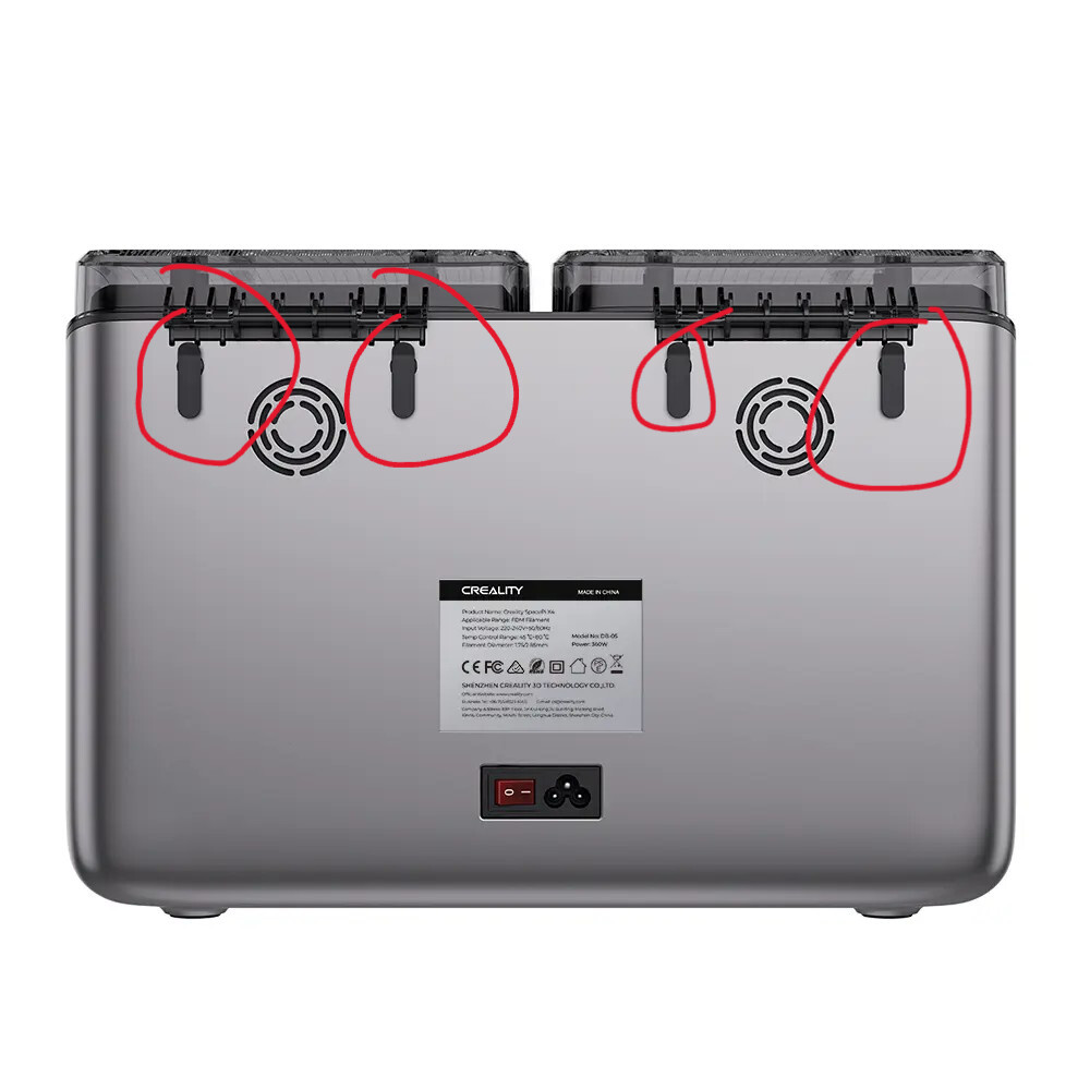

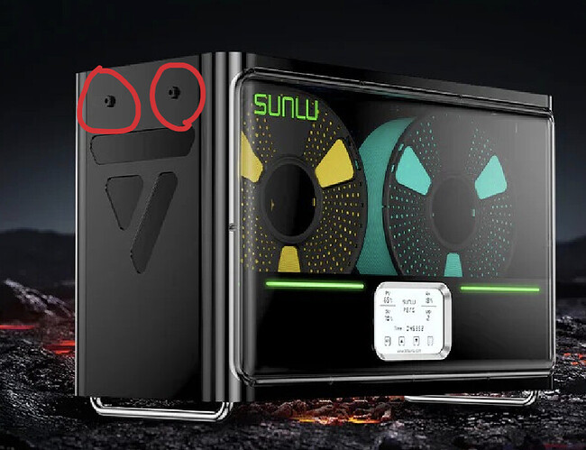

Any other sensible drybox/dryer manufacturer is at least putting the some of the outlets on fixed positions. Why it has to be fixed? Because you would not introduce unnecessary filament breakages.
Creality X4 for example
Sunlu S4 for example again
Both also have outlets on the lids, but that’s not the ONLY option they have.
