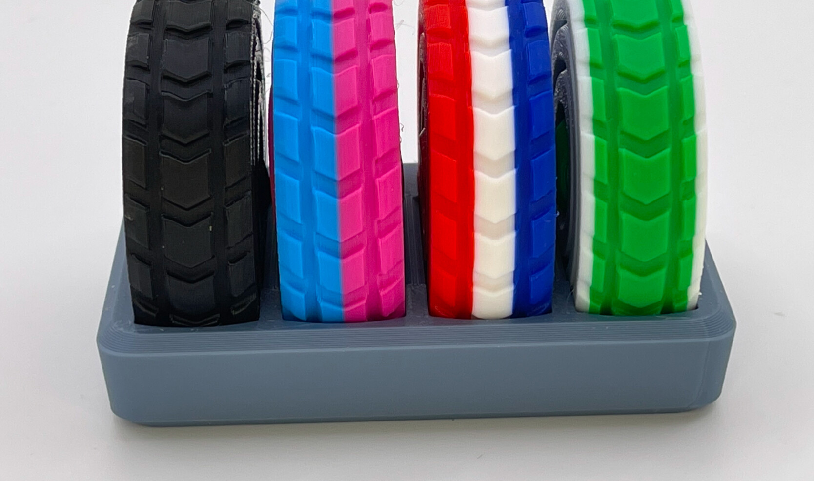

I often receive the comment that one of my fidget gyros/spinners are people’s first print using their AMS.
Whilst I have far more complicated prints to really test the AMS, the simple swap between one colour to another at a layer position makes a first use of the AMS stress free.
They print laying in their side.
You get the bonus of a fidget spinner at the end.
You can choose between:
  • Edges - outer edges are one colour with the middle portion a different colour.
  • Triple - three different colours
  • Dual - two different colours
  • Single - one colour, utterly useless test for your AMS.

@MalcTheOracle I think I need more help on this color swapping stuff. I Have a roll of white filament on station #1 and a black spool on station #4 for balance, and I loaded the first wheel fidget spinner for a 2 color print named “edges”. But I figured it would be automatic and show the two colors in the Bambu Slicer when I sliced the model. Apparently I have to assign them to the object, which there are four of, but that doesn’t look like it would do the correct thing. So how do I assign the colors like in the image for the 2 color edges print?

In the Edges example, you have two choices in the profile, white and green. You choose which you prefer to use for white, it can be white, you choose which to use for green, it can be green or anything else.
