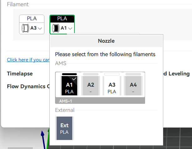

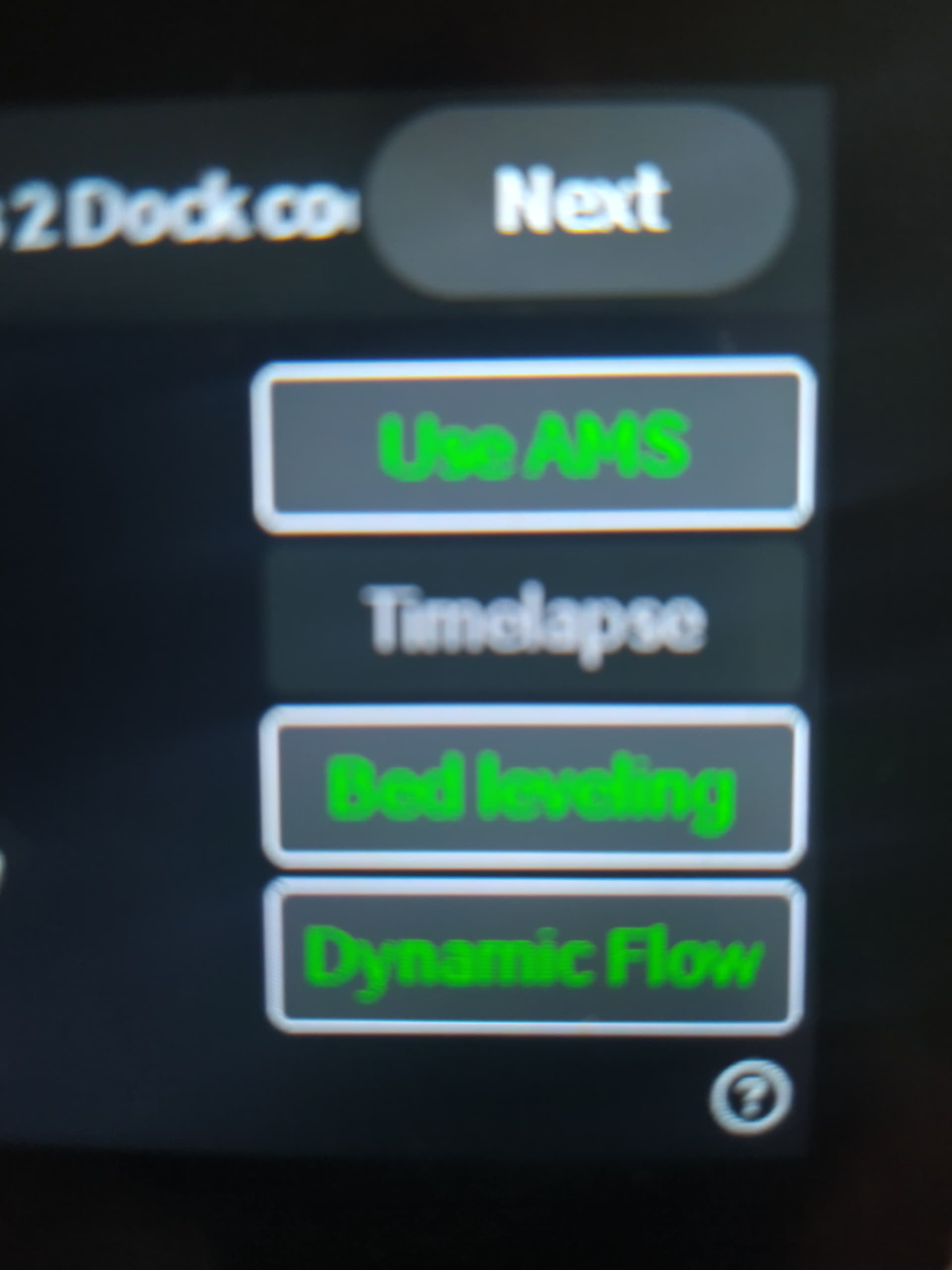

Just for clarity, when you are sending your print to the printer you have the “Enable AMS” check box selected?
AMS lite wont print multicolored - Bambu Lab A1 Series / General Discussions - Bambu Lab Community Forum
Only available when sending a print from the printer (A1), they changed it in studio
If its plugged in, its on and you now choose which to use in a drop down box
as neilJT said they have removed the checkbox when sending to the printer.
i have been tho the drop down box so many times selecting filament and matching it up. it still wont work and im at a big loss as to why. i seem to be doing everything right but just wont print the colors, it did print the base color once and then changed over to thin air and printed the rest out of nothing. thats the closest iv gotten but havent been able to replicate it.
