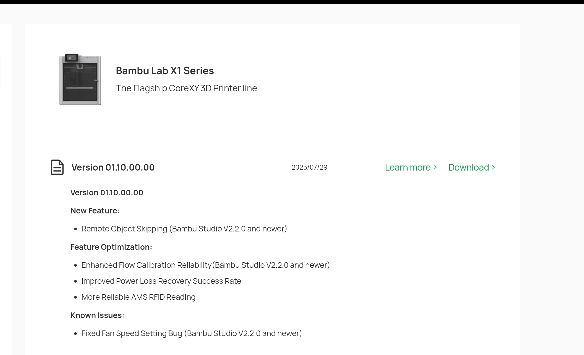

  1. I don’t think that the problem is with the AMS 2, because when I connect it with the old buffer (not the new hub) everything works perfectly, I just can’t operate more than 1 AMS (I have 2 AMS-1’s and 1 AMS 2).
  2. Then, I started wondering about firmware - Studio reports firmware version on the X1C as 01.08.02.00, (latest version it says) BUT reports firmware version 00.00.00.00 for the AMS2.
  3. How can I update the AMS to the latest version, and do I need to also update the X1C to make it work with multiple AMS units and the new hub.
    Any help would certainly be helpful, as it always has been in the past on other issues -
The latest for the X1C is 1.10.00.00. I would start by updating that. The AMS units should update automatically when you update the printers firmware. Try that and see if it fixes it.
It was worth a try, however, the update fails, says I must have at least V01.08.50.32 I looked every where and can not find that version…
So, I bit the bullet and went back online, instead of trying offline (Lan only mode). It is now at 3%, will let you know.
OK, I cheated by enabling the wifi, disabling the lan only, following directions on the screen under firmware (tap upper right corner) When completed re-enabled Lan Only, rebooted X1c,
Now running v01.10.00.00 on the X1C, and V 02.00.19.68
And everything works just great!Thanks a lot Printer Mcgee!!!
Well, almost! The second AMS printer is now doing the same load-unload-load thing that the new AMS-2 pro did before I updated the X1C.
I went through the same firmware deal I did on the X1C, and the second AMS printer firmware is now 00.00.06.75, but it still does not work.

Huh! I swapped the older, out of date AMS1 with the updated AMS1 and guess what? The old firmware works great with the AMS2-pro and the external hub!
(but I do get a popup that says the firmware is out of date) I’m gonna leave it that way, I should know better than to update firmware unless it’s at least a year old.
