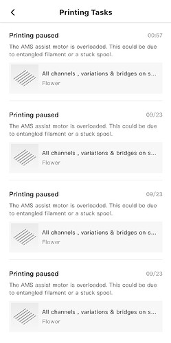

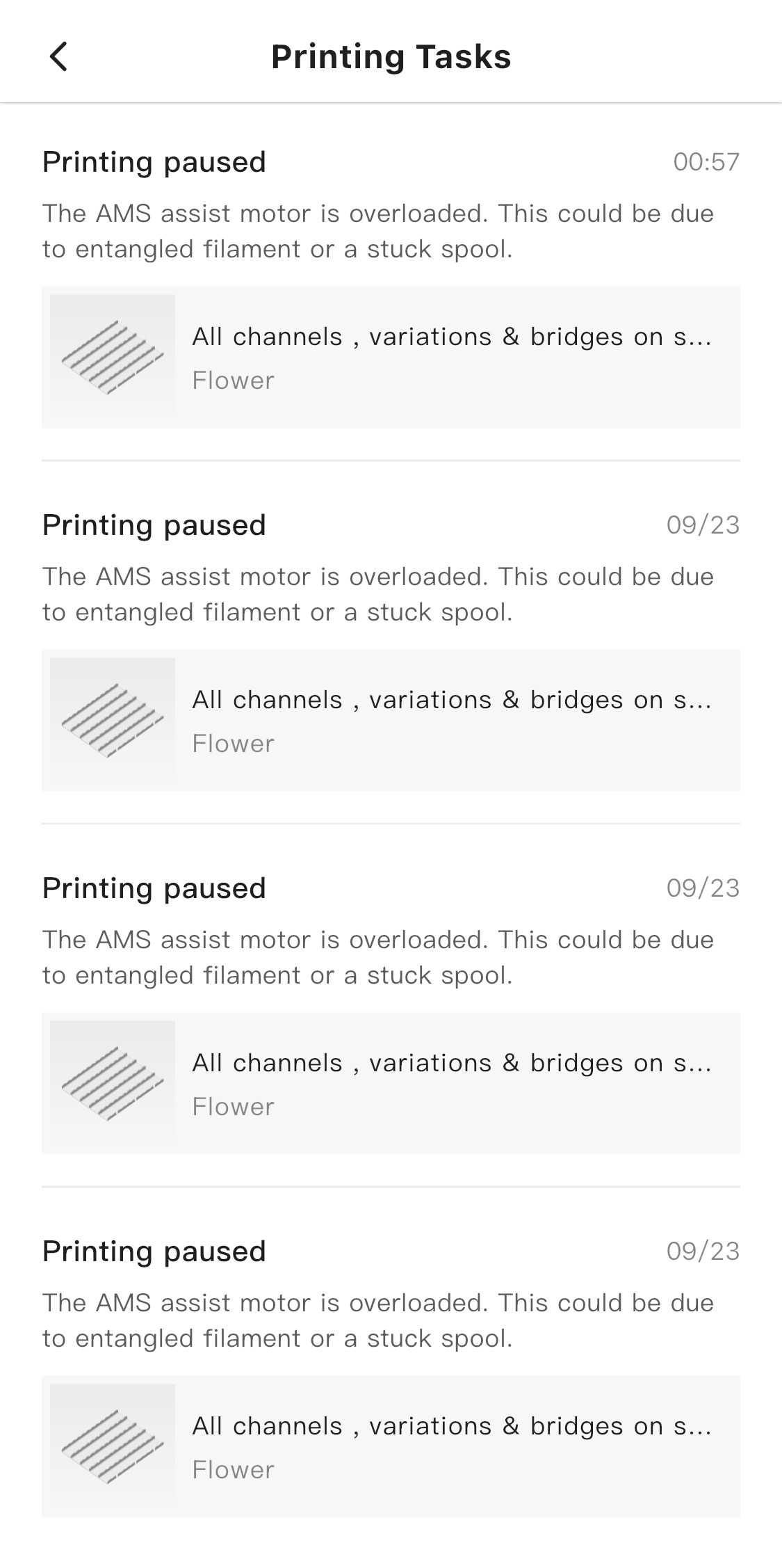

We have received 2 of the H2S printers 2 days ago and I have been printing quite a bit on them. There seems to be a recurring issue with the AMS motor being overloaded when printing with Bambu’s PLA Matte (white) in the front section of the print bed (towards the door). Some prints I have had 7 or so disruptions where it would say the AMS motor is overloaded and I had to press “Finished, Continue”, which it would then do just fine.
The problem appears to be that the PTFE tube going from the back of the machine to the print head is slightly too short. You can actually see that when the print head reaches the front few centimeters of the print bed, there is almost a kink in the PTFE tube at the coupling in the back of the machine.

I changed for a longer PTFE tube, because the bend into the print head was too tight.
Yes, I have some normal PTFE tube and some Capricorn XS tube ordered and will change it.
