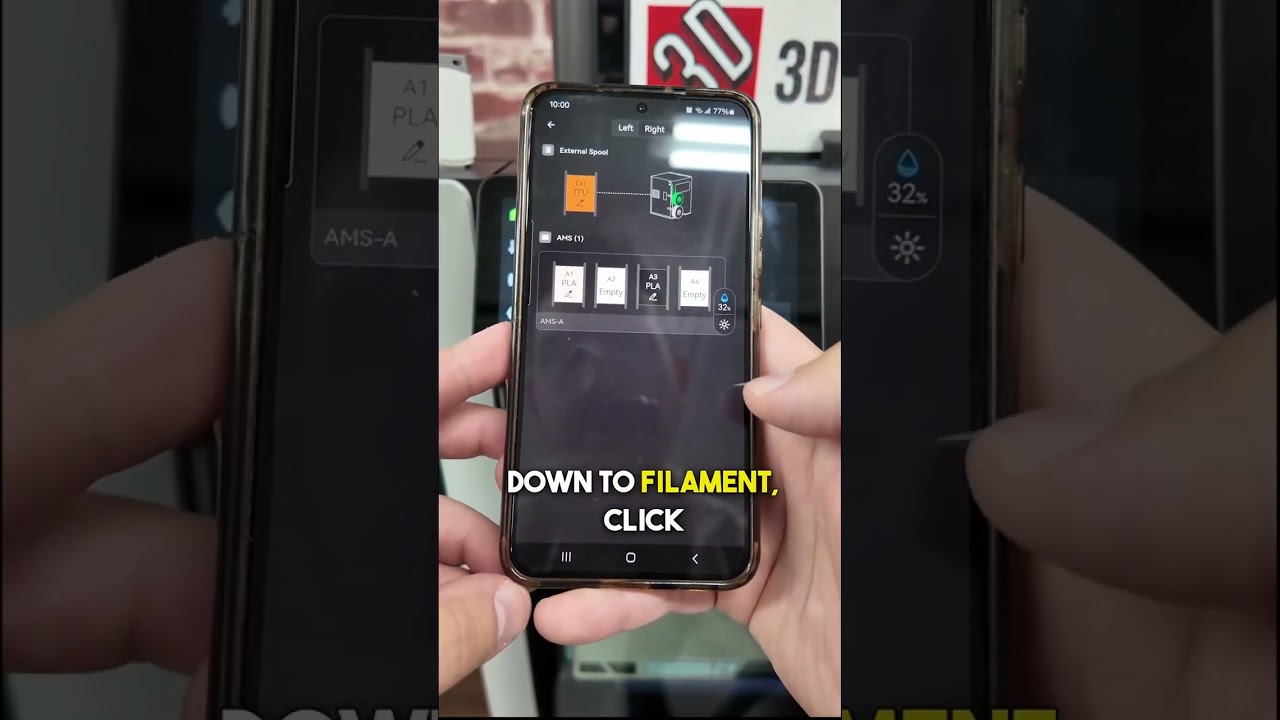

Generic filament won’t have RFID chips so the AMS will not recognize them. You have to manually input the values.
Yes, i’ve done this but since the last update it does not allow me to make manual changes to the filament setting.
I was trying to add PLA Wood as an external filament and I discovered that that filament wasn’t listed.

Where exactly do i input RFID chips?
Input them? The RFID tags come pre installed on Bambu filament which a Bambu AMS can read.
If you want to use 3rd party filament you will need to manually set the filament type on the printer display/Handy/Studio.

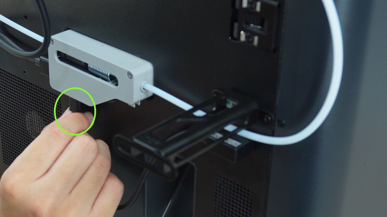

I use Bambu PLA, so i’m cool, i guess. Have already followed those instructions. However, i am still UNABLE to print. I get this message:
“The filament buffer signal lost, the cable or position sensor may be malfunctioning.”
So frustrating!!
What model of printer are you using?
P1S. I usually print with PLA Silk, PLA Basic, but have just hooked up PLA Wood. A .4mm nozzle is acceptable, i believe.
Yes, this is an issue that resurfaces periodically with certain types of filament.Bambu does list that on the filament page for that filament, but it doesn’t help that it is “under the fold”
You have to expand the “View More” to see it.
Edit: also if you scroll waaayyyyy down it is under printing tips…
First I would check that the 4 pin connector is corrected correctly to the buffer as that is the error you are getting.
Problem solved! Thanks a mil!
