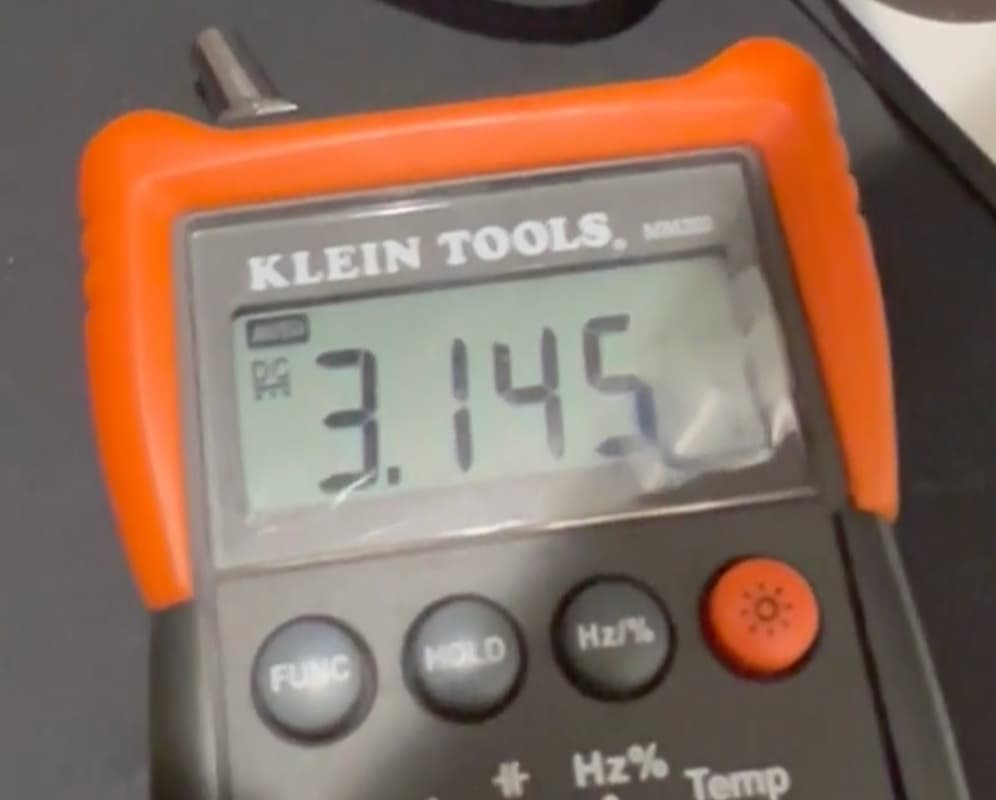

I sent a video showing that I was getting less than 4v from my X1C, it’s supposed to be around 24 right? They are sending me a new powerboard and main board of the AMS, not the X1C. I guess if this had happened after owning the printer 6 mos I wouldn’t be too upset, but I had it about 8 hours and it died on me. It’s been a huge hassle and I’m sorry to say but I just never had any issues with my Prusa so of course I’m carrying forward those expectations (and maybe I was lucky with it).
Totally depends on where you are measuring. A lot of logic is 3.3V now so less than 4V might be normal. There are probably a few different voltages at various points in the system.
To be able to get an answer if that voltage is ok or not you have to say where the measurement was taken.

And communications signals are even more problematic. Regular voltmeters will just see the average value. You need something like an oscilloscope to measure the highs and lows properly. A voltmeter on a communications bus is just going to mislead generally.

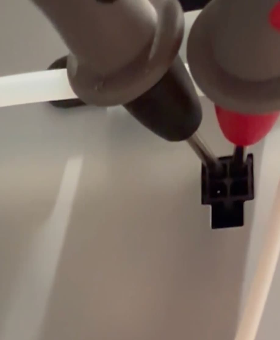

I can’t share the video or screenshot but on the page about ams-power-failure (the wiki Jon shared) I’m measuring on the printer end the top two squares (ground and power). That’s why I thought it should be constant near 24v but I’m reading about 3.1v. My background is software and I’m a novice at electronics so maybe I’m totally wrong.

Double check that you have your meter set to DC not AC.
Thanks Jon.
It is on DC:
And here is where I’m measuring from:
Thank you for the pictures.
I’m pretty sure you’re checking the wrong side/pins of the connector. The power pins are on the tab side of the connector.
