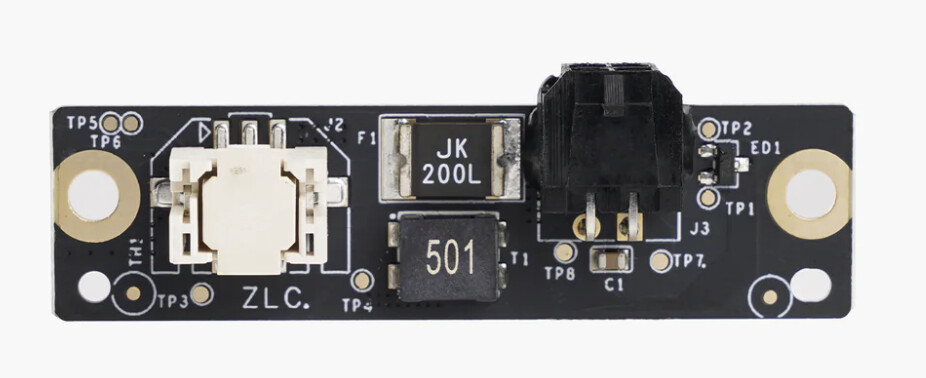

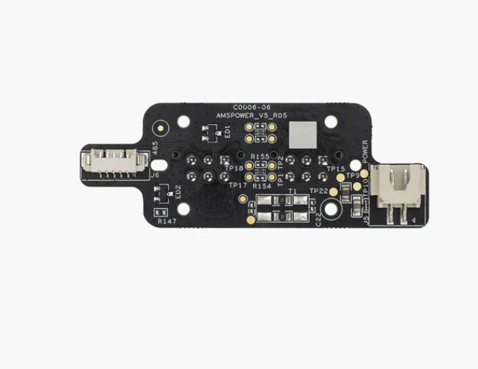

The AMS boards would be my last guess. Which one did you have problems with:
TY
The top one. The box the replacement came in says AMSCON_PCBA Model : SPP009
I went through a long process of swapping AMS cables, running with just one AMS, going back to the AMS buffer, replacing the AMS hub. It was an intermittent error the whole time and just when I though it was one thing it failed when that thing wasn’t involved. I don’t recommend the experience.

Wasn’t too bad, been a while so I don’t remember the details but take the back cover off and it’s there. I think I remember that one of the mounting screws might have been awkward to reach.
Thanks! I found the instructions and decided to just check to make sure cables were seated properly before my replacement board shows up. Nothing was obvious, but it may have helped. I’m currently at 24 hours without a problem. We’ll see if that lasts. . .
