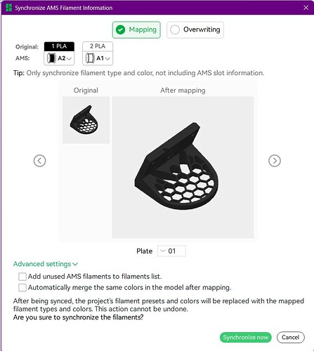

Hello everyone. I can’t figure out what I’m doing wrong.
Printer: P1S (01.08.01.00) + AMS 2 (02.00.19.68).
Slot 1: PLA alegoo,
slot 2:PLA bambulab .
The model was downloaded from market world. It contains its own filament, which I replace with PLA bambulab (slot 2).

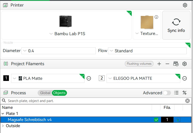

when printing started AMS take filament not from the second slot, where the PLA bambula located, but always from the first slot. I have tried 3 different models and always with monochrome printing, the printer takes the filament from the first slot, although in the project I change it to slot 2. Tell me what i’m doing wrong?
The numbers on the “project filaments” do not correspond to how they are set and mapped to the ams.

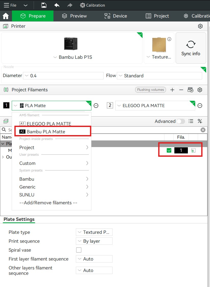

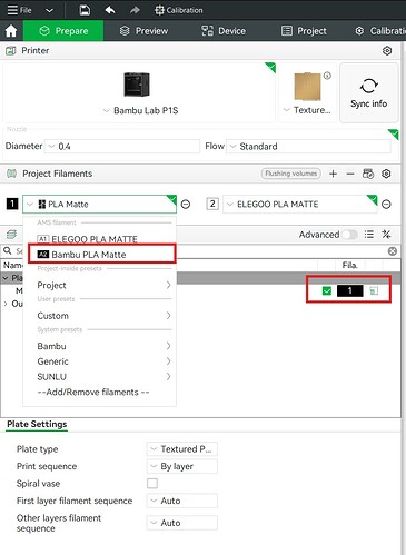

Easiest to right click the model and set the filament via the popup menu.
Ignore these numbers when it comes to the ams mapping
