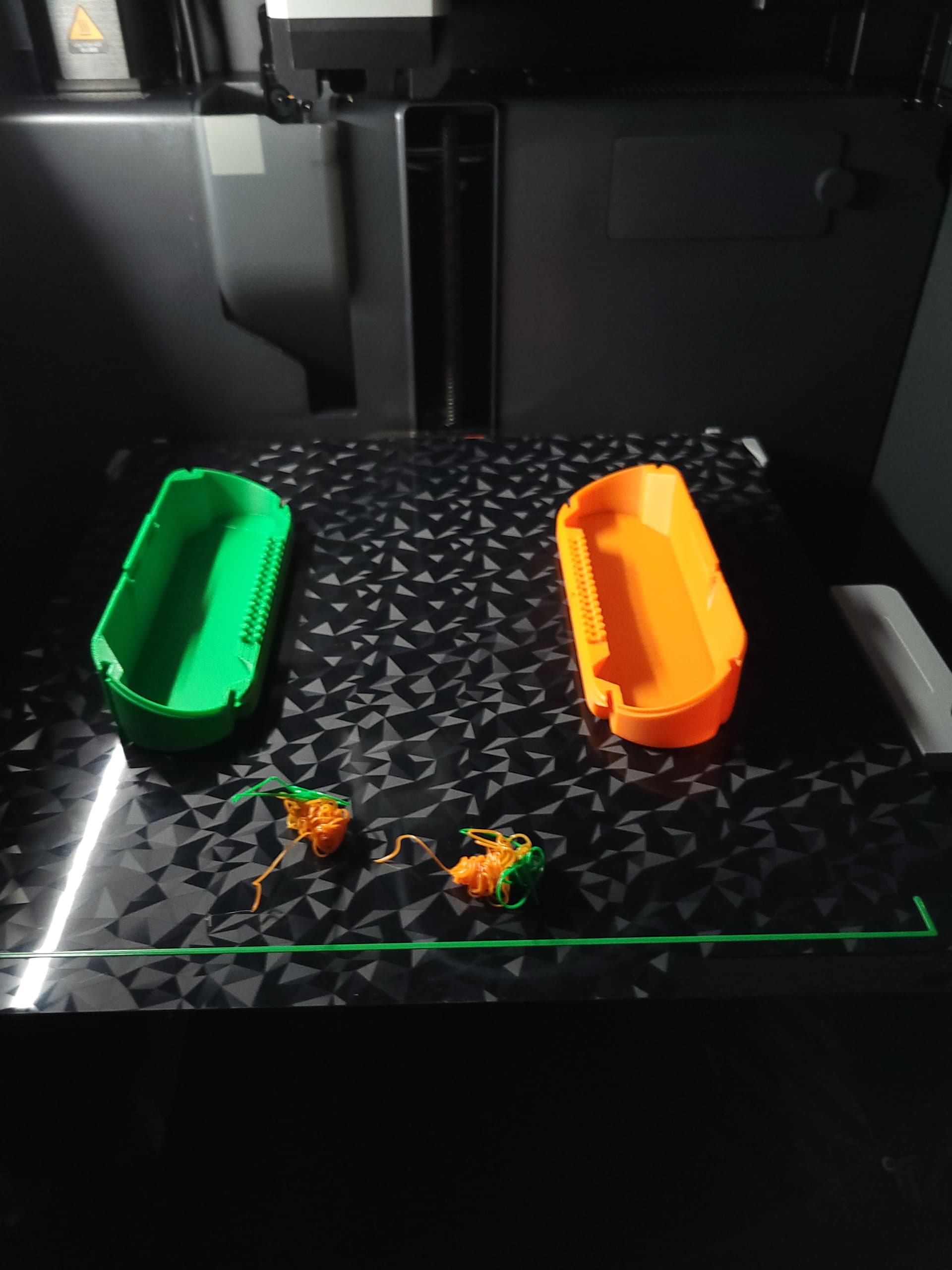

Ok so I just started using the AMS, I am printing 2 objects 1 orange and 1 green. I have it set to print the orange object first and then print the green object second. While it’s printing the orange object, it will randomly purge the orange filament, load the green filament, purge the green, and then reload the orange, sometimes multiple times per layer. It keeps repeating this cycle wasting filament.

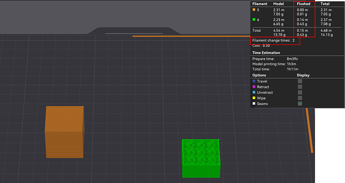

Please correct me if I misunderstood. You are printing two objects within the slicer, defining the print sequence by object instead of by layer. Is this correct?
If that is the case, can you check in the slicer for the number of filament changes and flushed material? E.g.:
You should only have two filament changes and a low amount of flushed material. Otherwise, the problem is within the sliced file.
Ya that’s what I’m doing, I think I might’ve just realized what I did.
I started with 1 green object on the plate and duplicated it, so I had 2 green objects. Then I painted 1 orange, in the paint process I missed spots on the model that I couldn’t see. So when I posted it it had a bunch of filament changes.
I just found the “change filament” option when you right click on an object. That makes way more sense than trying to paint the whole object.
Now when I slice I have 2 filament changes.
I will definitely keep my eye on the filament changes from now on!
Thanks

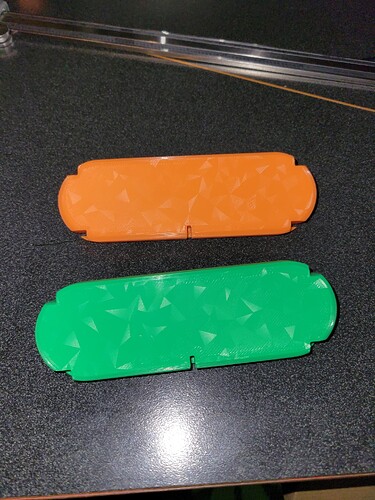

I have to identical pieces I wanted to be in two colors. Individually they are about 40 minutes per piece, normally I would have to go into my basement, remove the first finished print and then start a second print. This way like you said, I can just go to bed and when I wake up in the morning I have two finished pieces in different colors with no extra effort from me. And with the option of printing by object selected it will print the first object in orange, change filament and then print the second object in green. The only waste you have is the 1 filament change
Not sure how it works with the A1 but with the P1S I just have 2 poops and no tower
First layers look great, can’t see any colour mixing at all

@Llamalot, the effect of the plate on the print surface looks great.
