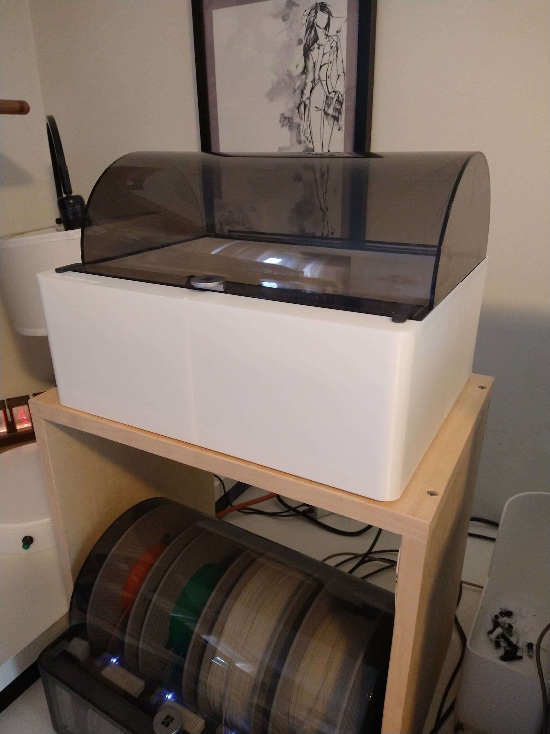

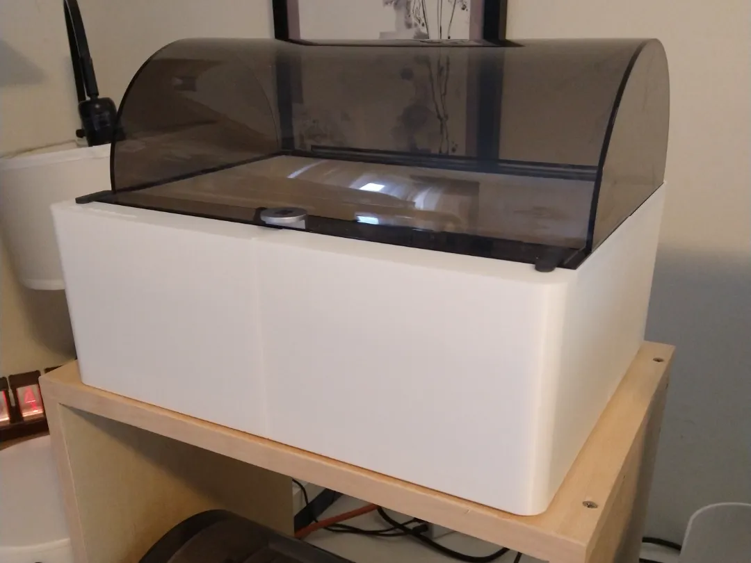

I just printed this.
It is an AMS, where I redesigned the case, with a removable bottom cover. The bottom cover makes it easy to access the plumbing if something goes wrong. Just tip it on its side with all the spools still in it and pull off the bottom cover. I use the same gasket as the lid to ensure a sealed container. I’ve been using it for a couple of days now and with my Dry Pods, the humidity has been holding at 10%. I also made the case a little taller, so it can handle 204 mm spools, and the spool tray is a LOT easier to get in and out.
In the image the thing on the bottom is an active dryer that I designed, where I used a C r e a l i t y Pi 2 filament dryer as a doner. The dryer unit can replace the bottom cover and provide an integrated drying function. If I print my new Cases for all my AMSs I will be able to rotate the Dryer through them as needed without even having to disturb a print. Sort of like the Polymaker dryer which is shared between filament holders, but at a larger scale. I’m printing this now in PETG-HF, and I’m hoping it can handle the two 80W heater elements. I did some test prints and so far nothing has melted.
I also redesigned the spool tray with vents, so when the dryer is attached, the air can circulate around the filament spools. In the front, out the back, with some of the air recycling. The tray also includes all the extra slots that a Hydra provides to support smaller spools.
The only problem is this is all a LOT of print time and filament. The case and bottom cover takes 33.5 hours, the vented spool tray 17 hours, and the dryer 19 hours…These are all with 0.20 Standard settings. I could probably get it done much faster if I went to 0.28 settings and ludicrous mode if I wanted to give up some surface quality and component accuracy.
I should have it all working in the next couple of days. And any feedback would be appreciated.

My first version is completed and working, allowing me to run dryer 5-6 hour cycles. The case is printed in PLA, the spool trays in ABS-GF and the dryer in PETG-GF. The problem I’m having is that at the end of a 6 hour PLA drying cycle (50 degrees C) the humidity will be down around 15% (good), but after everything cools down an hour later, it is back up to 25% (bad). So a drying cycle is having almost no effect.
I found that the temperature didn’t drop if I cracked the cover (i.e., the cover was resting on its clamps). So I tried running a cycle this way, hoping that some of the moisture would escape, but the result was basically the same.
I then redesigned the dryer body so it had some intake and exhust vents, that would open while the dryer fans were on. The problem here was finding a low-cost continuous duty solenoid that I could use to open the vents. Cheap solenoids can only be activated for short periods otherwise they overheat. The continuous duty solenoids that I found expected to heat sinked to a 3 sq in 1/8" aluminim plate. This is problematic if you don’t own any metal working equipment.

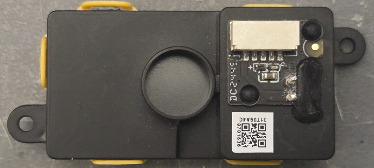

Then Bambu announced the AMS 2, and I discovered on their spare parts website their Air Inlet Units (i.e., vent shutters that they open during the drying process). I ordered 2 of them, and reverse engineered them. They have a bi-stable solenoid driven mechanism in them that opens the vent when 5V pulse is applied with one polarity, and closes them when a pulse is applied with the opposite polarity. Now I just need to figure out a circuit that I can attach to the fans that will generate the correct signaling when the fans are power up and down…

After the AMS 2’s came out, I decided that they made my whole project moot, so I dropped it.
But my case may be worth posting. It sets the top cover 10mm higher, supporting larger diameter spools. I’ve reconfigured it with my AMS Tray with sliding dividers for wide spools, which is a super-set of the Hydra tray. So now I can easily use all sorts of odd-ball spool sizes.
I can post my modified AMS 1 Case redesign if it helps you. It will work with my sliding divider spool tray or the Bambu factory tray.

Hi Steve, yes I would be interested in having a look at it. It’s probably a better design than what’s out there I’ve looked into the circuitry required to open and close the AMS vent, the solenoids are Self fletching and only require a momentary pulse of either positive or negative to actuate it so the circuit is a little complicated but some AI searches are coming up with some good info which I’ll continue to look at. Ordered to AMS vents. There are circuit boards already out there that will give momentary pulses. The tricky part with this one is that two open and closes negative and positive reversed but that can be done with a relay and capacitor.
I used a C r e a l i t y Pi 2 filament dryer as a doner. I was thinking of using some diodes and capacitors connected to the 12V power used to turn and off to the filament dryer fans to generate the necessary pulses for the AMS vents, based on the rising and falling edges of the fan power.
In the picture below the 2 pins on the left side of the connector open and close the vent. I don’t know what voltage it is supposed to work at, but I was able to reliably open and close the vent using 5 volts on the two pins. I don’t think the other 3 pins are used. One polarity opened the vent, reversing the polarity on the same pins closed it.​

I just posted it.
Please let me know how it works for you. I didn’t want to print another, and I didn’t take any pictures when I originally assmbled it, so the assembly instructions are rather light.
Hi Trevor, I posted my AMS 1 Case.

I’m going to use a 240 V combination heating and hygrometer controller with the output side of hygrometer going to a 5 V DC switching transformer into an Arduino Nano to generate the pulses through a H bridge motor controller to reverse the polarity. You’re right the vents use 5 V DC the other pins are used for logic sensing back to bamboo software to say whether or not the vent actually opened or closed so they can report an error obviously we don’t use that.
