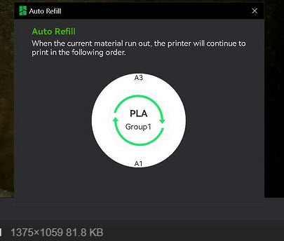

OK, So I have this all set up and all looks correct - as I have the dialog box shown below,
Is this telling me it will use Slot A3 first the slot A1?
I would like to use A1 till empty then A3 - how can I change this?
In Bambu Studio I have the filament in A1 selected for the part (object) not A3, so I am not sure why its defaulting to using A3 first then A1.
Thanks?
I try tapping (on device) or clicking in BS on the arrows and they dont seem to changeā€¦

Then you send the print to the printer you can select which slot is used first.
OK, so i send it to printer and then another dialog box will appear and in that, it will let me select which filament to print first?
Yes as detailed here.
Thank You, I will try that next time !
FYI a visual for that:
