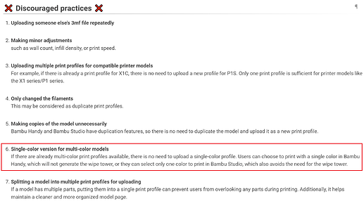

In the beginning I had individual color profiles. I stopped providing them because MakerWorld officially discourages uploading them.
to be found here: Print Profile Upload Guidance | Bambu Lab Wiki
Only had a single user asking for a single color profile since.

That one means if a multi-color profile has been provided, there is no need to add one using only one color because users can asign all the colors to one color and make it into a single color print.
But I thought your question is whether or not a designer should provide a profile specifying pauses at various layers so a user can print in multiple colors by manually swapping filaments.
BTW, I don’t make non-AWS versions.
I believe that was intended to discourage third parties from adding profiles to another designer’s models who have only provided a colour profile.
I do not believe that is related to a designer adding a profile of their own however they see fit.
