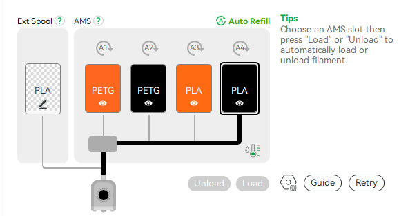

From time to time in Bambu Studio the AMS window does not display the currently calibrated filaments.
The colors and filament types are correct, but the calibration values ​​are missing.

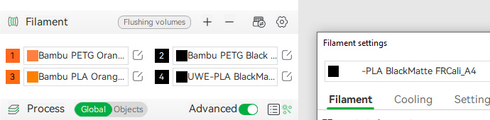

While the correct filament with the calibration values ​​is displayed under Prepare or Preview,
Filament-Preview
It just looks like this in the AMS window:
Fenster-AMS
What should I do?
L.G.
Frank

In the preview, you choose the filament preset, which includes the flow ratio.

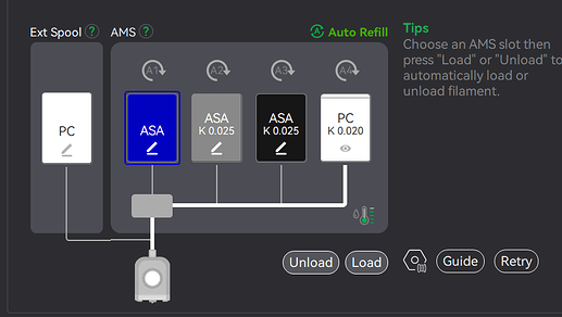

In the device windows, the AMS values relate to the k value, which is stored in the printer/AMS.
If they are not displayed, they are not set. Press the filament colour and select your present (i.e., k value in printer memory).
For example, here, I only have the flow ratio and other settings related to your filament that will needed to slice the model.
Here, I have the k value for the different filaments. All are defined except the blue ASA ( I removed for the example):

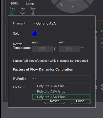

I can choose from my stored calibration data the right preset:
In Bambu-Studio I cannot make a selection in either the filament field or the PA Profile field.
Filament-Dropdown
I also can’t write in the factor K field.
However, I recently reset the printer to factory settings.
Does this mean that the calibration values ​​are lost?
Are they saved in the printer only?
When I click on “Synchronize filament list from AMS” in Bambu Studio, it only goes in one direction, from AMS to Bambu Studio.
Is there still a way to get the calibrated filaments back into the printer or do I have to recalibrate?

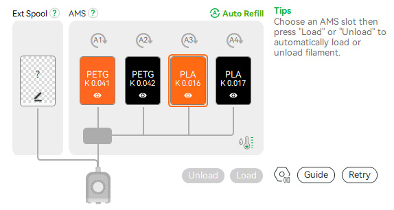

I have now also recalibrated the filaments in the AMS.
Fenster-AMS-Calibrated
Even if it’s not the solution I wanted, I consider your answer as a solution.
