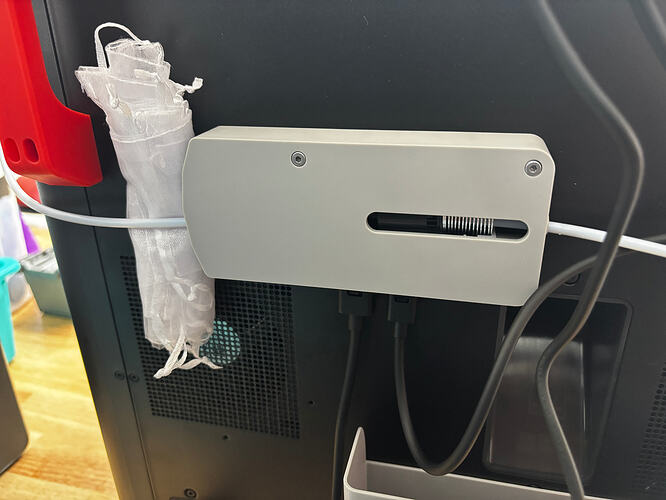

Instead, I’m running into feeding issues primarily @ the external HUB that is mounted to the back of the P1s. I’ve attempted changing the input port, with no change, if there is an issue, the filament fails to make it past the input connector at the hub.

Well, after multiple hours of babysitting, I’m quite confident that the issue is the angle on the inlet bowden tube connectors going into the AMS HUB.
While still not perfect, after considerable feats of engineering, I might have found a temporary fix. Since executing this fix, I’ve now reached more than 25 consecutive successful AMS driven filament changes… more than 10 times the prior record of 2 consecutive changes without a failure.

Support is sending me a new AMS hub to try. Hopefully that resolves my issues.
Got the new replacement hub in a few days ago, and haven’t been having any issues since. Does look like I may have gotten one where the alignment wasn’t quite right.
Marking as solved as replacement of the hub fixed the issue.
