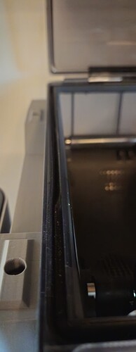

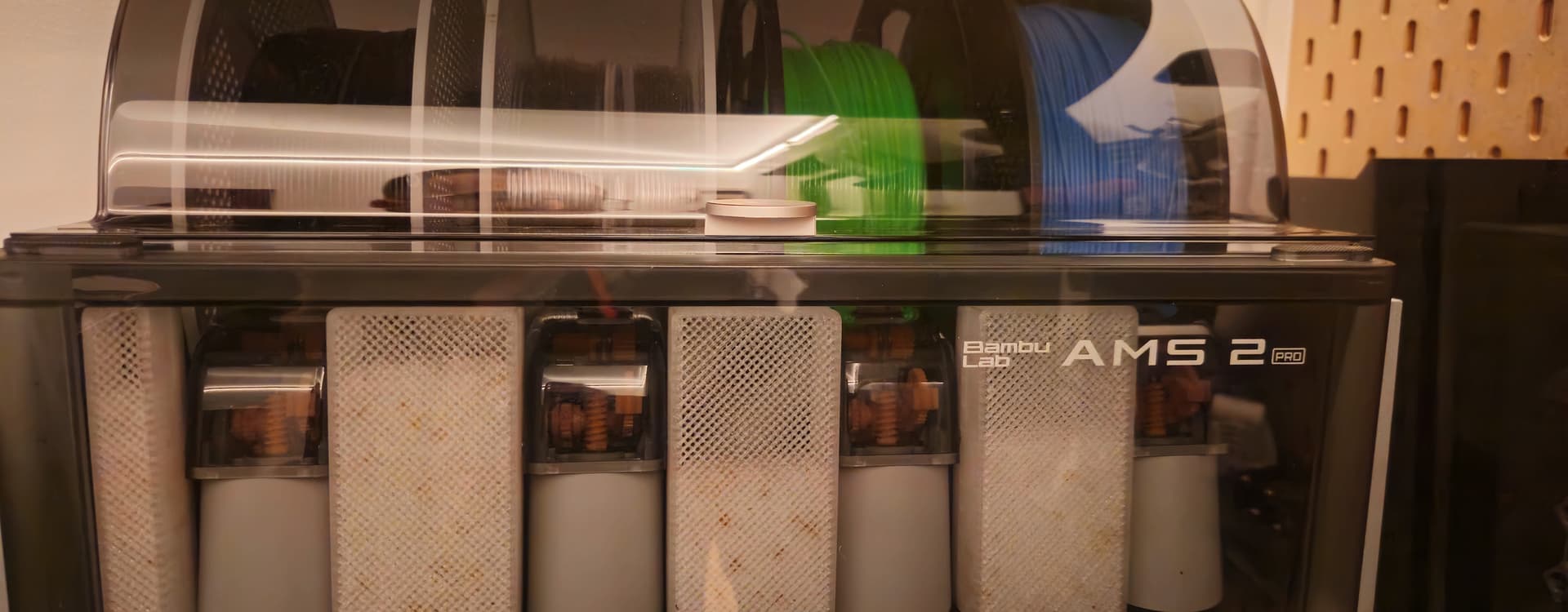

The thing is that the lid from my AMS2 Pro does not properly close, and I can see that at the bottom there are some parts that do not seem to be in the right place.
Here you can see some pictures that showcase the problem of the lid, but more significantly, the problem at the bottom of the AMS 2 pro:

I had this too. Please check the rubber sealing. Mine was squished somehow. But you can put the sealing back using a blunt instrument running through the the middle sealing gap.

The gap at the bottom looks like it hasn’t been assembled correctly?

Here are some pictures of how it looks when I don’t push the lid and I just let it rest:
Here are some pictures of the sealing rubber:

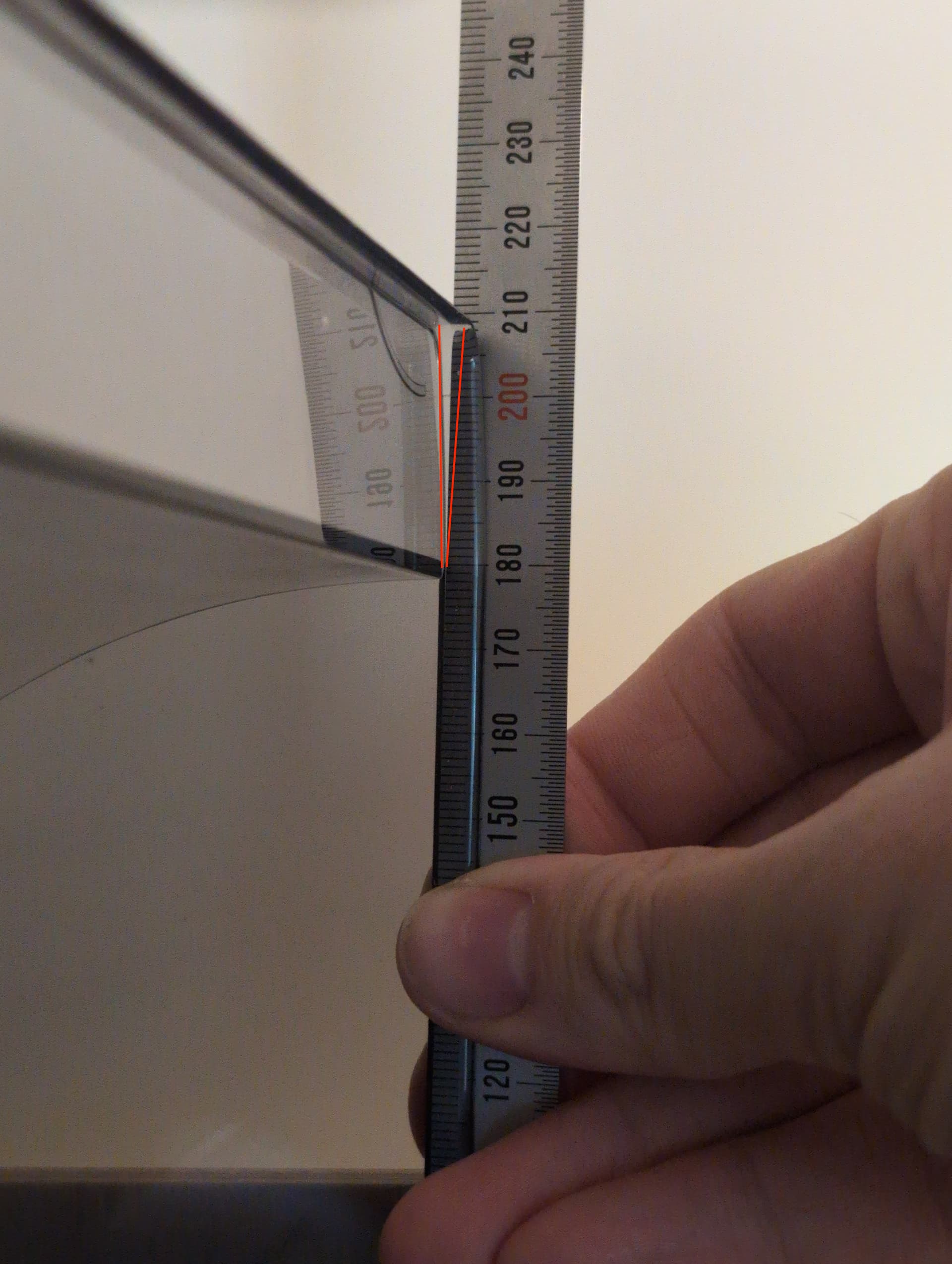

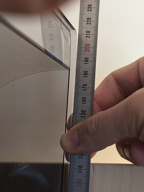

with the base, I mean the transparent bottom shell. You could use a ruler to check if the edges are straight.
In my case, one corner of the lid was visibly bent upwards, i think ~2mm. When I forced that corner down with the small lever, it caused the lid to bulge in the middle like in your photo. It also caused the sealing to deform. let me see if I still can retrieve the photo from the ticket.

To be clear, you are referring to this gap, righ?
Is that from the front part or the back of the device?
exactly
this is at the front. if you look closely, you can see the slightly raised curve that the levers ride on.
