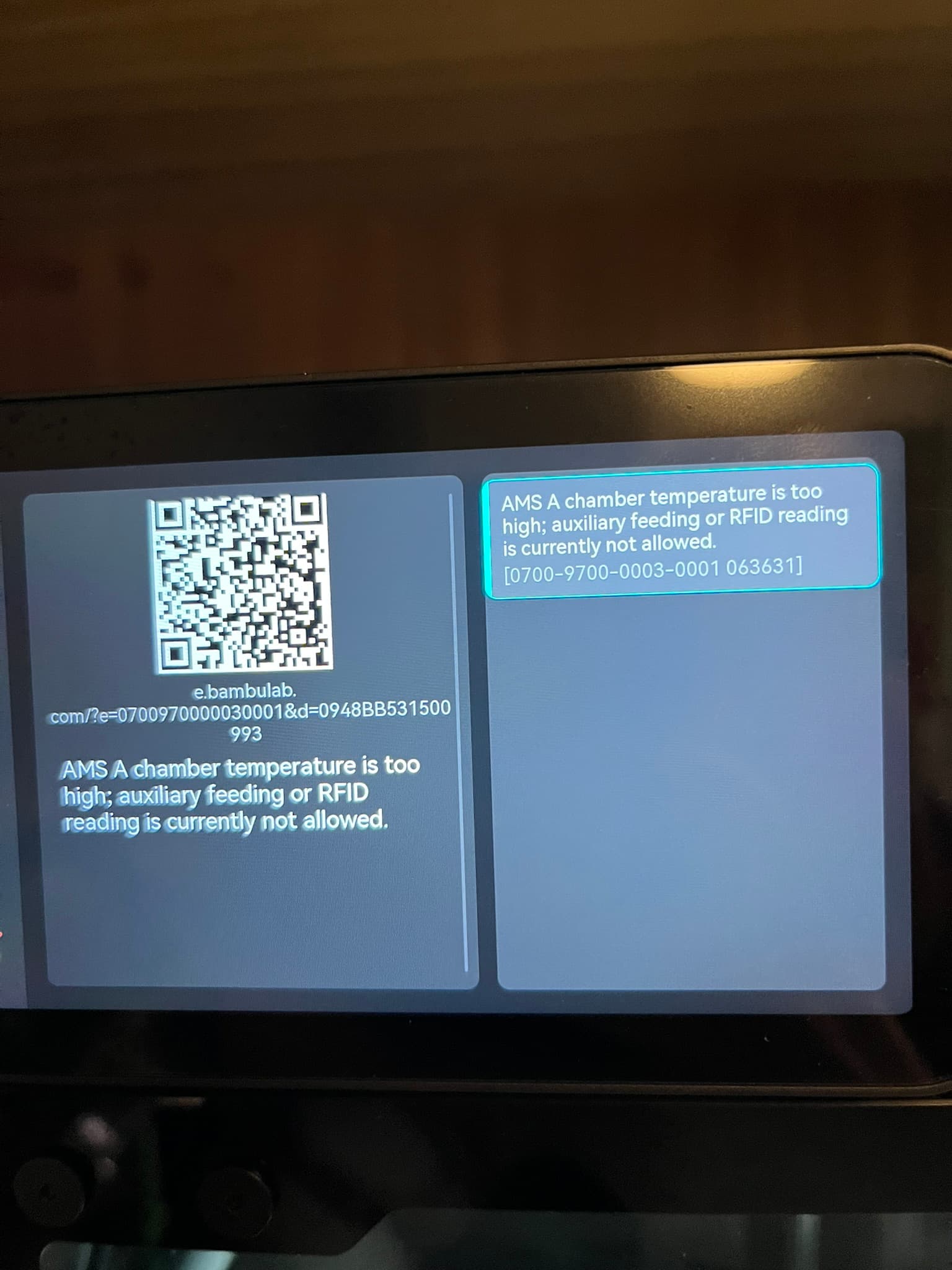

I just got this error, with the printer informing me that RFID reading and auxiliary feeding is disabled because the AMS2 chamber is too hot? So you pretty much cant print while drying, and you cant print AFTER drying?
Error Code 0700-9700-0003-0001 06363

There’s a temperature threshold that prevents some features when it’s been hit. You can wait a few minutes for the internal temp to cool off and then try again. Off the top of my head I think it’s either 45 or 50C?

What is your AMS temp at?
35 Degrees now, left it open about 10 minutes but honestly, I dont want all this drying to go to waste JUST to be able to use it normally…

And what does auxiliary feeding mean? I still cant find an article or something on this error. the QR just takes me to the generic wiki
Wait it’s room temp and you’re still seeing the error?
no the “stand” its sitting on is room temp. The ams itself is currently at 32. Yes the error is still there. Printer DID start printing though, feeding from said AMS so I really wonder what the auxiliary feeding “disabled” means…
At this point I think it’s a bug. I have printed when the temp was over 40 before. I’d recommend pulling your logs after the print is done and power cycling everything. Then making a ticket with said logs.
I have noticed that errors tend to stick around for a while though, so it might just be the initial error that is still there

If this is living in a production line environment, add 30 minutes to your schedule after drying before the machine is live, move your drying schedule back 30 minutes, or reduce dry time by 30 minutes (maybe even 15). You now know the limitation, so you can put it into your existing schedule and work around it.
If you are wondering why this is a limitation, filaments can soften at hotter temperatures and can jam up the AMS gears. This is a safety to prevent damage to the AMS (and prevent unnecessary support tickets). I much rather adjust a schedule than have to open up the AMS and possibly order/replace hardware because I was impatient.
