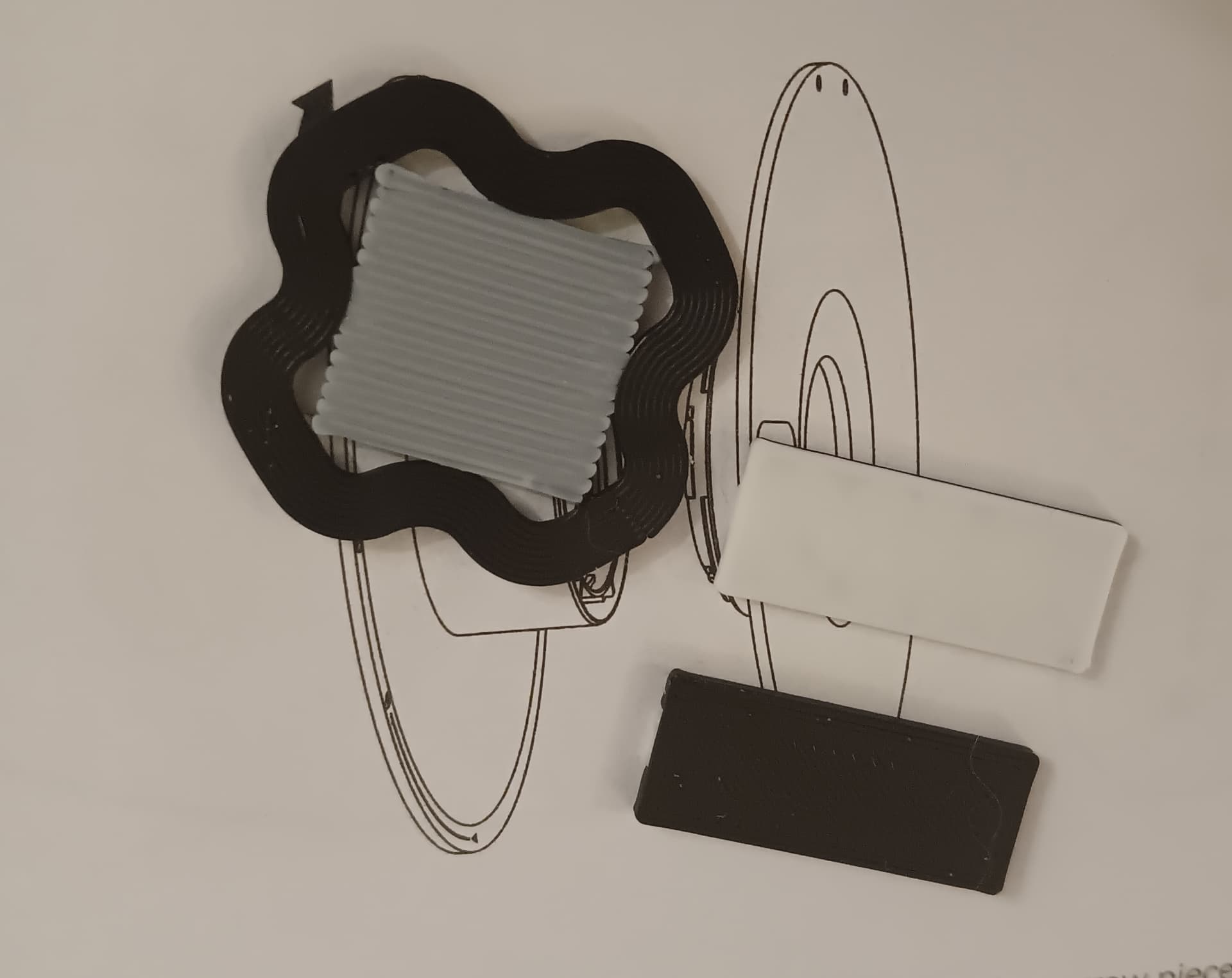

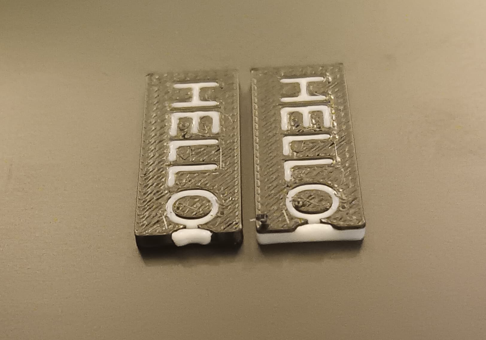

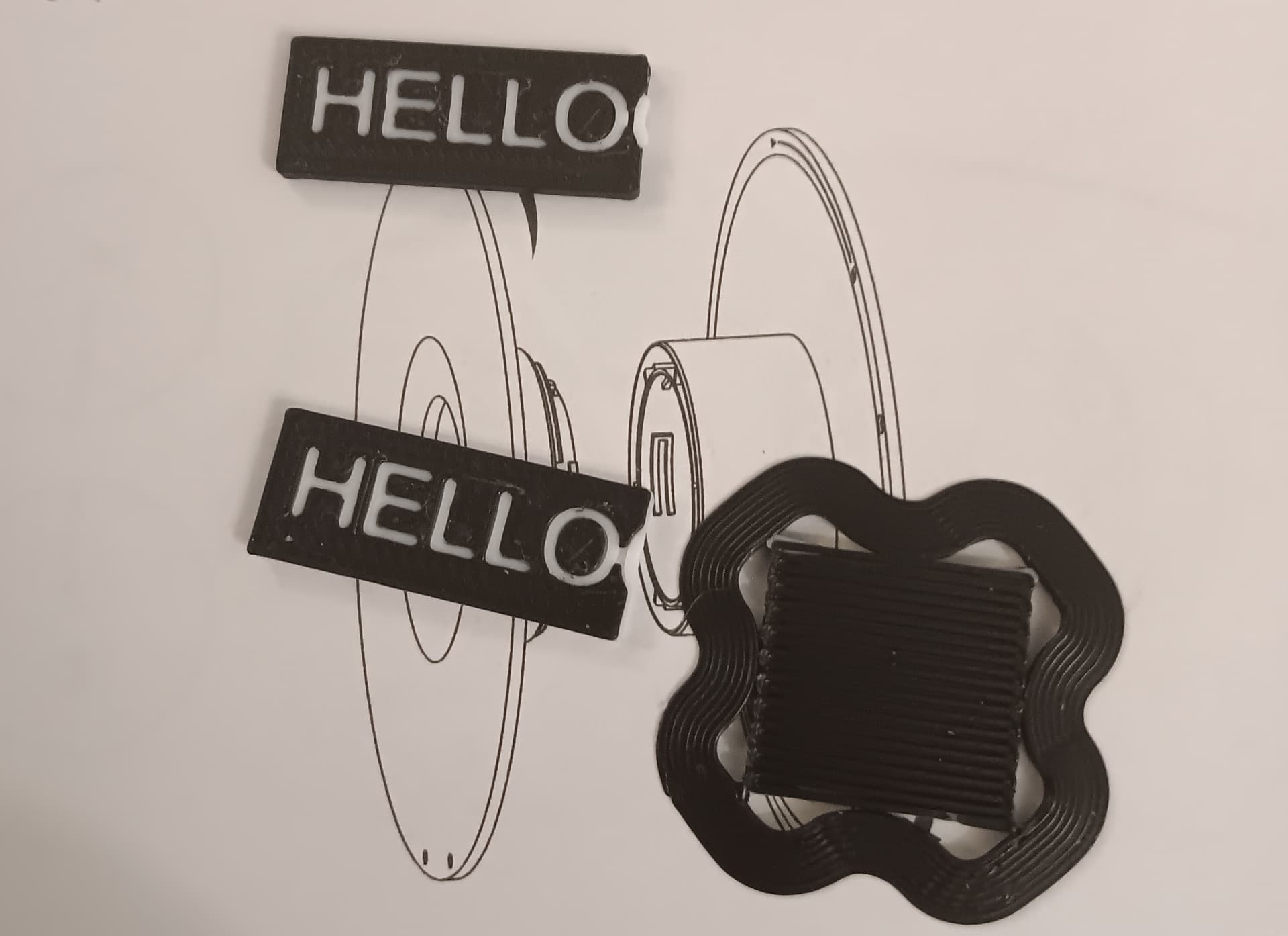

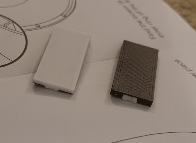

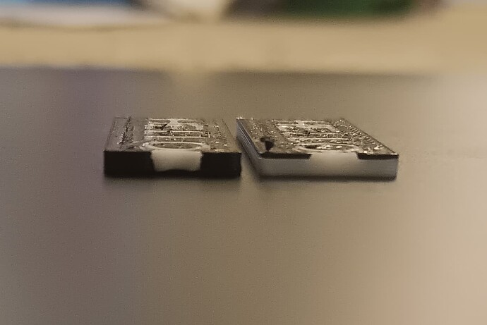

The little test file is actually an interesting experiment in its own right. I was looking at two different ways of putting white text on a black surface like a user did on a box I created ( Vectrex Superbox by gtoal MakerWorld: Download Free 3D Models ) - the first test part was made the traditional way with an all-black surface with 3 or 4 layers of white text embedded at the top of the surface. The second one was an all-white piece with a single layer of black on top with the complement of the text. This version turned out to be better since the white text was white all the way through and was not darkened by having a black substrate beneath it, and has the major advantage of only one layer requiring filament switching rather than the 4 layers with both colours that the embedded white on black text version required. The only downside of this negative mask technique is that the sides of any objects with white text on a black surface will also be in white, but for the items I’m making, that’s OK.
