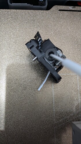

I had a strange extruder jam today, the filament had a outgrowth but the filament was NOT flat, I was not able to determine where that came from, probably make by the gears but also probably due to something inside the filament.
Just wanted to share this one, to show that any extruder jam can be easily corrected on Bambulab by unassembling the extruder.
Fully unassembled extruder :
The strange outgrowth that was blocking it in both directions :
There simply cut the filament and remove it.

I removed the extruder and this is what I see: When I understand correctly, there is no clog at least not around the wheels. I can push, but if I pull, it jams in the middle.

Since I was able to move the filament up and down and even turn it around, I just figured the end must be to thick to go through the hole. And this was the case. Look at picture:
After I cut it I was able to pull the filament out. There was no other clog. After putting it back together I started to load the filament again, but the noise from before was still there and the filament did not extrude from the nozzel. I was able to unload it though.
