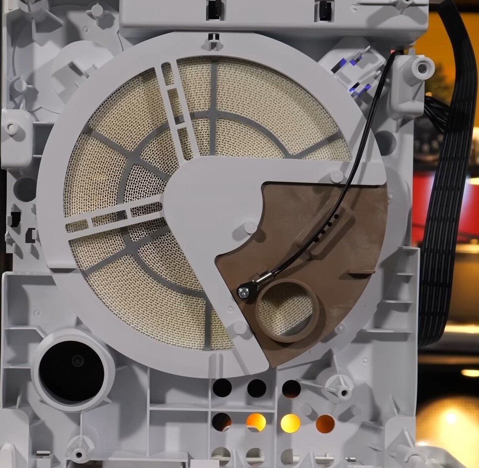

This is cool and they have a section explaining what I was getting at with separating regeneration from drying:
“As the desiccant wheel rotates, stationary seals divide it into 3 distinct sections: Drying, Regeneration and Cooling. This continuous process ensures that dry desiccant is always available,”
The separation of those regions is important or else you can have moisture work its way to the dry side decreasing effectiveness.

Heres the inside of one of those if you are interested.
Its actually kinda neat.

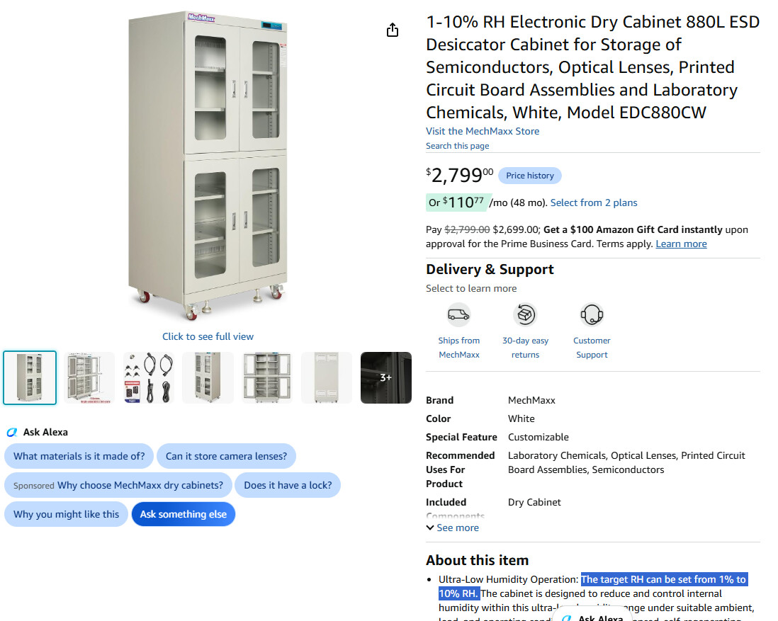

Amazon sells some that really mean business:
This is the pure dream machine, where you can (allegedly) dial the internal RH all the way down to 1% if you want to. And with all that space, if you can’t fit all your filament in, then you have too much filament. Seemingly pure set and forget, with its own automatic regeneration.
You know, compared to a kitchen remodel, it’s cheap!
I haven’t had a chance to verify the claims, but he’s claiming this filament fridge uses molecular sieves and self-regenerates:
at what he claims is a very low overall energy budget.
