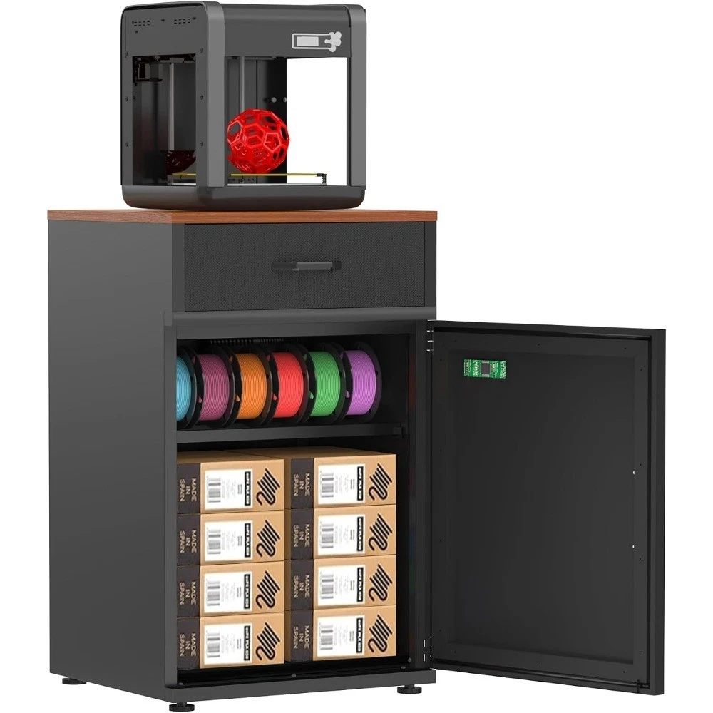

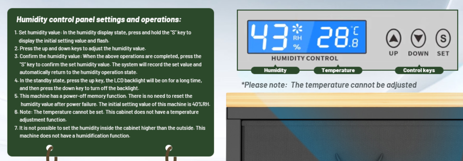

“180L 3D Printer Filament Storage Cabinet with Dehumidifier, Sealed Metal Cabinet” < Kinda answers the materials question. Of course, Aluminum foil qualifies as all metal, too. :thinking: If it doesn’t have an external Hydrometer, I’m perfectly capable of ramifying that. In fact, I’d like to.
But in one of the pictures of the interior, there is some form of printed circuit board on the door. Might be a hygormeter. What do you think? s-l1600.webp (1000×1000)

Since I took a close look at the cabinet - or rather, the electronics - maybe this will shed some light on the matter.
  • …and no, user_3353630899, this comment isn’t written specifically for you - before you start acting like a grumpy again - but for people who are interested.

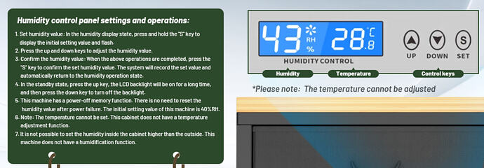

The circuit board on the front is a humidity sensor. It’s not used to set the temperature, but rather to determine the humidity level at which the heater should be turned on via an external trigger.
So it consists of a humidity sensor that controls a trigger output when the humidity gets too high. This signal is then sent to the heater, turning it on and off.
However, it doesn’t have the standard features of, say, a filament dryer: You can’t set a timer. Nor can you set a temperature.

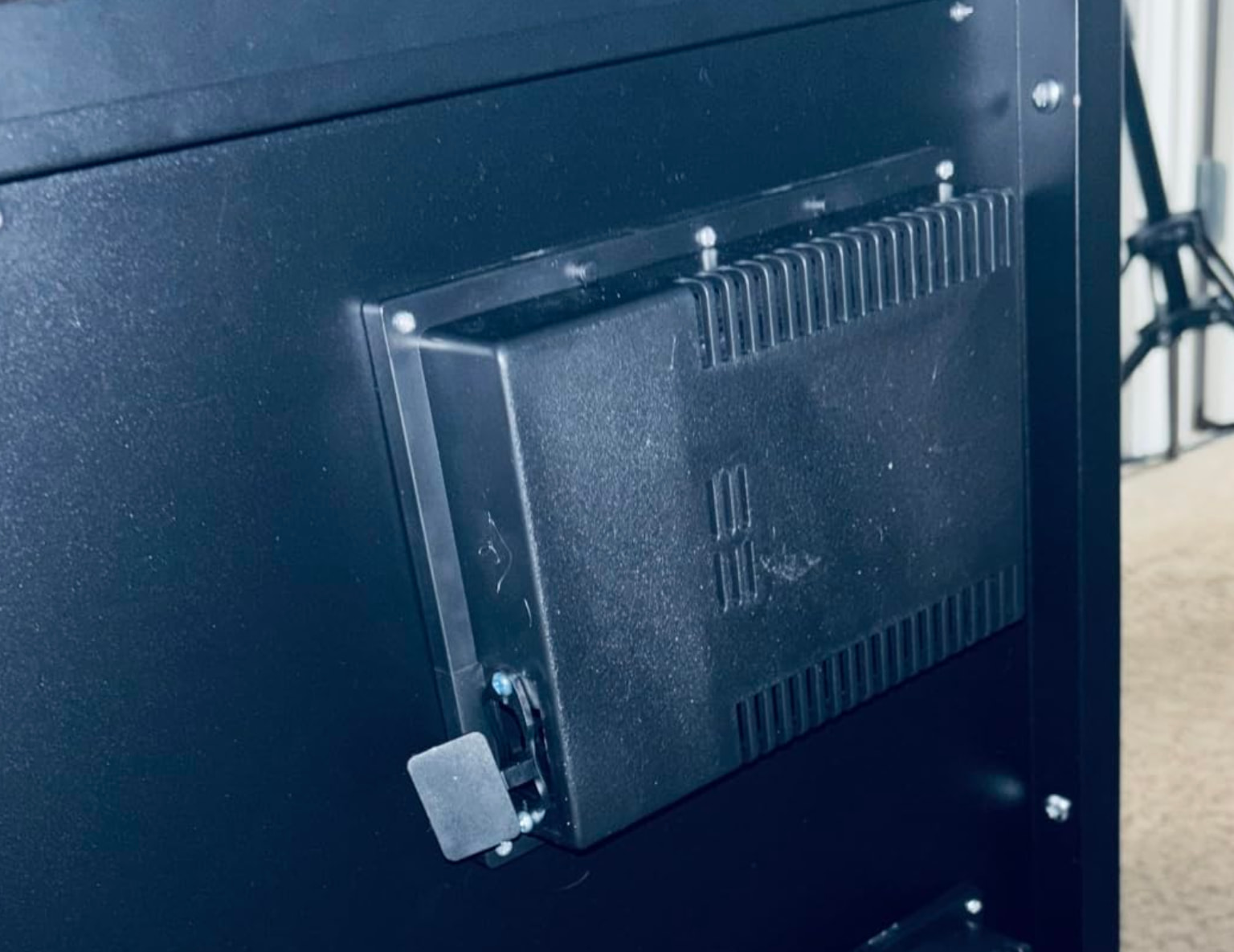

It simply activates a relay that turns the heater on or off. This is the built-in heater that is triggered:
As a side note: There are no fans installed, which of course makes it difficult to circulate the air in such a large space.
So it’s not a dehumidifier in the traditional sense, but rather a way to heat the cabinet.
More than a heater, though. This is that rotisserie I was referring to. It looks like there is some sort of container being rotated above a heater. There’s at least two ways to regenerate like this - pressure swing and temperature swing. This is using temperature swing. Heat the desiccant to drive off water, then let it cool so it picks water back up again.
It does use a heater but the heating looks mostly confined to the regenerator and is intended to just regenerate beads without raising temperatures in the cabinet much. At least it doesn’t look like a design goal to heat the cabinet. But I think a circulation fan would make sense too.

…and most importantly, the heater should be under the cabinet, not at the highest point.
You are just transfering moisture. Most of it will go into the surrounding room, some of it will go back into the case. The system is relying on heat differentials to move the air, which is much less efficient than using active air circulation.
More importantly is determining if the system being used is sized correctly for the cabinet for it to have any real effectiveness. Which my gut says it is undersized, but that is just a guess since there is little to no technical information in the Ebay listing.

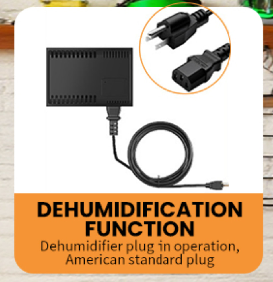

Edit: I just wanted to double check this listing to make sure I didn’t miss anything. Its going to be hard to make a call on anything given the lack of information. I was looking for information on power draw since that is a good judge for how powerful the system is, but of course no luck.
Ah - this goes back to a conversation @NeverDie and others had about drying filament or beads in a room - how much does it change the room humidity.
First, though, it looks like that regenerator sticks out the back of the cabinet as well as sticks in the cabinet with the desiccant rotisserie kind of right on the border. I think it might rely on convection to do the circulation. As desiccant rotates to the outside it gets heated and the heating generates an air current on the outside that helps sweep away liberated moisture. As the desiccant rotates back into the cabinet it cools and so can pick up more water to repeat the cycle. But inside the cabinet air would be maybe a little more stagnant which is why I agree on a circulating fan for inside.
There is desiccant involved. Molecular sieves is what they advertise. And it just moves into and out of the cabinet carrying and releasing water. The liberated water is released to the room.

They are calling it a desiccant rotor, but I am not even seeing a way for it to rotate.
I am assuming that is a translation error or the graphics are not accurate. (I am leaning towards translation errors)
I bet it’s a rotor. They call it a rotor and show red and blue arrows on the graphic implying rotation.
But the biggest reason to accepting it’s a rotor is that is absolutely a way to do temperature cycling of the desiccant that causes the water pumping behavior to happen.
You can use reversible adsorbents in pressure cycling or temperature cycling strategies (or combine them) to pump or remove water and other materials. It’s done in industry all the time.
If that dryer/regenerator works, it’s doing temperature cycling and would have to rotate to do it since there’s no switchable ducting visible to cycle air through stationary desiccant. Plus little 120V pancake motors are a dime a dozen. They are fairly small. And not being called out explicitly in the diagram makes sense. While an active component, all a motor would do is rotate the desiccant. They might not even want to go into that detail.
But like I say, if it actually works, it has to have some way to rotate desiccant inside and out. May not be a motor. Could be a solenoid with a crank to flip it back and forth, etc. Without ducting and valves to route air back and forth, it has to physically move desiccant into and out of heat and the cabinet. It has to.
