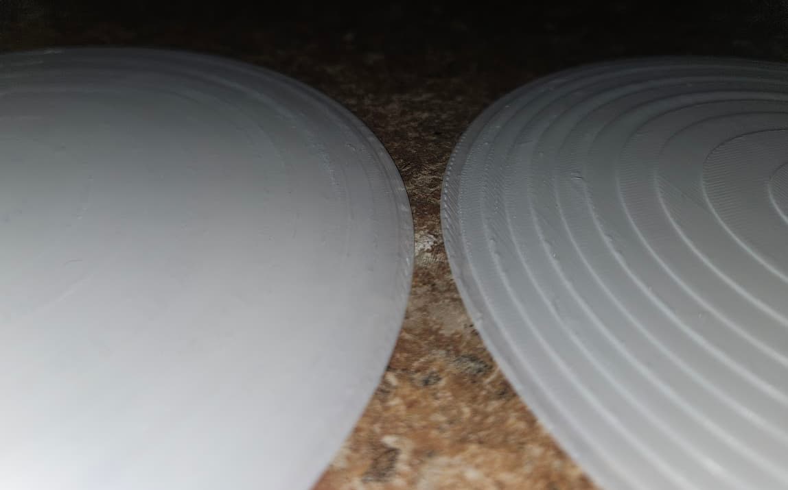

Created a part for this test with the approx. dia shown below on a dashed-line 250mm square for ref of approx. size on print bed of P1P in 1st image below. Height ended up being something like 11 or 12 layers @ 0.28mm each layer height with 0.4mm nozzle, 2nd image below shows side profile with that 250mm square (as viewed from top) with a dashed line.
The end result using ZAA and ironing enabled produces the shape shown in the 2nd image below, no sheet, ref 3rd image showing end result ZAA + ironing enabled part on left side with same part printed without ZAA enabled for comparison on the right.
I lean towards mechanically-inclined printing and do not normally print such models - along with not sure of posting guidelines here so only included a screen cap close up as if the model was wearing clothes in the 4th image below, but ref how smooth that is too. Upper half woman model scaled up to max size capable printed in 0.28mm layer height.
I certainly hope this gets included upstream to Bambu Studio as I can only get the “Bambu Studio ZAA” linux appimage to work in Linux Mint, the Windows version fails at multiple areas.

I wouldn’t expect ironing to make any difference to this. As I understand it, the ironing function will only be enabled on surfaces perpendicular to the axis of the print head.

me either but test show ironing enabled produced a better quality print in the end, no fuss or clean up afterwards, it came off the print bed in better shape than just ZAA enabled without ironing. That left a bunch of artifacts all over the place. Ironing enabled did not. YMMV
