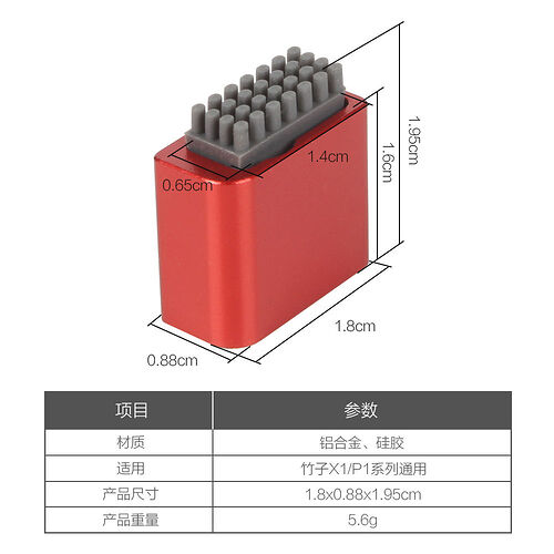

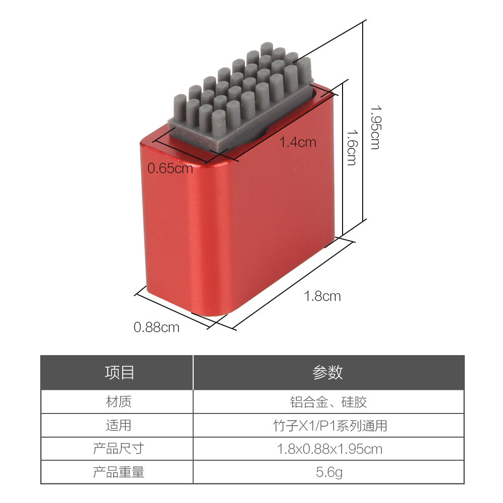

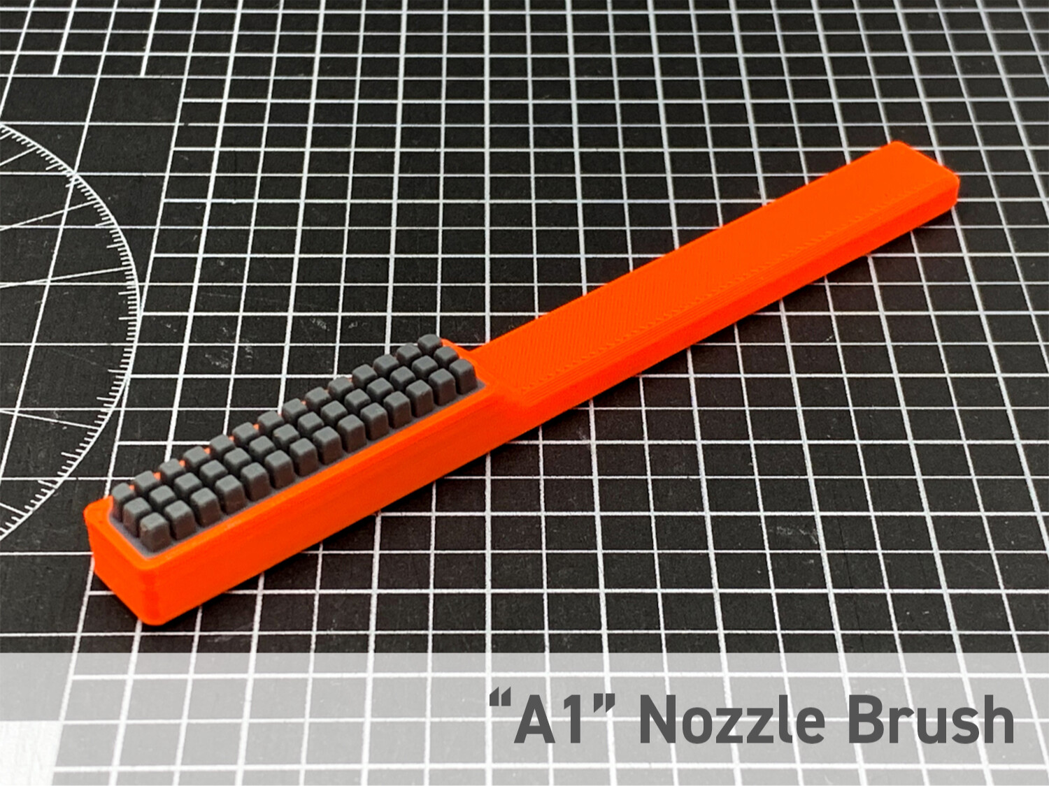

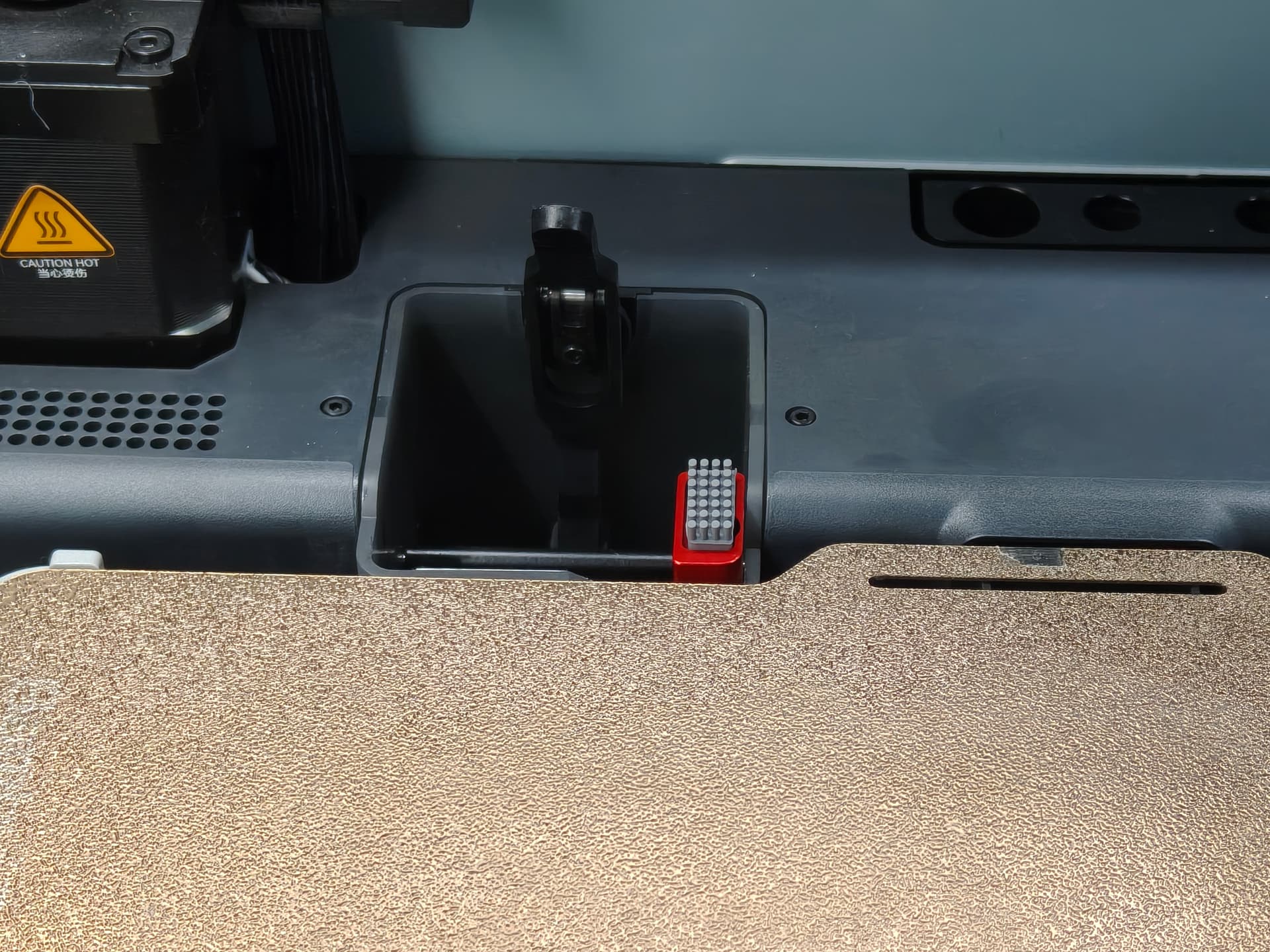

I had the same problem on my x1c, the pftg tube wiper is a bad idea, sometimes the nozzle even throw the poop on the plate and ruin everything. I tried to find mods on makerworld but no perfect solution.
Then i realized that i don’t have to use 3d print to solve problems in 3d print. : ) Anyway there is a very good alternative I’ve been using
Not sure if it is available outside China, here it only costs 6 RMB and comes with 2 backup brushes
It cleans the nozzle rather well, the worst case is the fiber gets stuck in the brush but never brought to the plate, so I’m okay with it
