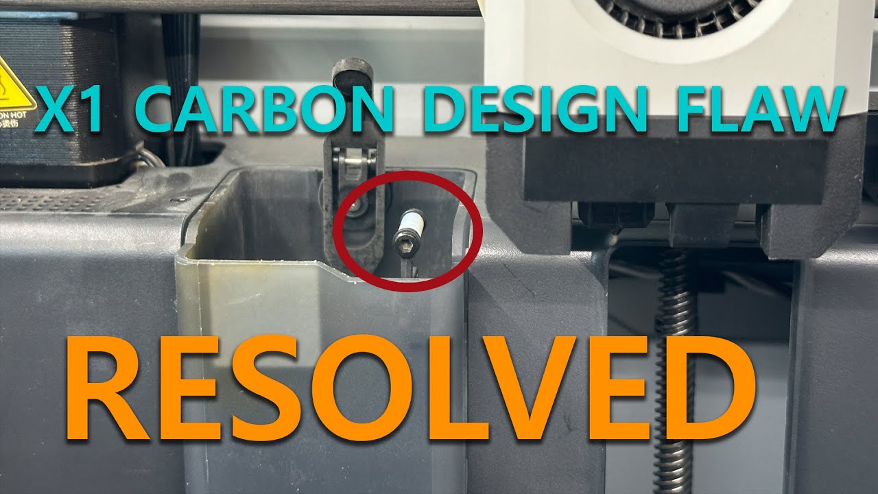

Any truly good solutions for PETG getting stuck to nozzle?
It seems to be a “known problem” of the X1C nozzle wiper having problems wiping PETG, and even pressing it up against the nozzle where it gets stuck, accumulates, and eventually may start ruining your prints. Very frustrating! Hence, probably why the A1 was a different wiper design…
Anyone yet found a worthwhile solution or strategy for dealing with this? Maybe the slice engineering nozzle paint? A better fitting silicon sock? Anything?
I’ve seen the NeedItMakeVideo, but it didn’t look like he had much success. And, of course, there is all kinds of downloadable junk, which is… mostly junk. But maybe there’s a diamond in there that I’ve overlooked?
Presently I’m using a silicon glue brush to manually brush off PETG accumulation after heating up the nozzle. It gets the big chunks off, but there’s always residual, which acts like a primer to immediately restart the accumulation process. Changing nozzles is radical, but it works (for a while at least) because it delivers a clean start.
If anything drives me to a non-stock nozzle ecosystem, this may be it.

I got tired of the stock nozzle wiper, so I picked up a few of these:
No more clinging filament! :wink:
Which size is the right fit for an X1C? small, medium, large, or extra-large?
All three will fit; it’s just a matter of how much they come into contact with the nozzle tip. I use the medium setting, and it works well for me.
It looks notionally similar to The Ultimate Wiper version 2, built and reviewed here:
However, at least with that design, he showed that it would fling bits of poo all over the build plate. Can you confirm whether or not that also happens with the wiper you posted your link to?

You might occasionally get a small piece of debris flicked from the nozzle, but I haven’t had any prints fail because of it landing on the build plate. That said, it’s possible—if the debris lands in just the right spot, it could cause an issue.
However, I prefer it being flicked off rather than sticking to the nozzle and being dragged around during the print, which tends to cause more problems in my experience.
You can also experiment with the X-Large setting, which covers more of the nozzle, or the Small setting, which only touches the outer tip of the nozzle. That said, I haven’t had any prints fail since installing this—quite the opposite. With the original setup, debris would sometimes stick to the nozzle, get dragged onto the plate, and ruin the print. This adjustment has made a noticeable improvement.

I use this Scrubbler V2 Nozzle Wiper REMIX - Fix Height P1S Remixed by br1acc - MakerWorld and this Anti-splash cover BambuLab for nozzle wiper Remixed by Mariusz - MakerWorld
I use a utility knive cut a part of the silicone brush holder so that it won’t interfere with the build plate, not this particular one in the picture but a different aliexpress build plate.
Gone through about 15 rolls of PETG recently. There still a small piece trapped between the teflon tube and the silicone brush sometime, but generally this setup keeps the poops inside the chute like 98 out of 100 times, while stock wiper just flings the poops all over the bed or under the bed like 99 times out of 100 times.
