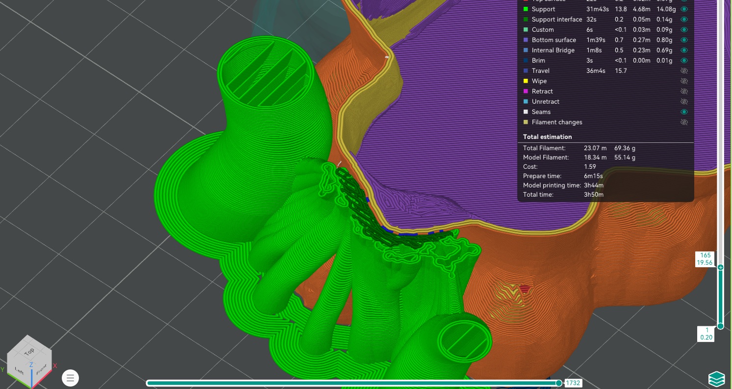

I have been having issues with tree supports snapping in the middle of a print. I have already changed the infil of the model to gyroid as to not have criss cross lines but the issue persists.
I see that I am unable to increase the wall loops above 2 and the option “base pattern” doesn’t seem to work on tree supports.
Does anyone have any idea as how to fix this issue? I have added a picture of the latest failure as context.

Dry your filament.
Wet filament over-extrudes and gets stringy. That causes excess filament to build up on the end of the extruder. When it gest big enough, that excess eventually gets randomly deposited on the top layer of whatever is being printed, where it cools in to a lump that is higher than the current layer height. So when the printhead comes around to that spot on the next layer it hits the blob. If whatever gets hit is solidly attached to the build plate, and strong enough, the nozzle rides over the lump and printing continues. If what it hits isn’t solidly attached to the build plate, it gets knocked over. If it’s not strong enough, it gets broken in half.
You don’t need stronger supports. You need to tune up your filament to eliminate the cause of the supports getting busted. :slight_smile:

You can make tree supports stronger by increasing Support Wall Loops. I had failed prints due to tree supports with eggshell thin walls. Upping the wall loops from 1 to 2 made the supports much more rigid and reliable, but at the expense of some filament.
