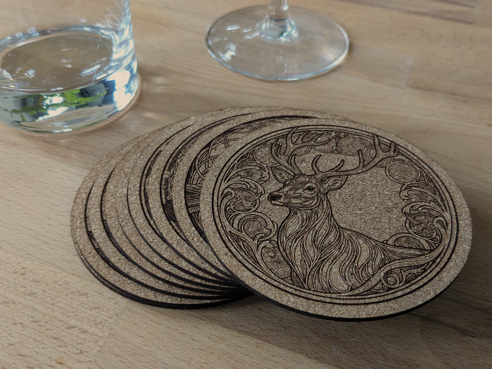

I have the 40W version and the air purifier arrived, so I finally got to to test the laser yesterday. The Bambu Suite software is easy to use and has some really powerful features, once you get familiar with it. Rather than do a demo project, my first cuts were my own designs. I designed a set of nature-themed art nouveau drink coasters. They came out fantastic, I am really happy with the laser overall, can’t recommend it enough, for people who only cut occasionally!
If you are interested in the coasters, I just put the project on maker world here.
