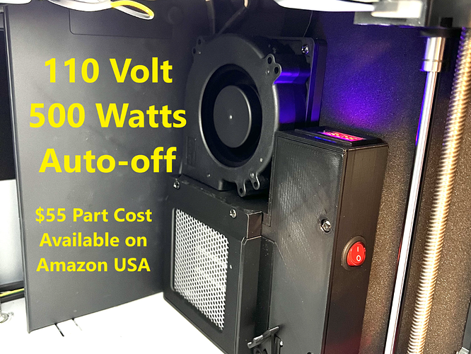

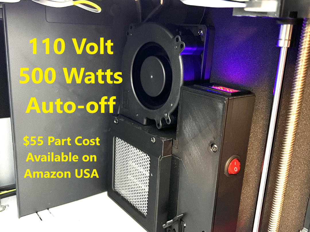

Dragon61
I made this one for around $60 in parts. Works great
There are clear instructions and a video
