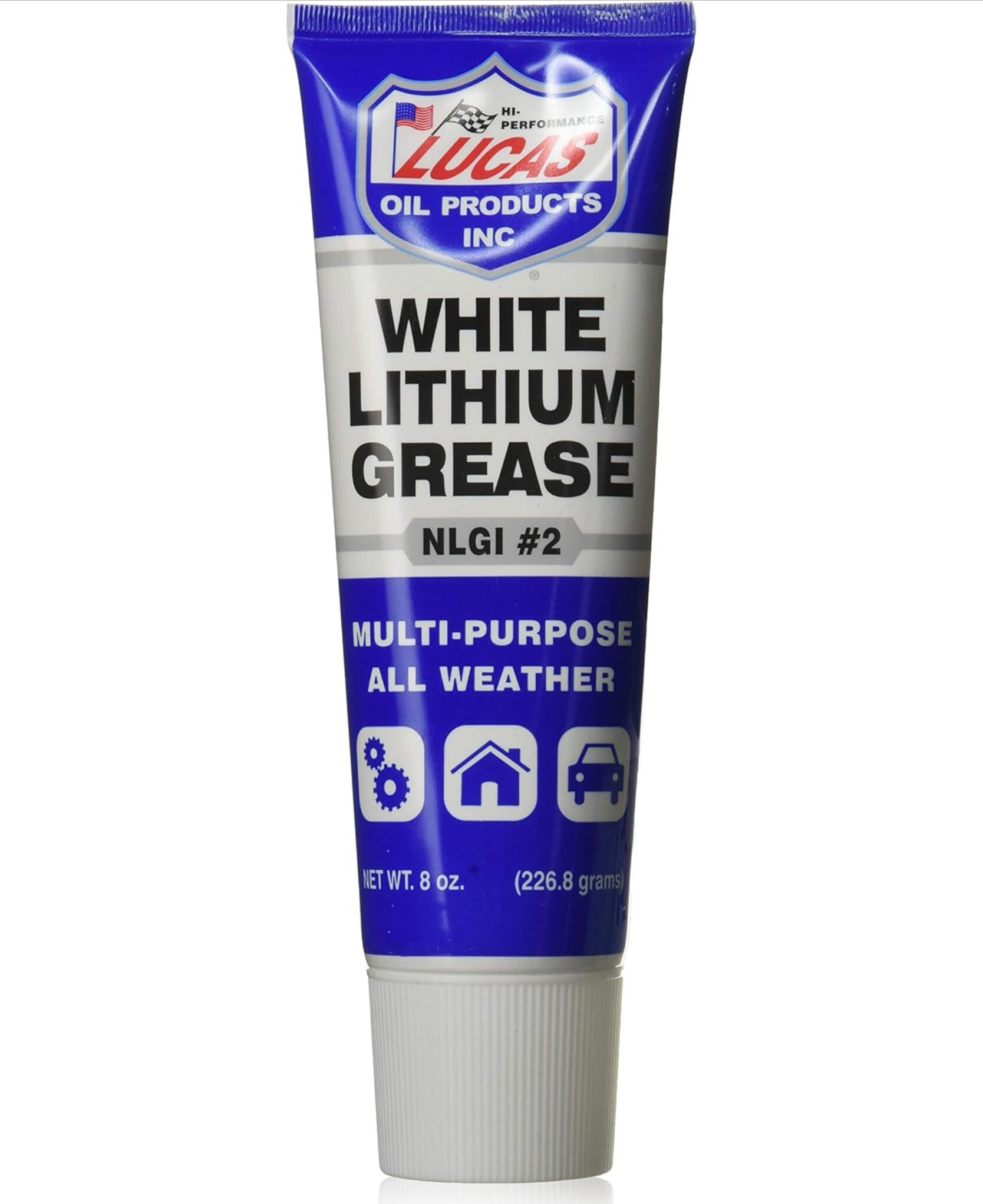

Anyone in the U.K. found Lucas Oil 10533 White Lithium Grease
I need some lube for my P1S printers, weirdly, BL don’t supply it and offer less than helpful suggestions.
I ordered some of this Lucas Oil 10533 White Lithium Grease from Amazon and it has t shown up, the company issued me a refund, but, I want some grease.
Do any of the Brits know a place to purchase it that might actually get to me or something equivalent?
Foreign help on recommendations for alternatives are also welcomed,
White lithium grease is a pretty generic product - brand names don’t really matter. Here in the U.S it is available everywhere that sells hardware or automotive supplies.
I prefer to use a silicone grease called Sil-Glyde. The oil in white lithium can separate and run. Sil-Glyde does not separate or run off at temperatures up to 205°C, is waterproof, will not harm paint, plastics, or rubber. I use on disc brakes, hinges, door seals, CV boots, anywhere a dab of light grease is needed. It’s a bit more expensive, but a 4 ounce tube lasts me for years. Works great on z-axis lead screws, too!
Not sure you need grease. I use this 151 Silicone Lubricating Spray 200ml (again from Amazon, or elsewhere). For rods in the printer, spray onto a cloth, then rub on. You only need a smidgeon.
Thing is, grease attracts and retains filament residues, like particles and dust. I’ve been using grease too, but I’m considering alternatives.
If the parts are clean, and grease free, then maybe graphite powder. It is sold for lubricating locks.
