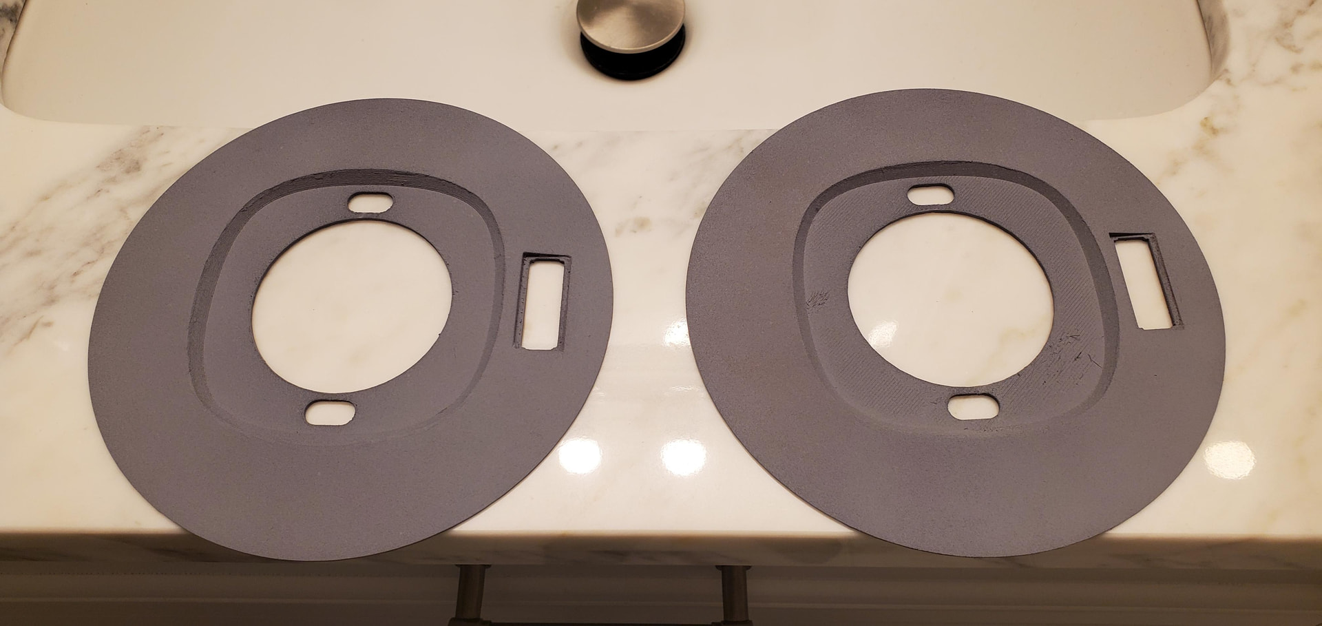

Spent time researching which paints to use on PETG. Google Ai assured me after much back and forth I needed Testors enamel paints. Thought after of double checking b/c Google AI has been giving me a lot of false info lately. Sure enough Claude searched the web and said they will not work.
So much for AI. Now…can anyone tell me what they have successfully painted small highlights on PETG with? the details are too smal to sand/prep etc. They won’t be handled. Some people say enamel sticks. Some people say acrylic (but not water based and Testors are oil based acrylic).
I saw one site say Revell enamels work. But if them, why not Testors enamel ones?
