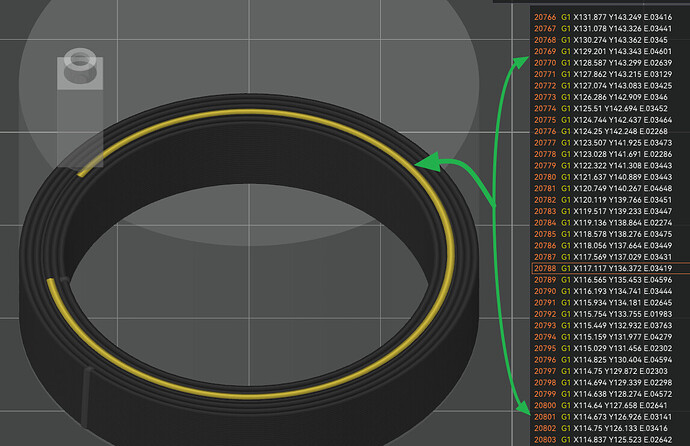

In trying to diagnose why a mostly cylindrical print sounded smooth on some perimeter loops, and sounded very grunty on others, I noticed the arc fitting is only being applied to external perimeters, and even perfectly circular internal perimeters are still interpolated with G1 moves. This is true on both classic and arachne engines.
Why not fit arcs everywhere (besides slicing time)? At least give us the option so the printer runs more smoothly and more quietly. Plus, internal perimeter artifacts will print through to external perimeters.

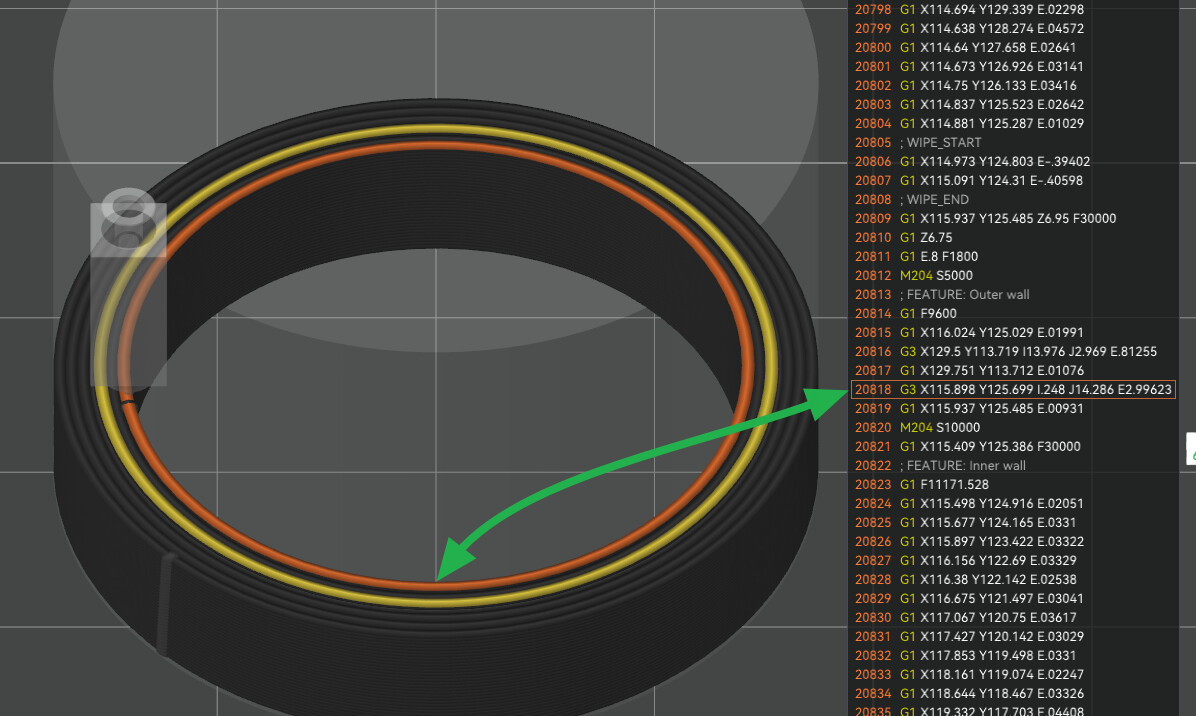

External perimeter arc:
Internal perimeter lines:

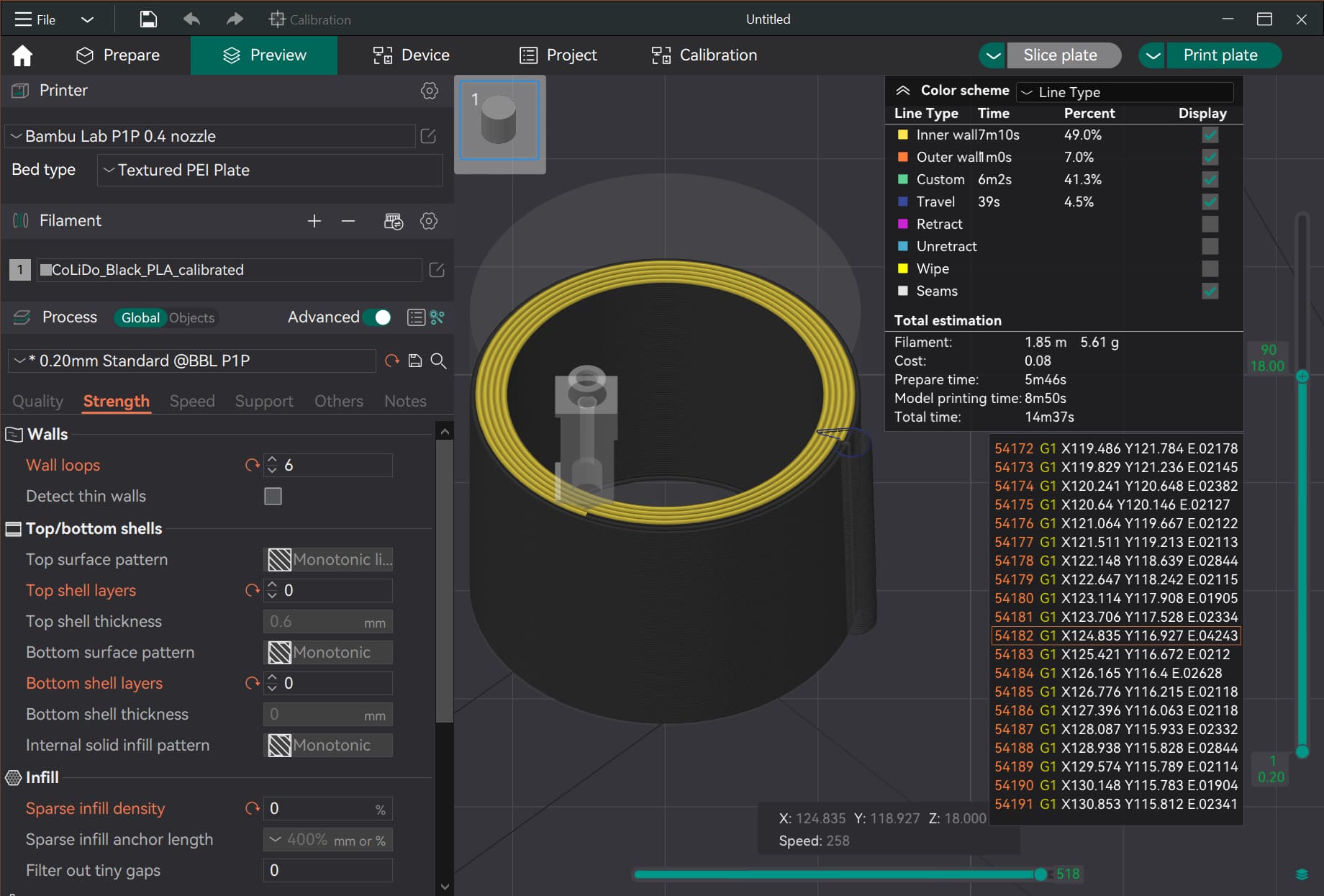

I only ask because a primitive will have native geometric calculations allowing for smoother curves and arcs. What might help is if you could show us a screen capture of the object under the simplify object menu with wireframe checked. This would display the underlying mesh and would rule out any possible glitches in the model rendering within the slicer algorithm. In the example below, this is a base cylinder primitive and you can see where the mesh is uniform as well as where the seam is.

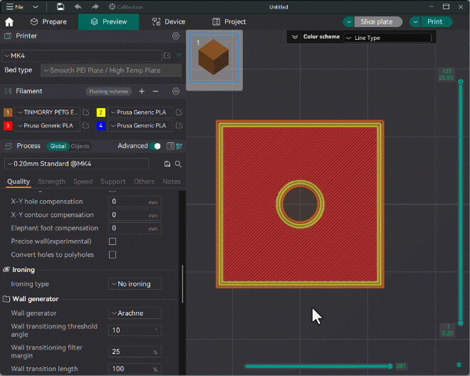

This has me intrigued. I just tried to duplicate what you did. I’m not following. Do you mind sharing the steps you created before you did this screen capture?
In the example previously, I changed the walls to 5 and bottom and top layer to 0 and infill to 0. But I’m obviously missing a step here to get to the analysis you’re trying. Admittedly, this is a new avenue of slicer understanding for me so please be patient.

It sure looks like you are demonstrating the issue from your screenshot. You have perfectly circular walls, and the gcode is all G1 (linear) print moves.
Your screengrab really highlights the mesh artifacts perfectly.
