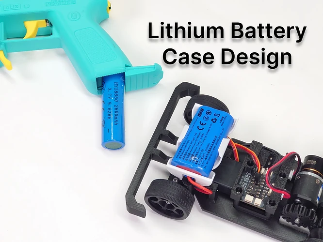

Are more powerful motors possible with Cyberbrick? Image with a question
Hi, a model shown on the Maker’s Supply account features a much more powerful motor. Does anyone here have information on how to control it, or details regarding support and implementation for such high-performance motors with Cyberbrick?
Where exactly did this picture come from?
That motor isn’t connected to the Cyberbrick either. The cyberbrick is only connected to a servo in that picture, which looks to be the steering servo under the battery.
There are ways you can connect a more powerful motor. The Cyberbrick is rated for 3.7v to 12.6v, so you should be able to dump a little more juice into it, and connect a motor that can handle it. I’m sure you can also make a little circuit that takes the output from the servo or motor port on the cyberbrick, and translate that into a much bigger motor.

Update of earlier message, I’ve managed to source a motor and gearbox of a type that matches the photo well enough for me to identify the type of motor, and believe the gearbox is real. They are still not connected to the cyberbrick though.
If the cyberbrick outputs a standard servo signal there are electronic speed controllers that take servo inputs and then control high power motors in drones and R/C cars. Any hobby shop will have them.
I’ve come across that image a few times and just had to ask around.
Yeah, that’s what I thought too—something that controls the motor via the receiver. Are there any concrete approaches to be found anywhere, perhaps in connection with Cyberbrick?

And this airboat has that ESC kind of motor control: RC airboat - Free 3D Print Model - MakerWorld
The comments on the airboat are a gold mine of information. Apparently you need a particular feature that not all ESCs have, but there are cable examples and other good information.

From what I understand, the H bridges on the receiver shield can be used to control any brushed motor. Your limiting factor is the current load, which maxes out at 3 A on the shield. So technically, you can run decently powerful motors like the 8520 2S coreless motor, but 2 of those at the same time at stall current will probably burn the board.
On the other hand, the S1-S4 servo pins are pretty ordinary signal lines and you can use those to drive brushless ESCs and similar, but at that point you need a separate power source.
