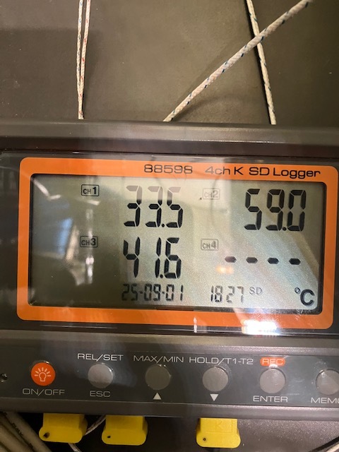

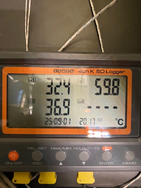

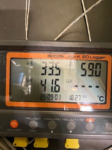

I’ll start out describing my printer layout. Fully enclosed P1S w/ AMS, thermal sensors in the top of the AMS (CH1), top center of the P1S 4” (101.6mm) (CH2) above the print bed THIS IS THE CHANNEL OF INTEREST, and one at the base of the printer (CH3) about 1” (25.4mm) off the base. I have a 2” (50.8mm) vent hose about 4FT (1.2M) long with a variable powered blower running out the window and a window Air Conditioner right next to the printer.
Test 1 was as follows:
Cheapest ASA I could find on Amazon USA…1 Kg $15.99 US dollars on sale iSANMATE brand
All standard parameters selected by Bambu printer for .4 Diameter Standard flow ASA (I get better results using Bambu ASA setting) for all ASA I use no matter what brand. External Vent fan OFF (for test) HEPA/Carbon filter used.
Test 2 was as follows:

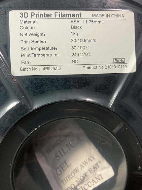

All standard parameters selected by Bambu printer for .4 Diameter Standard flow ASA (I get better results using Bambu ASA setting) for all ASA I use no matter what brand. I removed HEPA/Carbon filter and used External Vent fan ON minimum speed just enough to cause positive pressure in chamber to vent (about 1/10th of turn) on speed control (very slow). I found the built in exhaust fan inadequate for venting when running a 2” vent pipe, understandable as it was not designed to run additional vent pipe.
As you can see from both test results, there is not much difference, no heater required even with inline fan to meet the recommended 50C chamber temperature. ISANMATE specs high-end met using Bambu ASA settings, see photo of spool
