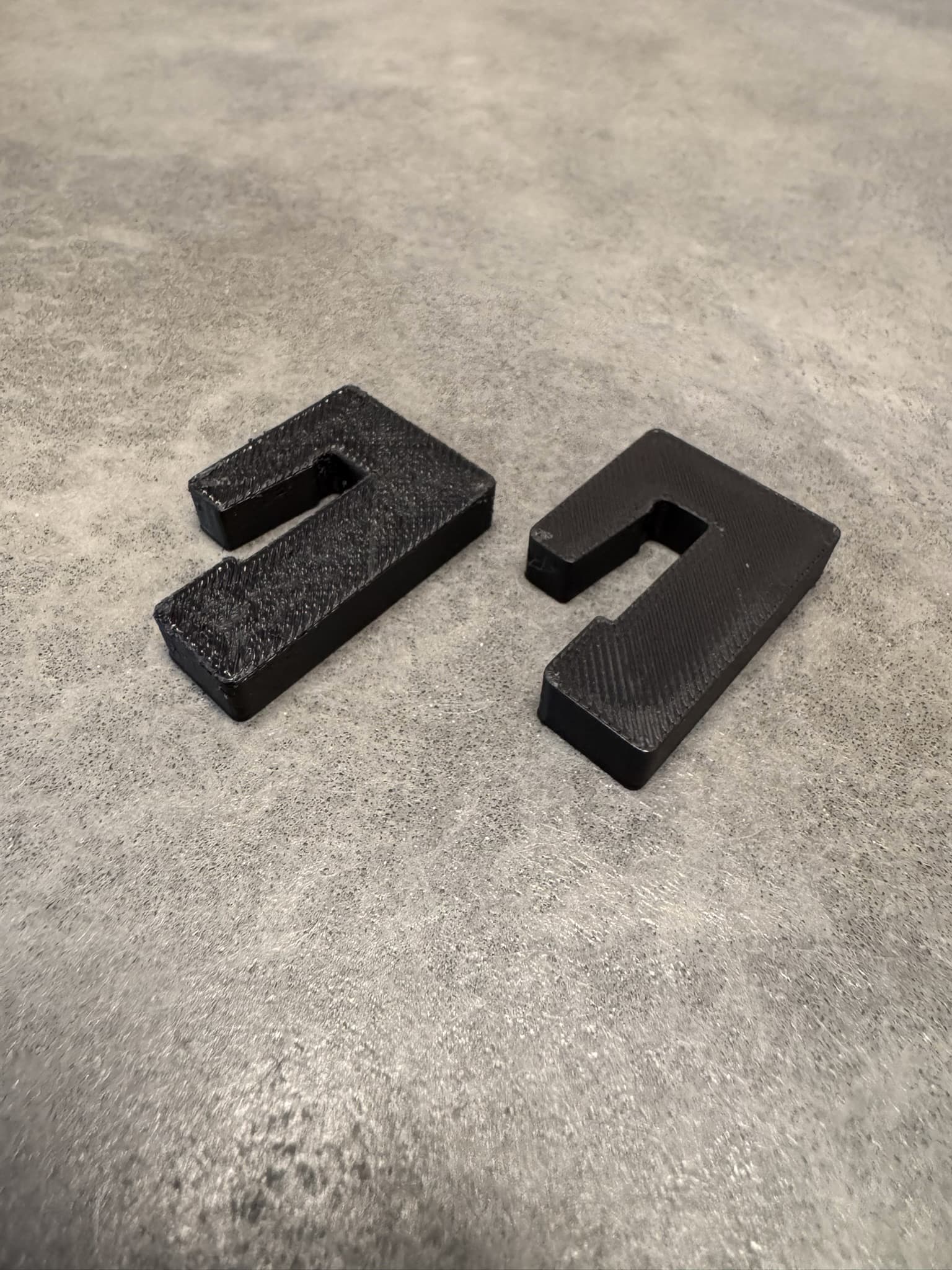

Got the H2D to help finish out a big job printing these J shaped clips - 100% solid ASA, about 1.25 x 1" x 1/4" tall- underwhelming for an H2d but hey I have plans for that thing when this job is over! I dialed the job in on my P1S and got things rolling wonderfully - 50 at a time day in and day out, great prints with no issues. I got the H2D set up and was able to use the same settings to get the same results right off the bat and things were good… till i took a couple days off. when I came back it wanted to update so I did. the next print went Ok for the First half then I started getting roughness in the tops surface similar to what is described in as over extruding, and a tapering in the vertical walls.
I’ve tried slowing things down more, playing with temps, flow calibration to no avail. any ideas would be greatly appreciated. I’m using Polylite ASA, 60C chamber temp 100C bed temp. speeds are about 120, with inititial layers down at 50 - again these settings have worked great up till now. also of note is that the P1S got though an update with no issues…
heres a side by side of the pieces:

Show photos otherwise it’s hard to understand the defects
updated OP with side by side pics

It needs to stop blaming every imperfections to a wet filament by default. Plastic, including TPU and PETG, are not so water absorbent to the point where it causes major issues, despite what filament dryer manufacturer like to claim. Sure, it affects surface finish and may look unsightly in some cases, but not in the case of severe over-extrusion (as it at least appears to be from that picture).

@Dr_Cemento However, the 100% infill is a setting that needs to be “earned”. I’m not sure the H2D profile is set up to do that well. I would try to run a few test prints to pin down a perfect flow rate. 100% infill leaves ZERO room for missed flow ratio settings if you are looking for perfect prints. If you prefer not to run a series of flow rate tests, try lowering the infill to 90%. Probably still overkill, but should leave some wiggle room for inaccuracies in the flow. Another option is tons of walls. Something like 50 walls should fill it out fully and that generally isn’t as sensitive to flow ratio as 100% infill.
Overall, I thinking your flow ratio is just a little too high, and 100% infill really penalizes over extrusion if quality is a concern.

Ok - on the prepare page I edited the project filament profile and tried again… brought the flow rate down to .80 from .95 and brought the min. temp up to 260 from 240, and… solved. may play with it even more but its at least as good as before.
